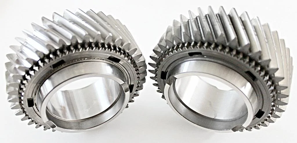

This is 2nd gear from a 2015 Gt with 9K on it.

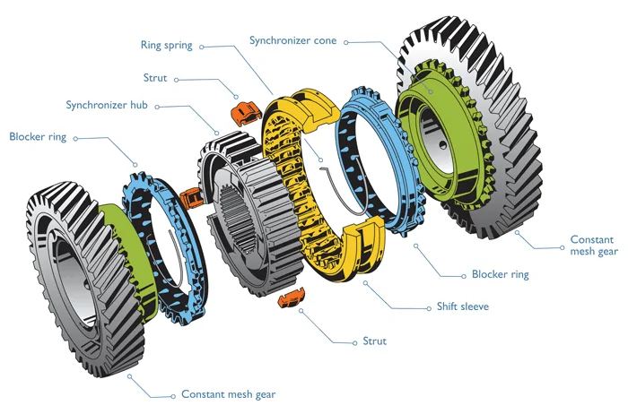

Is this 2nd gear, or the 2nd gear sync?
This is the actual 2nd gear.Is this 2nd gear, or the 2nd gear sync?
what's the big gear behind the smaller gear with the bad teeth? The smaller gear looks way too thin to be doing any real power transferThis is the actual 2nd gear.
The small teeth are called engagement teeth. The larger teeth mesh with the cluster gear and transfer power through the unit. When you are grinding gears or it pops out of gear, its the small teeth taking all the abuse. I've seen gears in other model transmissions take an absolute beating and the teeth don't look anywhere near this damaged. The good news is, we are developing a high performance replacement gear for it that will hold up better to abuse.what's the big gear behind the smaller gear with the bad teeth? The smaller gear looks way too thin to be doing any real power transfer
is this is a different part than what is referred to as the synchronizer cone?The small teeth are called engagement teeth. The larger teeth mesh with the cluster gear and transfer power through the unit. When you are grinding gears or it pops out of gear, its the small teeth taking all the abuse. I've seen gears in other model transmissions take an absolute beating and the teeth don't look anywhere near this damaged. The good news is, we are developing a high performance replacement gear for it that will hold up better to abuse.
Same thing but on the MT82, its a 1 piece gear that includes the constant mesh and synchronizer cone incorporated together.is this is a different part than what is referred to as the synchronizer cone?
http://www.gboxweb.com/synchronizer.html
your photo would explain why some people complain about their MT82. At least when its not cold weather / gear oil related. I haven't spent any time on the Challenger / Camaro forums. Do you know if the Tremec syncros can take more abuse? Plenty of people are happy with the MT82, but that may be because they are skilled with manual transmissions. And have been the only driver. If they hand over their keys to the friendly neighborhood mechanic or their teenage boy, there may be different results.Same thing but on the MT82, its a 1 piece gear that includes the constant mesh and synchronizer cone incorporated together.
The damage to the 2nd gear is from a few things.your photo would explain why some people complain about their MT82. At least when its not cold weather / gear oil related. I haven't spent any time on the Challenger / Camaro forums. Do you know if the Tremec syncros can take more abuse? Plenty of people are happy with the MT82, but that may be because they are skilled with manual transmissions. And have been the only driver. If they hand over their keys to the friendly neighborhood mechanic or their teenage boy, there may be different results.
this is a lot of stuff to fix. Almost makes me wish I got an Auto :headbonk:The damage to the 2nd gear is from a few things.
Problem #1 can be resolved with a mounted shifter like MGW or through a bracket from Blowfish.
Problem #2 can be resolved with a replacement 2nd gear which we are working on.
Problem #3 can be resolved with a better clutch and higher flow supply line.
Problem #4 can be resolved with a carbon fiber/bronze sintered hybrid ring like Tremec now offers as a replacement for the TR6060, which we are also working on.
