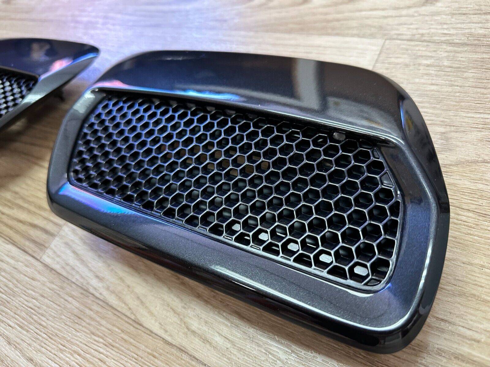

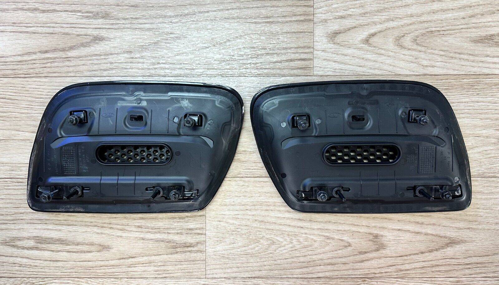

The rubberised backing plate (from the time on the video quoted above) is easy to get off.
The two half’s are ultrasonically (or heat) welded together sandwiching the grill between them.
If you can find a non destructive way of separating those items and being able to replace them as securely as OE, I’m all ears :like:
I have a spare set (that were white ) which I had painted black and they did the full lot - they actually look quite good :like:

I think the part he takes off at 5:20 in the video is just the hard rubber backing, not the second plastic piece that’s welded (that holds the vent mesh in place) ?

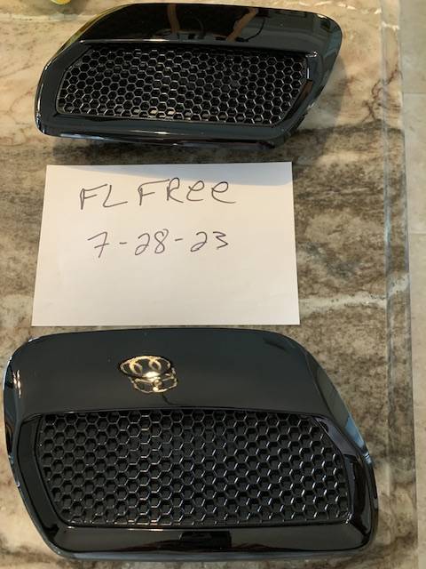

I have an OEM set in shadow black for sale in the market place section
for $80 shipped. They are off my ‘21 GT. Like new.
