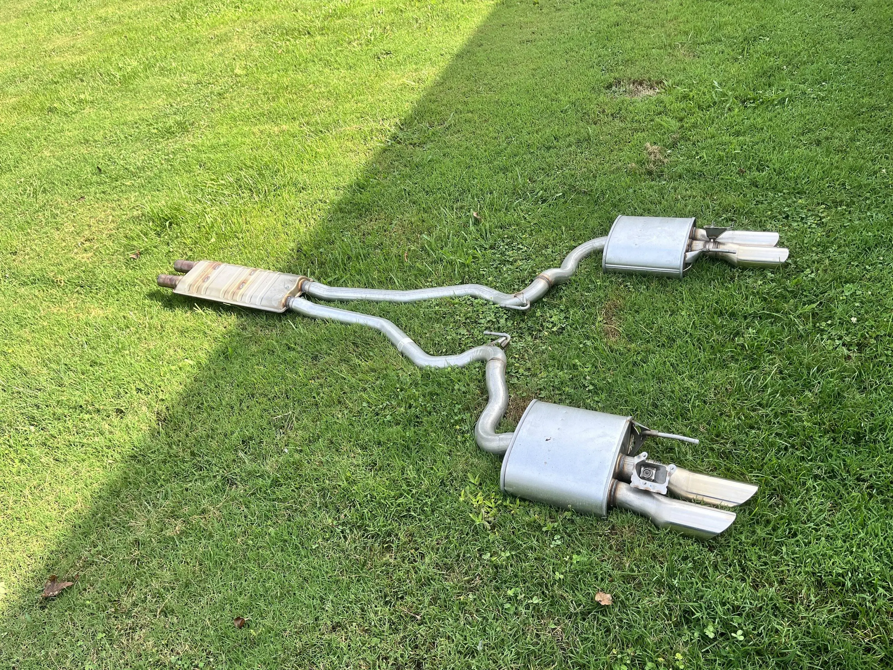

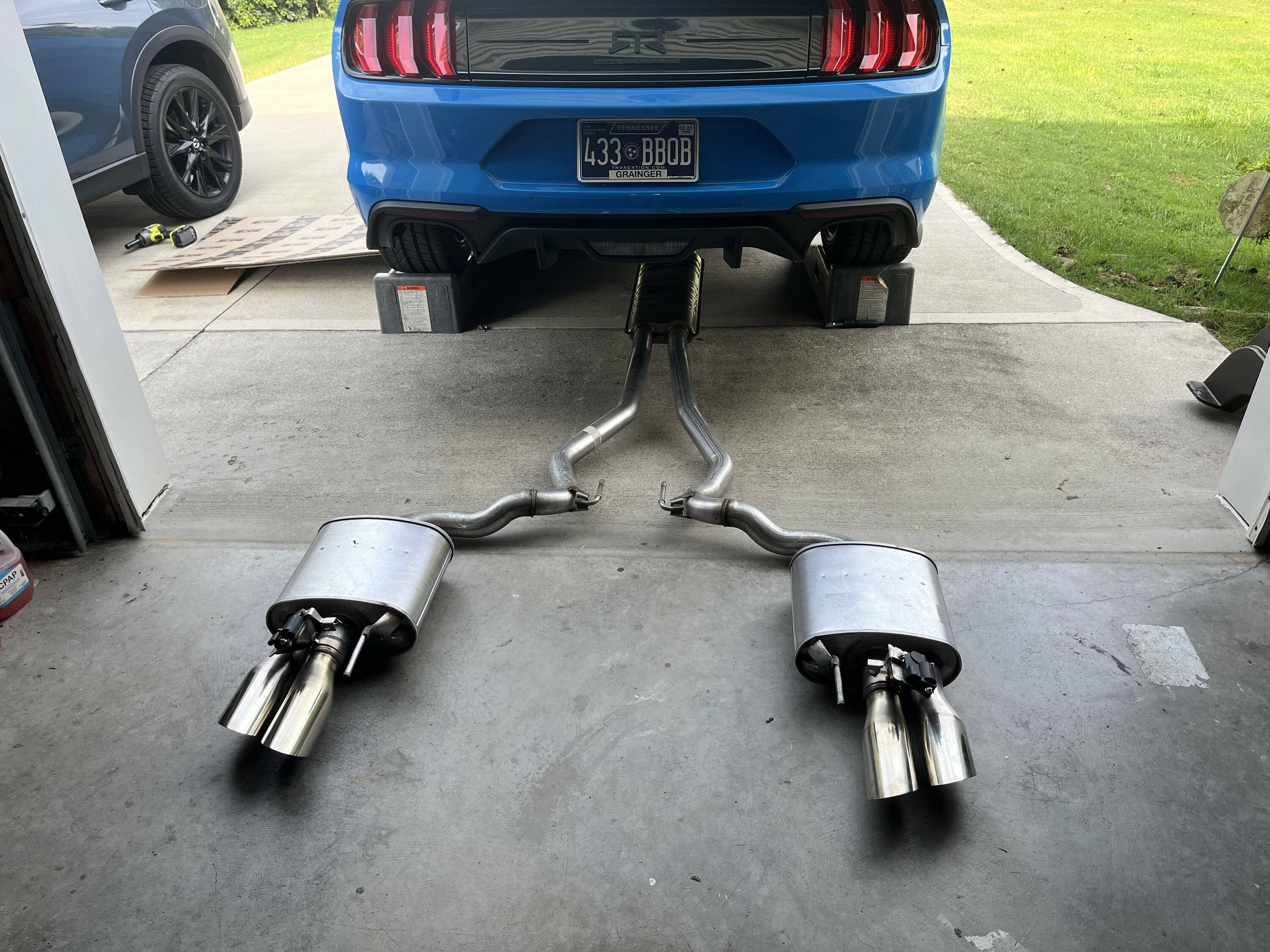

I didn't cut anything. The factory cat back is huge, 1 piece so plan on extra hands to help remove if you can. The new ones are usually at least 4 pieces so extra hands and eyes are helpful to get everything lined up when bolting together. I had to adjust mine a few times to get the tips straight. Still a little off since I did it by myself :)

As others have stated, no cutting required unless you’re removing the stock system yourself. Then you might want to cut it just past the resonator. It’s a bit big for one person to tackle, especially if you’re doing it with jack stands.

I agree, it was quite a handfull by myself on ramps and jack stands :)

Like everyone else said. It's 1 big piece. You can remove it by yourself, I did, it's just a little tricky. Not bad though.
