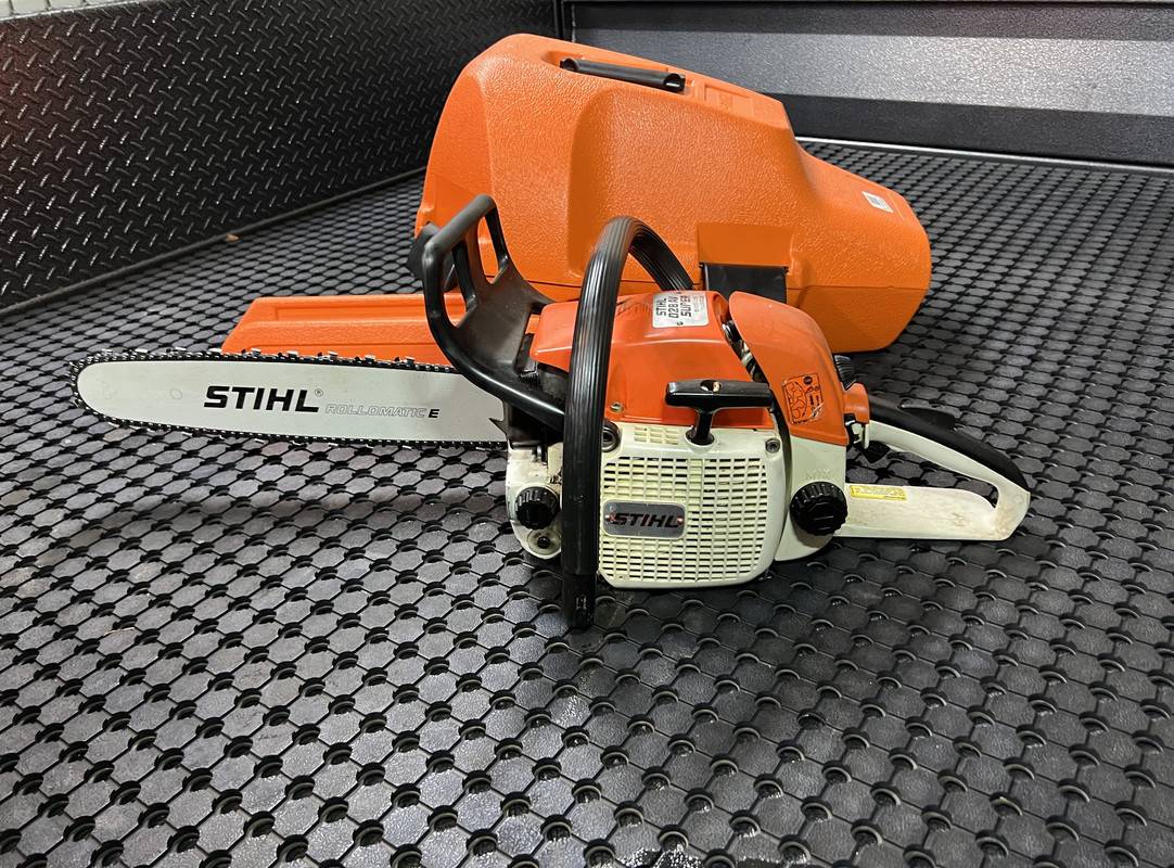

Last night, I sent an email to Stihl Australia in regard to finding out the production date for the 028 AV Super. To my surprise, thay had responded by 9.30am this morning.
My original estimates had the saw being made from about 1988 to 1990. After attempting to decode the serial number myself, I sent an email to Stihl with the serial number and asked if they could give me a production date and location.
Due to the age of the machine, they could only give me the production date. The saw would have been made in either the Virginia Beach USA factory or the Waiblingen Germany factory in May 1986.
So, a little bit older than I had thought. In fact, it's only 6 months younger than I am.

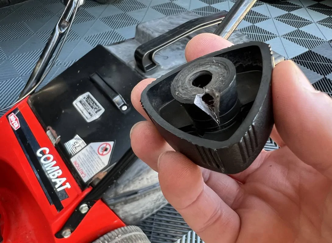

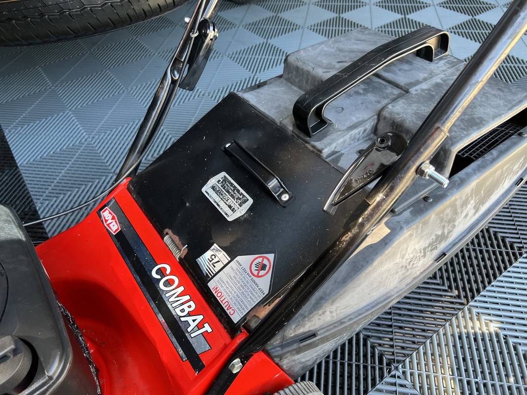

The parts have started to arrive for the Rover Combat.
Before I dive into the mechanicals, I'm waiting until the new fuel tank arrives. The old tank is leaking it's contents over a 24-hour period, so I want to sort that out before I pull the carby to pieces.

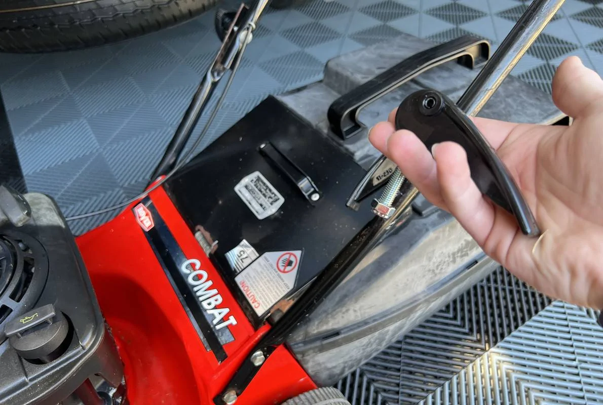

Arriving today was the carby kit, replacement fuel line and clips, spark plug and handlebar knobs.
The old Rover knobs had cracked, limiting their ability to tighten properly.
These aftermarket items are similar to the ones fitted to my ProCut.
Because of the reversed orientation of the handle bar on the Combat over the ProCut, I had to fit them on the inside. Either way, it's given some rigidity back to the handle.

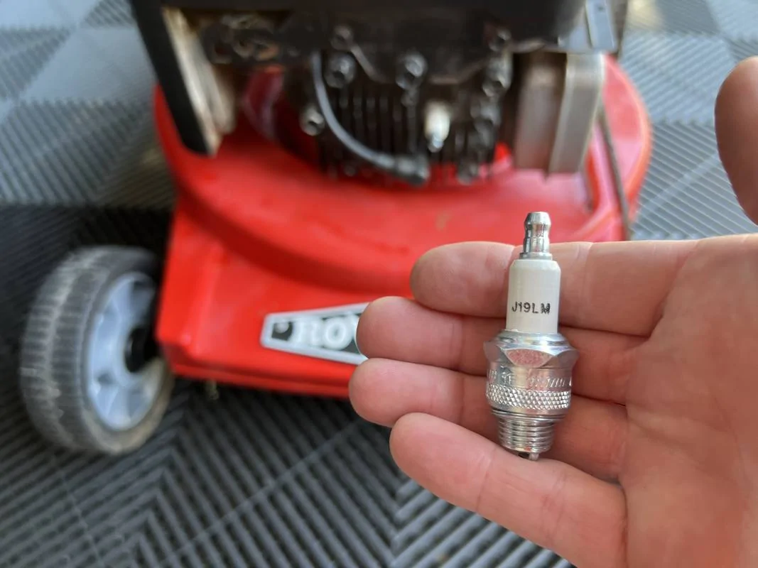

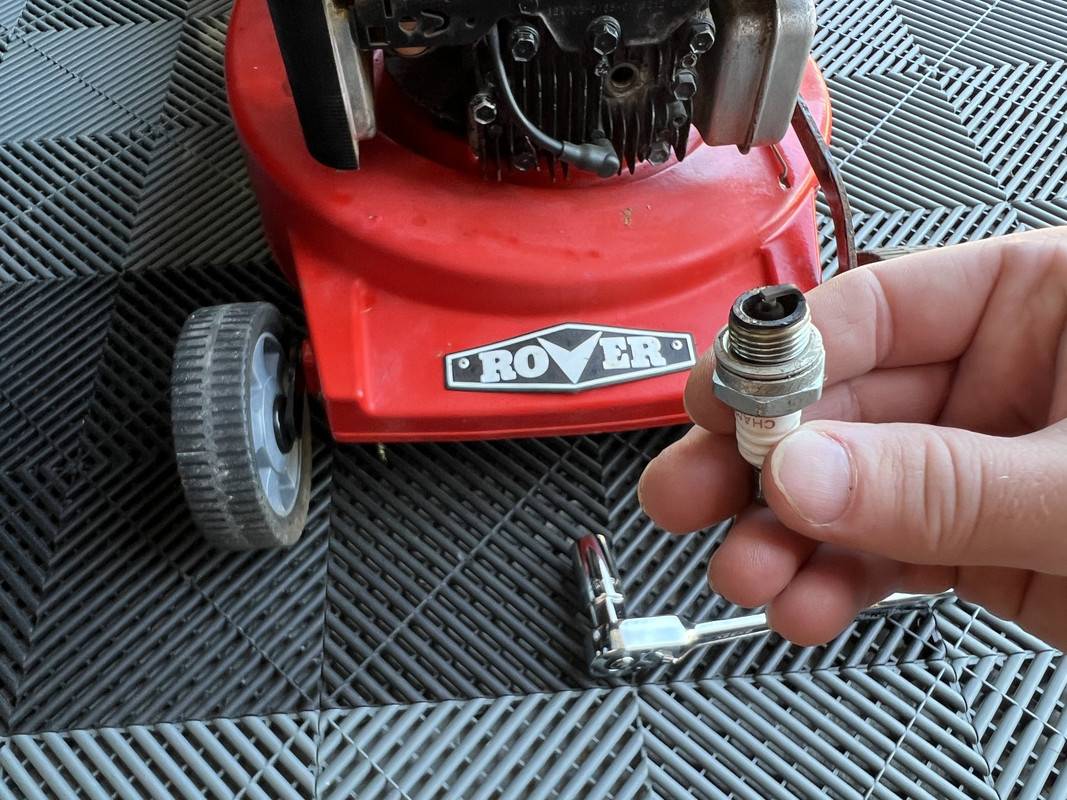

The spark plug fitted was the classic Champion CJ8, in decent condition.
The modern replacement is the Champion J19LM, the plug fitted to the later versions of the flat head engines.

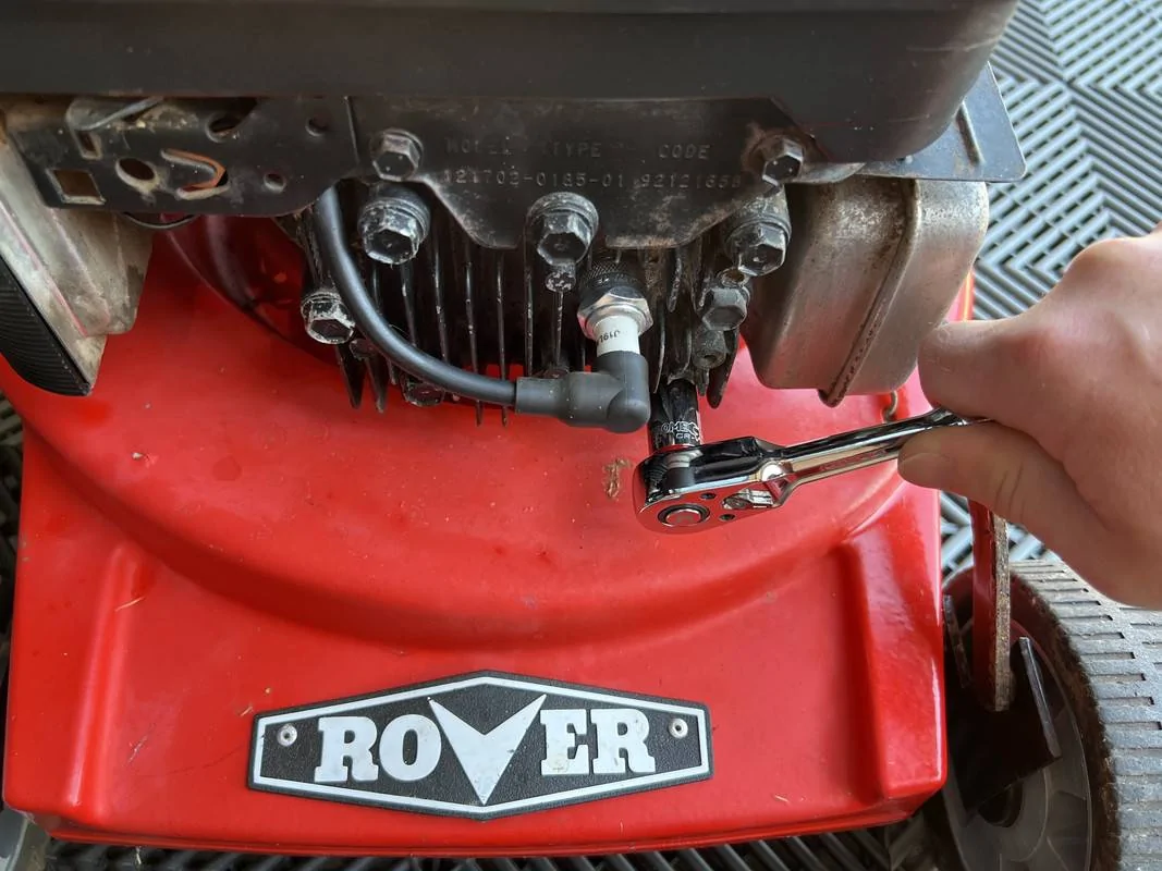

I also went around and tightened the cylinder head bolts. These have a habit of backing out over time, especially around the exhaust valve. I'm glad I did as most were needing some extra torque, again, especially the exhaust side.

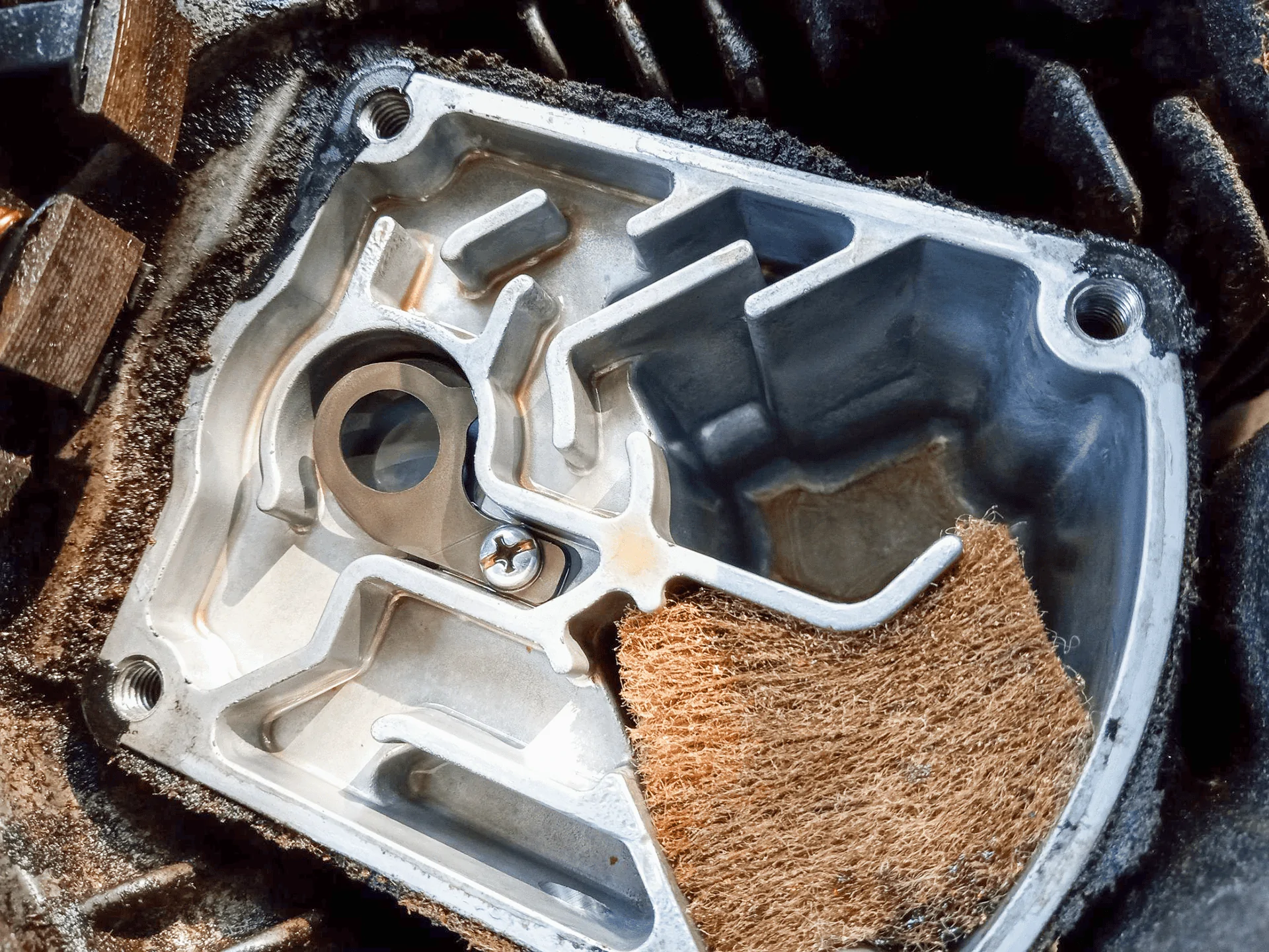

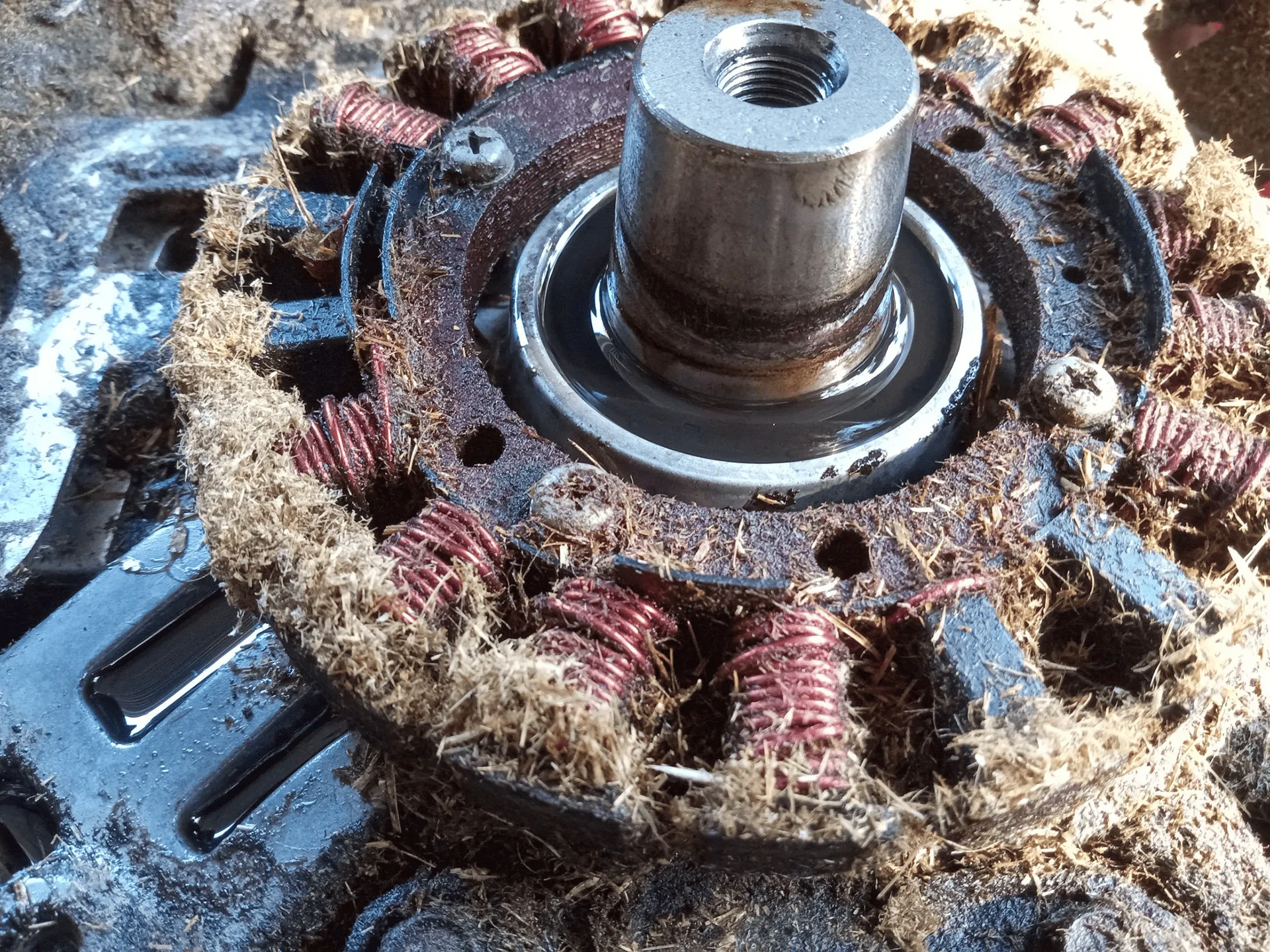

I don't know if you jinxed my Scag or not, D <grinning> but I just had it in the shop for a damn oil leak and my guy found the governor seal leaking. Fixed and she came back home but a week later, I saw more oil on the shed floor. Back to the mechanic and it wasn't the governor seal again, this time it was in the top end. The top crank seal and a faulty PVC cover gasket. He had to order the parts, (of course they weren't available locally with this supply chain we have now,) but they should be here this week and I may get my girl back in time for the next mowing day. :cool:
I wish I had found this fella YEARS ago as he definitely knows what he's doing and even sent photos. He also charges to LITTLE. :-) It's a 19HP Kawasaki.
She still looks nice and clean internally even if she was a bit grungy around the edges. :-)

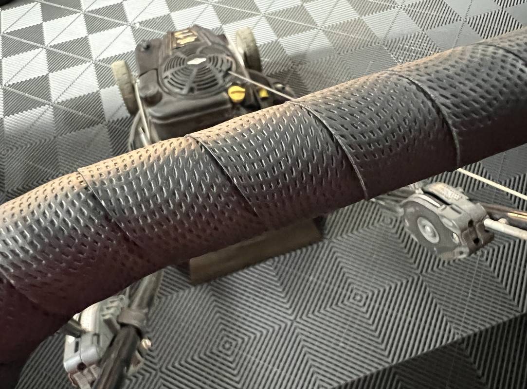

I know, another lawn mower post, but I did use a few detailing products to do this little job.

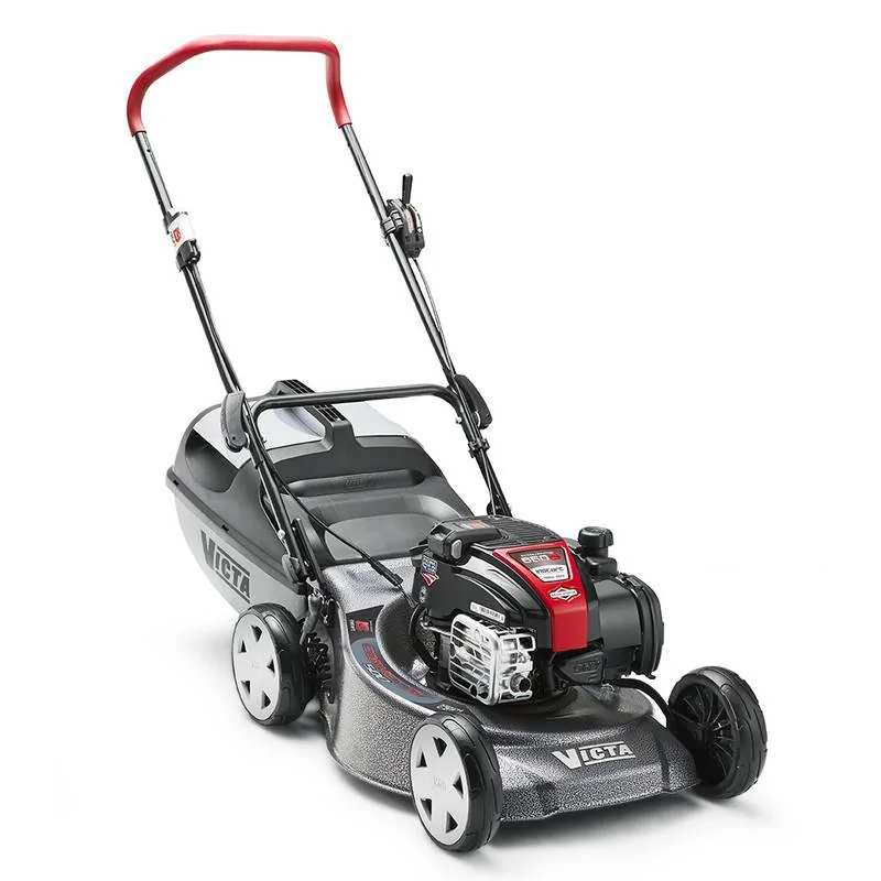

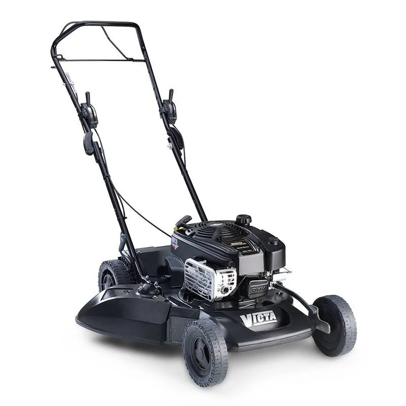

For whatever reason, Victa don't fit a soft grip handle on their commercial range of mowers. That includes the MasterCut utility, the 19 and 21 inch Commercial models and the Mulchmaster. When you consider a Mulchmaster costs $1899 AUD, this seems like a strange and stingy oversight.
https://www.victa.com/au/en_au/product-catalog/professional/lawn-mowers/mulchmaster-560.html
These mowers are dedicated mulching and side discharge machines. They were once available in push and self-propelled guises fitted with the strong 160cc Victa 2-stroke engine, Honda GXV160 or Briggs & Stratton Vanguard DOV 161cc engines. They are now only available with the Briggs 190cc 850 engine and self-propel, the same spec as mine. As a lawn contractor, in the right conditions these mowers can save considerable time. Time is money and all.
So, it's quite an odd oversight that even the entry level Victa's come with a soft grip handle.

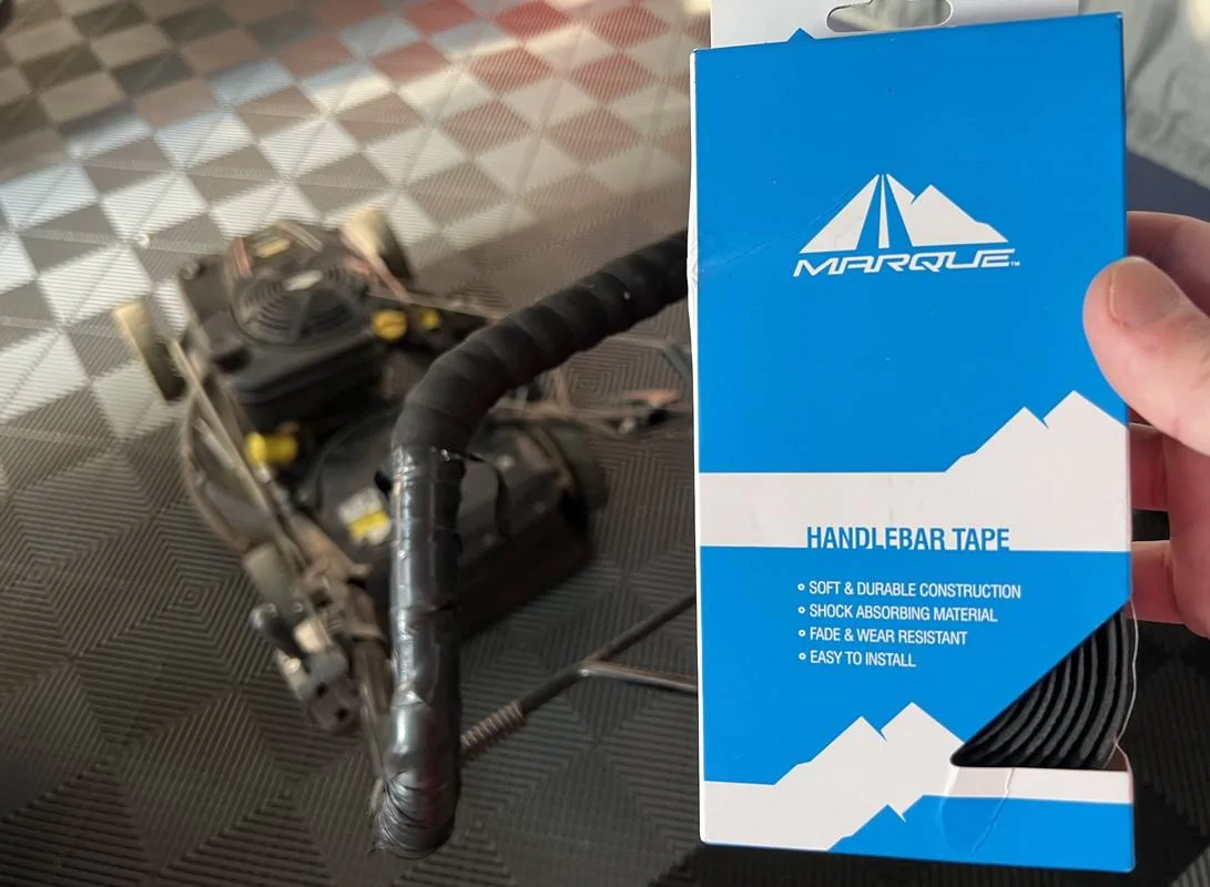

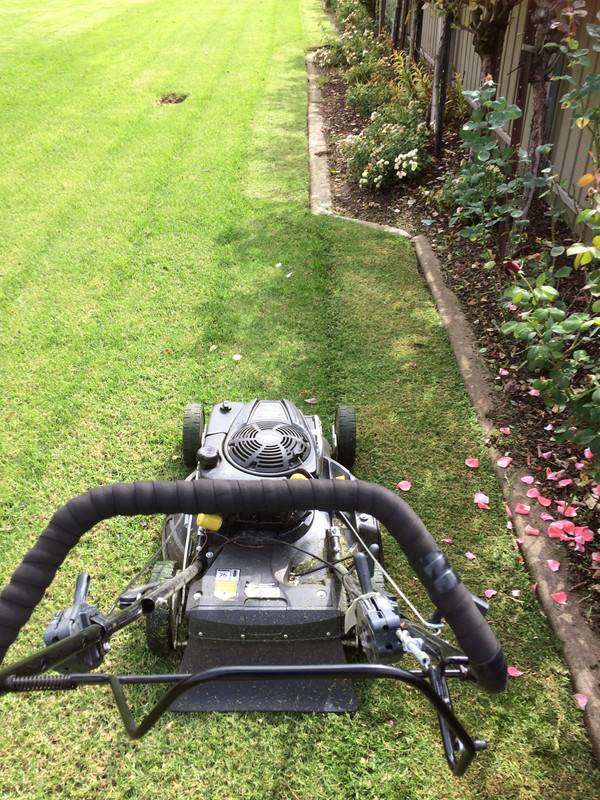

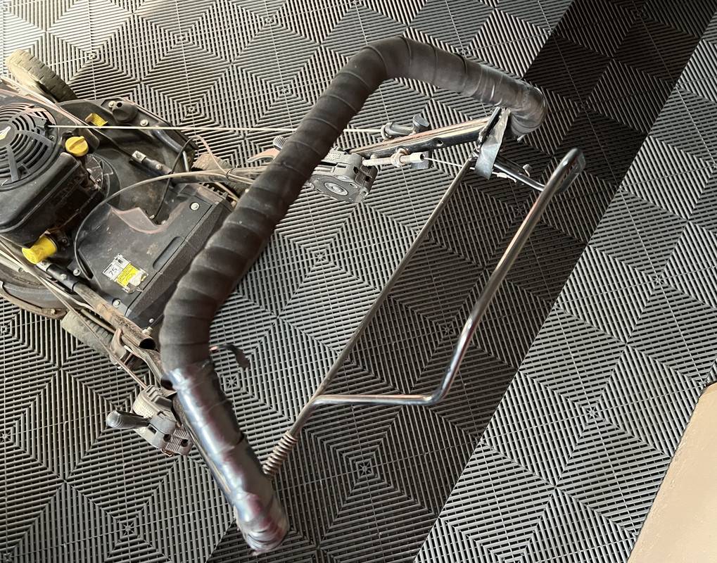

This might seem like a trivial issue, but you certainly notice the absence of the padding with extended use. My solution has been to apply bike handlebar wrapping -
I can't remember when I applied this but renewing it had been on the to-do list for a while.

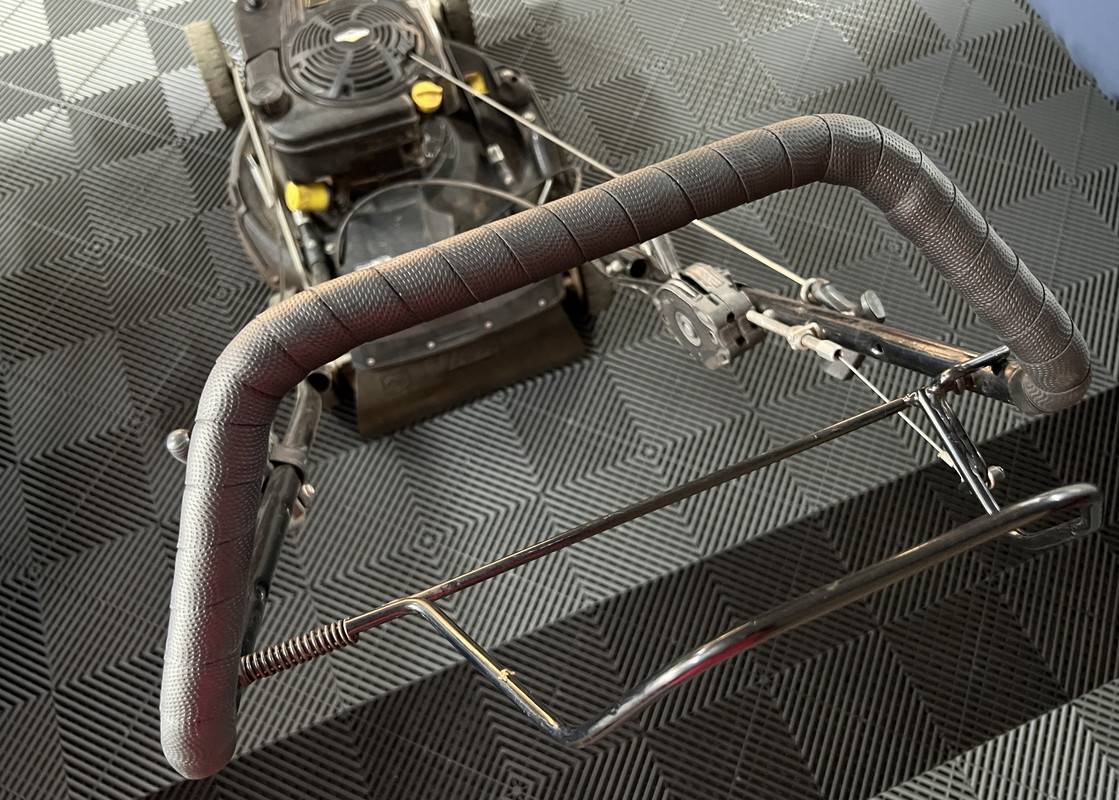

After removing the old tape, it was time to apply the new stuff, which was purchased from Amazon.

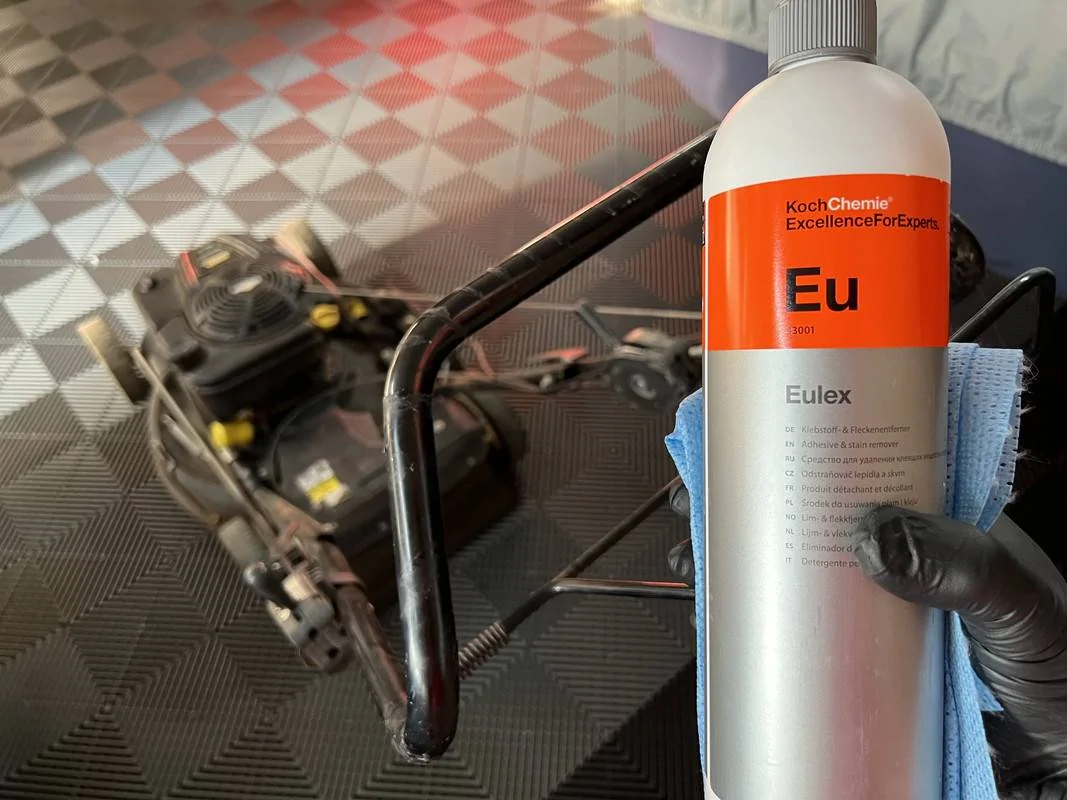

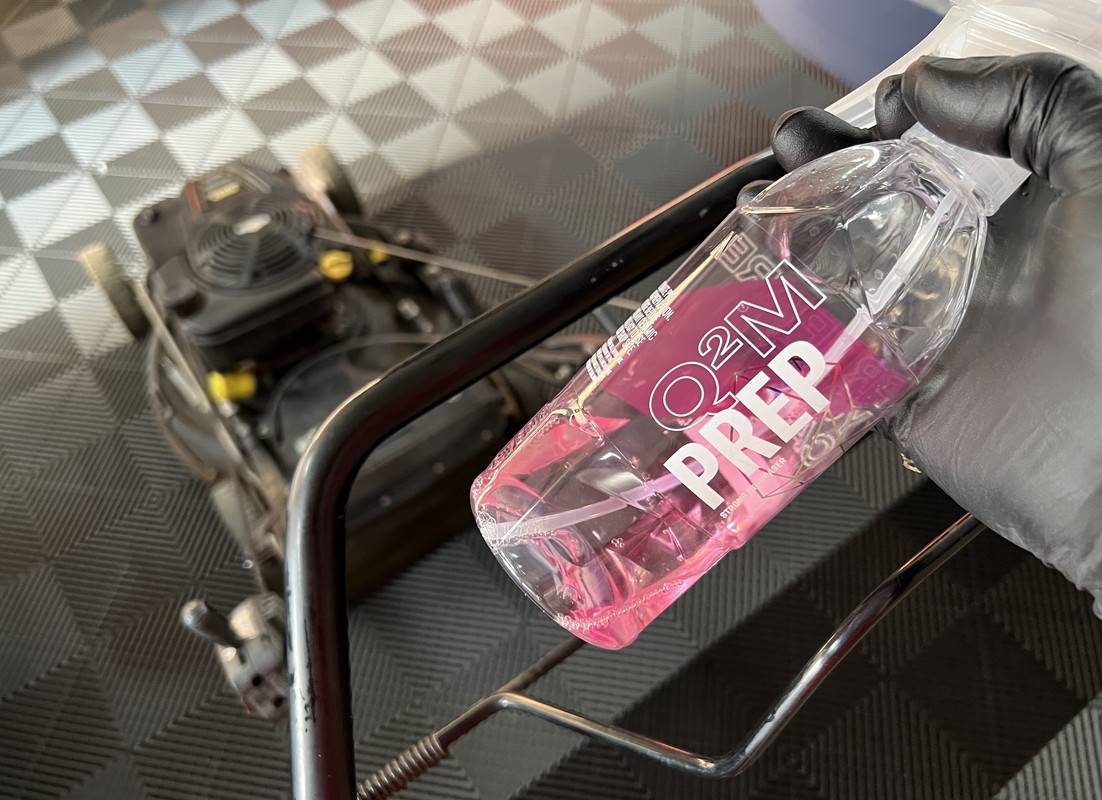

Removing the old tape left some adhesive residue, so it was out with the Eulex and a shop towel. This stuff is pretty potent and has a high evaporation rate, but it simply melts away glue and adhesive residue. I then followed that with some Gyeon Prep to remove any lingering Eulex residue.
I then applied the new tape. This stuff comes in a roll with a strip of adhesive tape running up the center. You then wrap the tape over the handlebar in an overlapping pattern.
Much better looking, and certainly more comfortable to hold.

Call me crazy, but I look forward to your latest endeavors every morning, D. <smiling> This one was no exception and while I have also done my share of handlebar wrapping, I would not have thought to use it on a mower but what a perfect solution.
When I was still using a walk-behind here, they often had mediocre quality foam on the handle that as you well know, would wear out in short order. Stupid me would wrap the failing foam in duct tape but it too wouldn't last long.
In the Navy we would say, "Good headwork" on the wrap. :-)

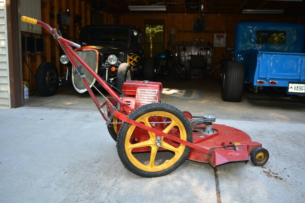

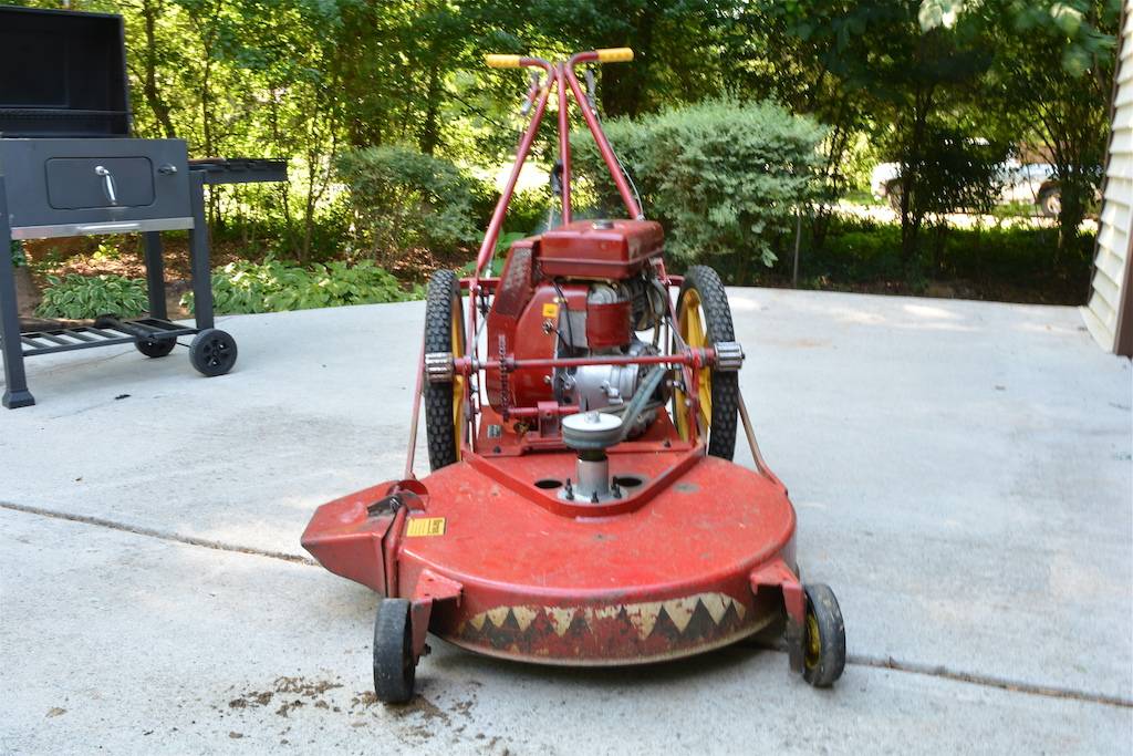

This mower was bought in 87, Yazoo is the brand, was made in Yazoo Mississippi, company is long gone now.
Wisconsin 15hp, 28" cut, 1-hour mows an acre of land. Use high test, winter close the petcock run the carb dry & store.
Spring 2 pulls if fires, it weighs 200lbs, bicycle grips factory, never replaced.
Need some humor to mow the land.

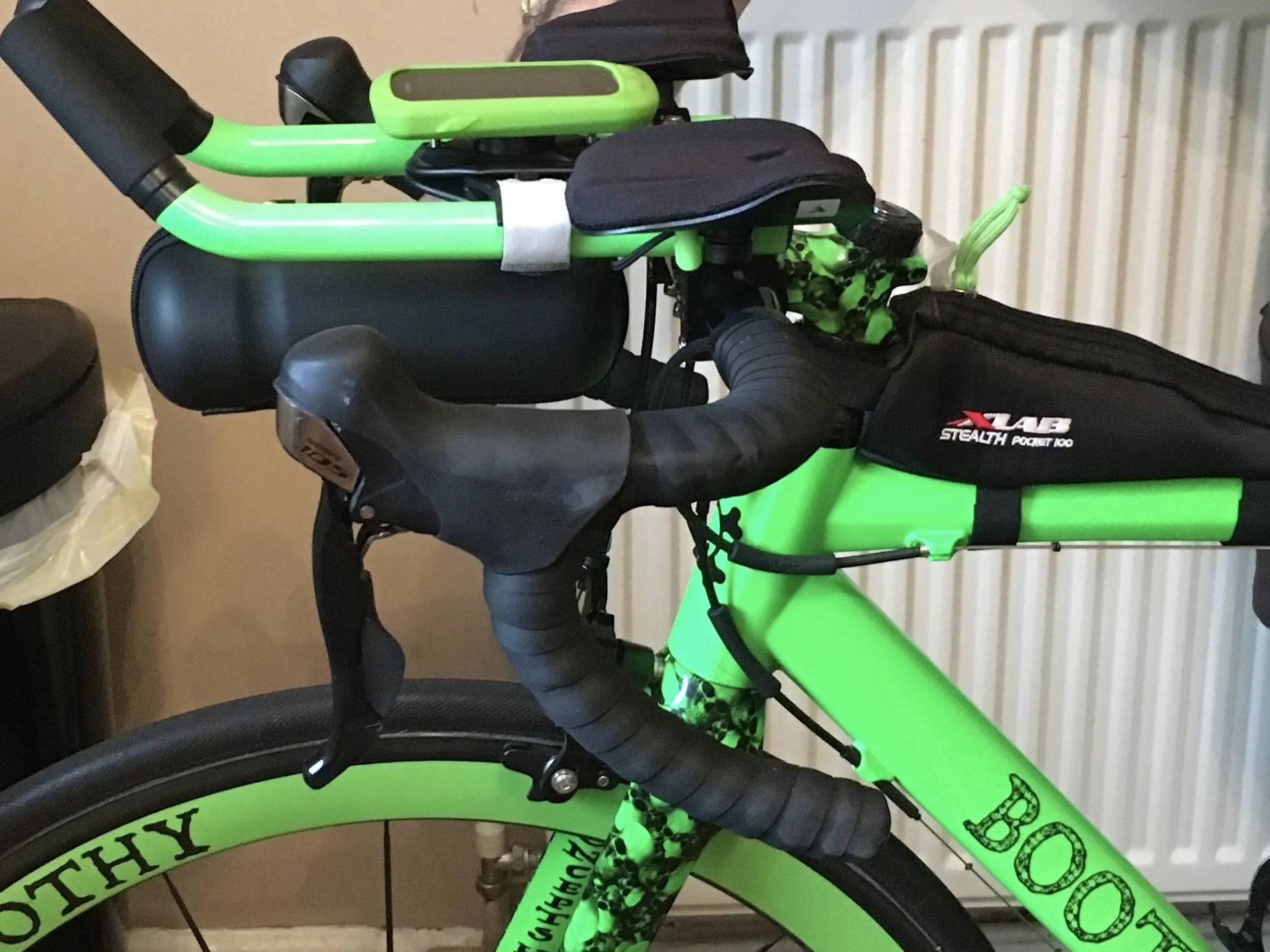

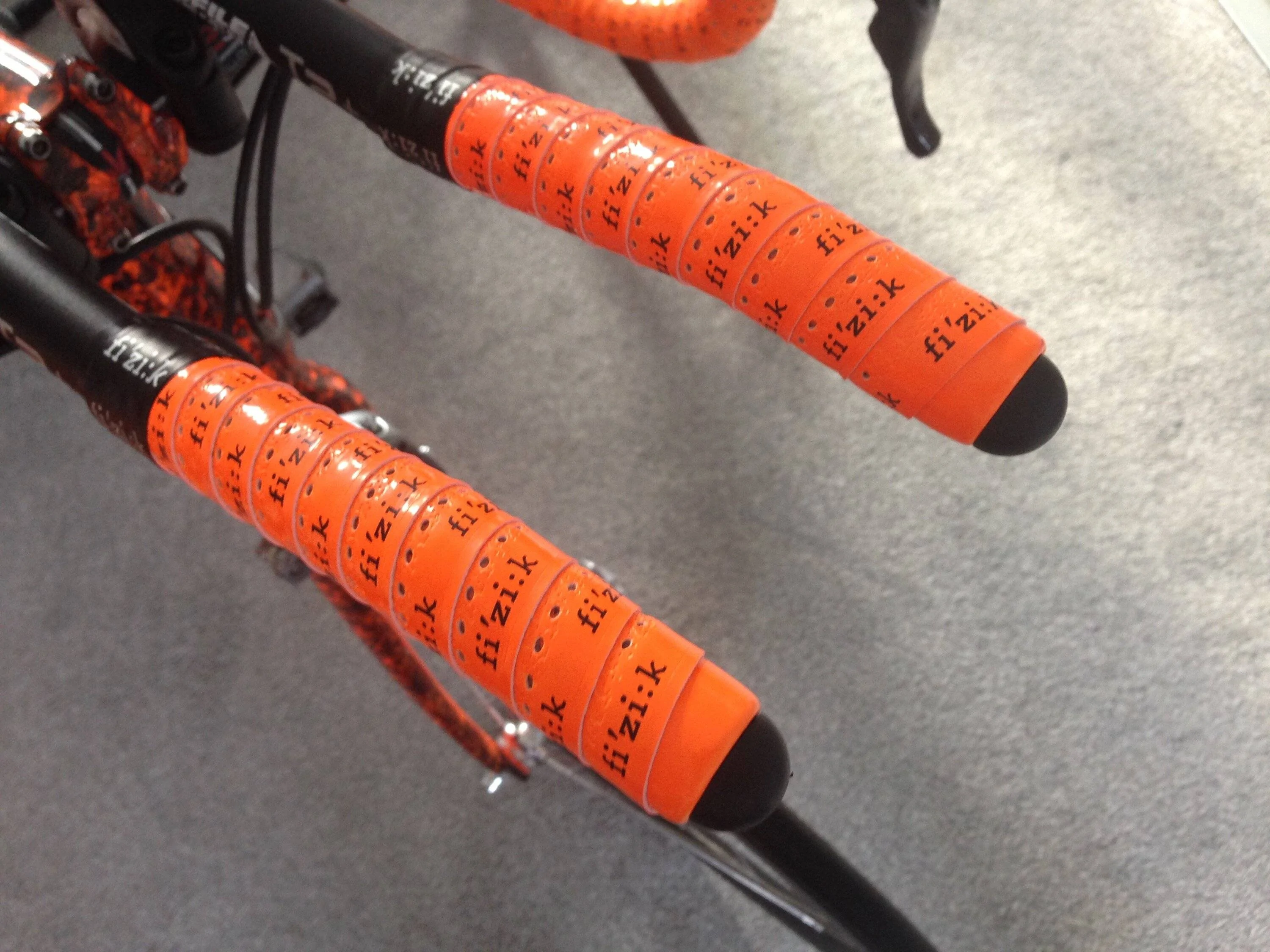

I hate wrapping bars, but there is something quite satisfying with getting it just right and matching the number of turns from one side to the other :sunglasses:
I don’t run bar tape on my road bike, but here’s a few I have wrapped for friends :

Yazoo is the brand
That is one serious mower, Greg and it reminds me of the US brand, Wheelhorse, that I BELIEVE Toro bought a couple two or three decades ago. VERY popular at the time.
And 28" is only a foot short of my zero turn cutting deck so no surprise that thing can chew up some lawn quickly.
Thanks for the photo, I think we all love "cool machines." :-)

Yes, it is amazing the machines made and the purposes for them.
