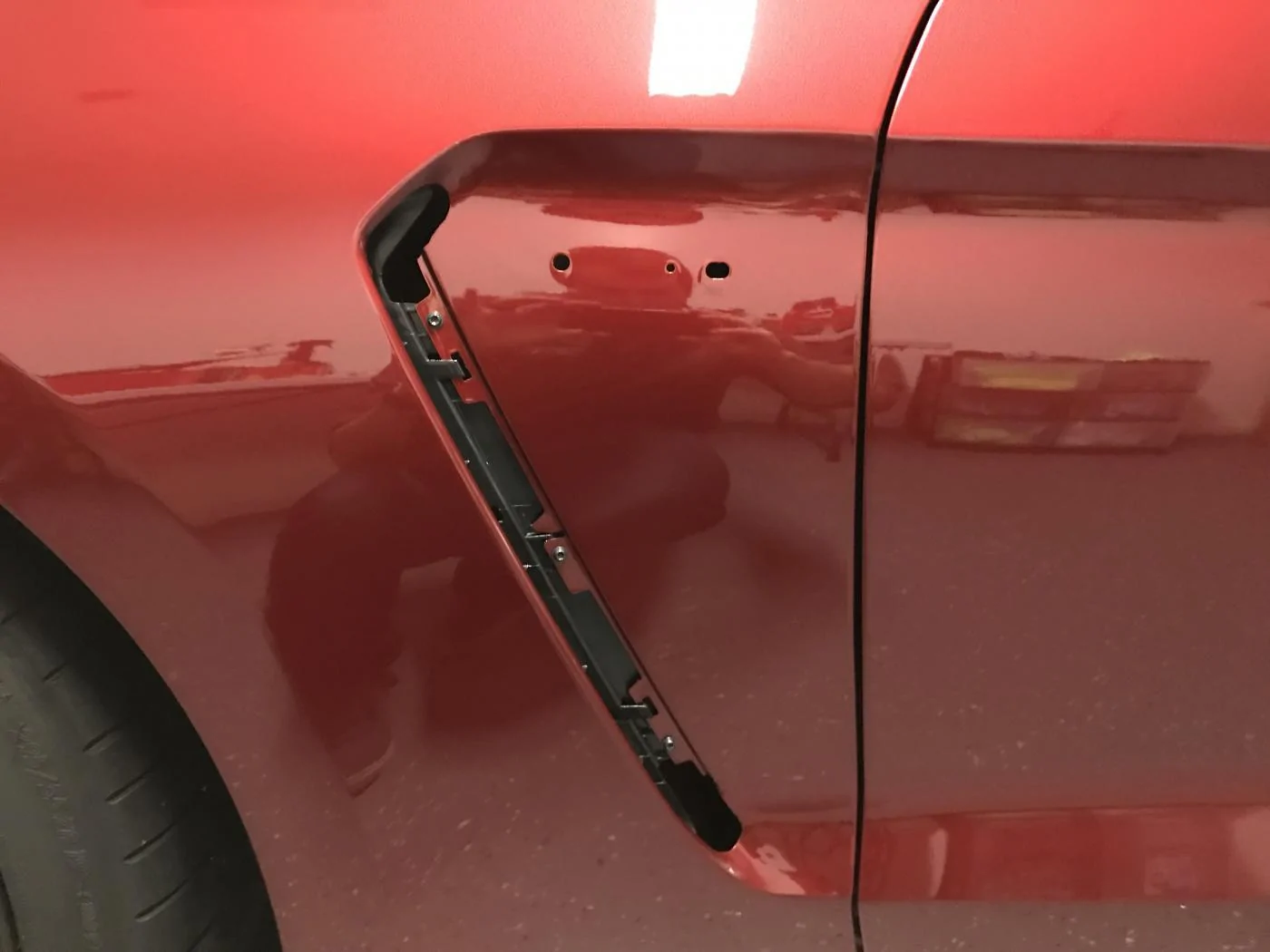

Howdy all,
Prepping the paint for polish and I decided to tinker with the side badges or vents to see if I could remove them (to polish and put film under them). It was MUCH easier than I thought.
Vent only takes a heat gun and some soft prying from your hands. Badges just take some finesse with fishing string and a pry tool (in addition to heat). Dont think id recommend removing badges unless you are willing to buy new ones because they are fragile. I stressed the first one enough that I will probably replace it. But it is doable. Second one came off super easy. Took a video. Will be going up with the rest soon.
