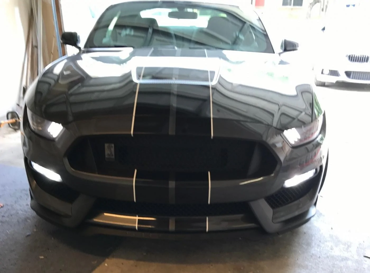

The switchbacks driver side needs a skinny arm to get around the oil cooler and even then a few scratches did not put in the resistors just live with the interior hyperflash, heard the resistors only last 6 months or so
The glove box I just popped out the whole socket because I had a problem lining up the bulb
And the 4 th brake light needed to get it on a lift so I could take the cover off
Really happy with all
One of the side markers went out but they replaced it without questions
