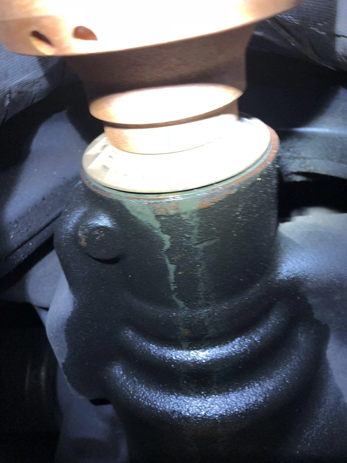

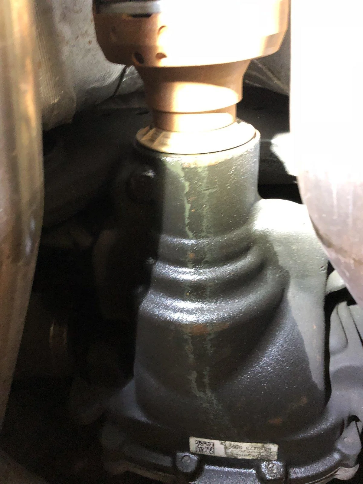

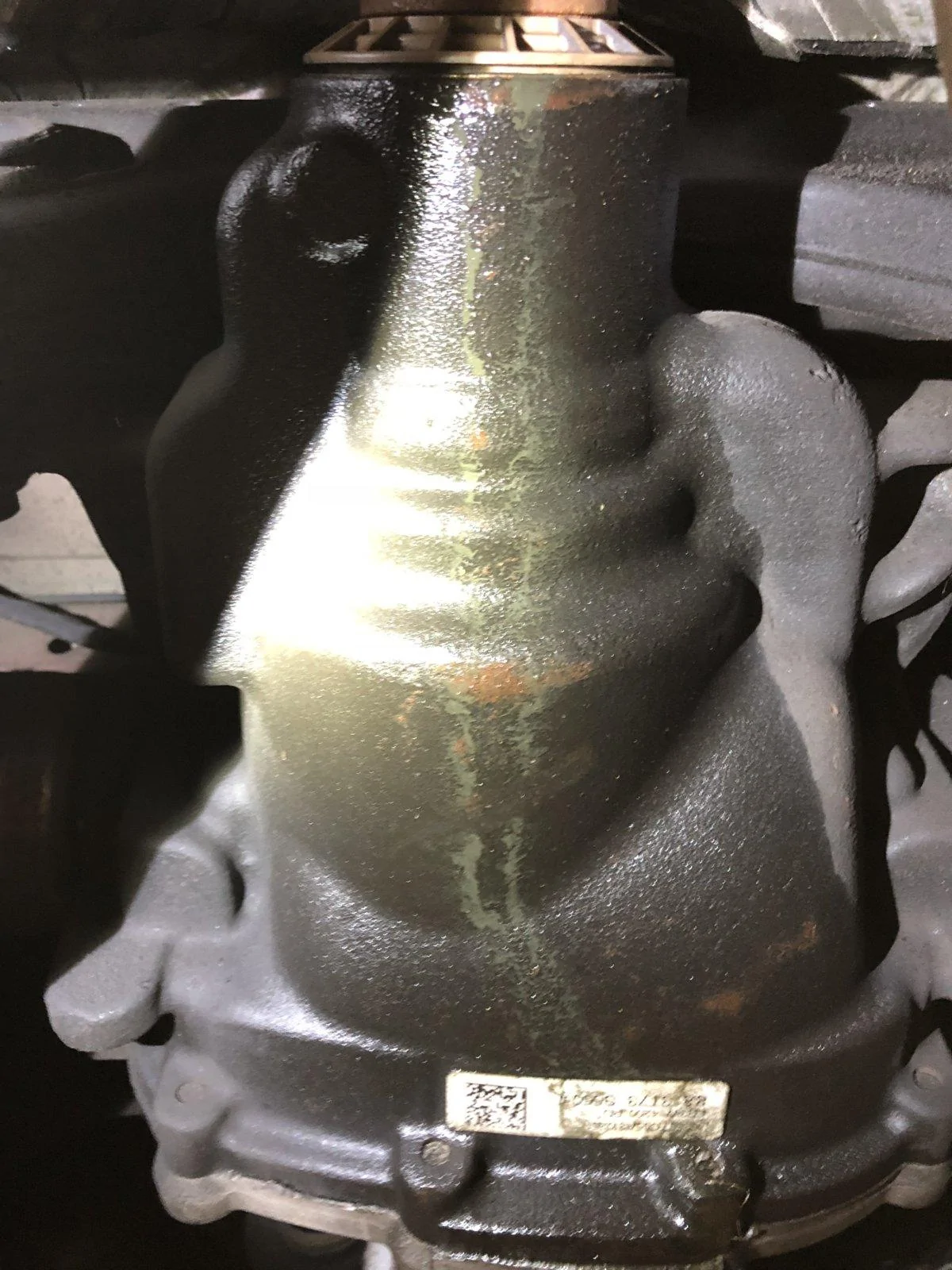

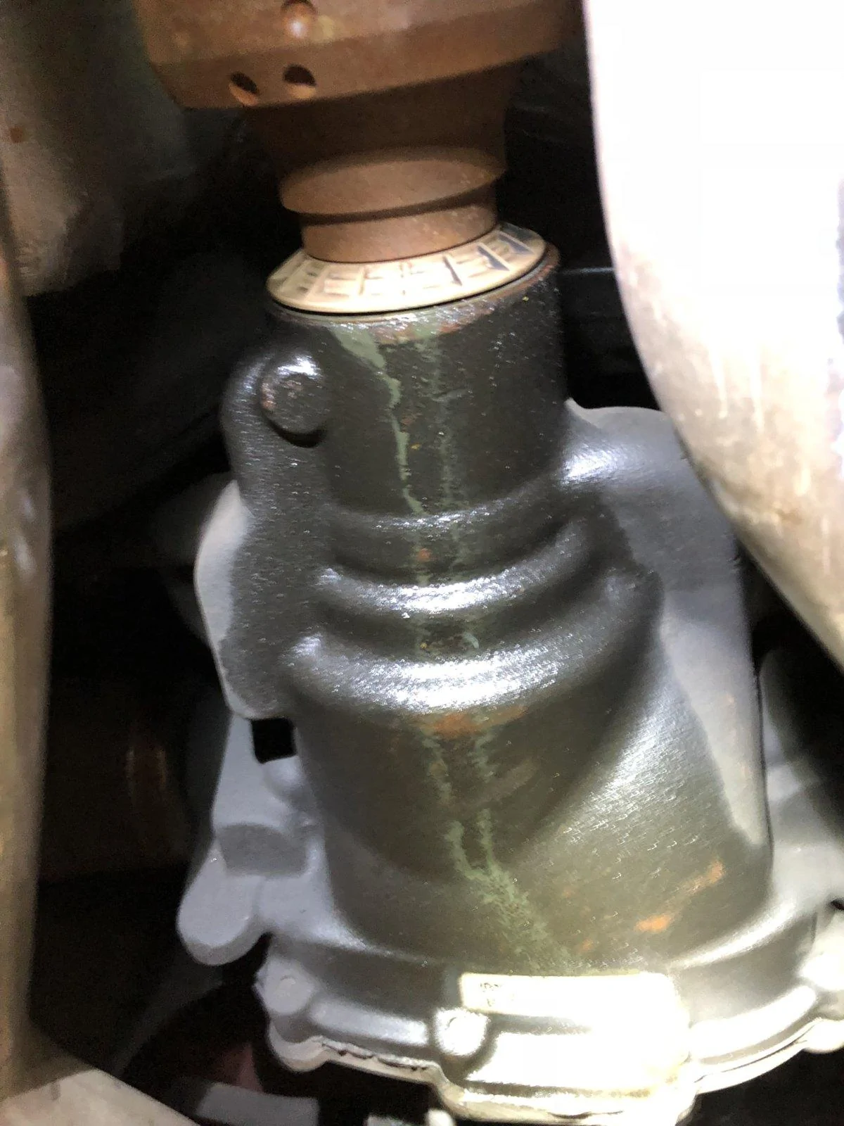

However, upon close inspect, i can see a leak coming from the driveshaft to differential connection point, it's gray/green in color and it looks like it has been going on for a long time.

Look’s like the pinion seal has a small leak. Easy warranty fix.
Also, you can remove the fill plug on the back and stick your finger in there and see if the level is low.

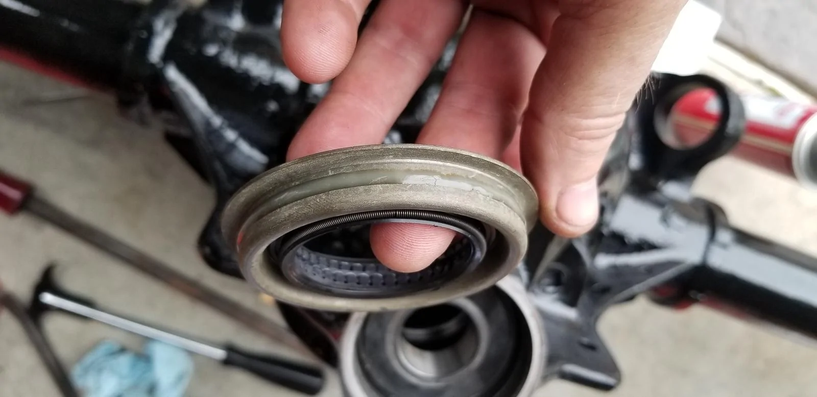

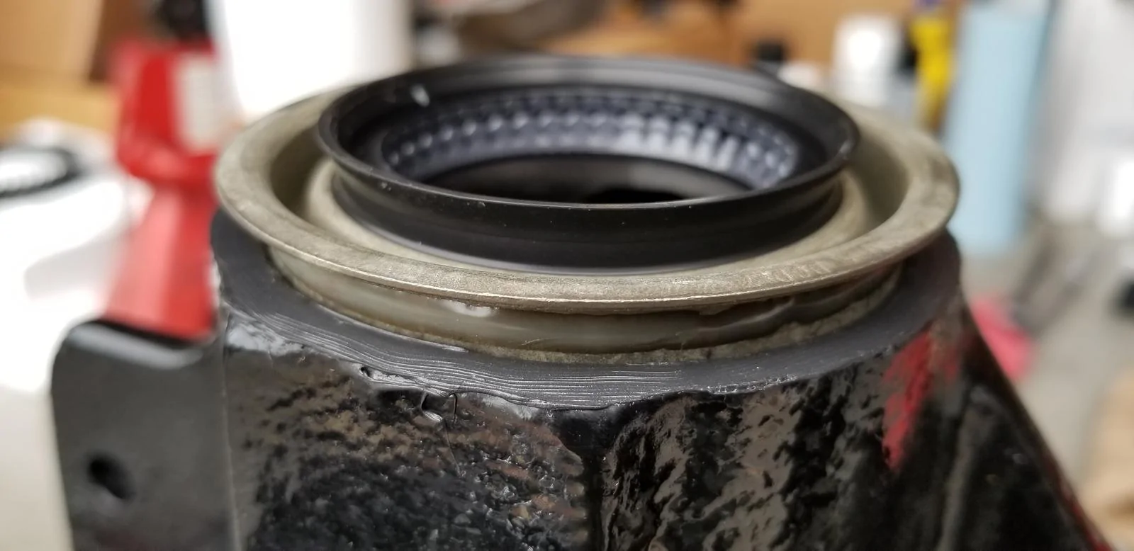

Prying the seal off is probably the easiest part of the job. I just finished a ground up 8.8" build (Fox era) and there are a few things that can be done to prevent fluid from weeping between the seal and the iron case. Make sure factory Ford service parts are used.
The seals come with pre-applied sealant.
It helps if sealant is added to the circumference of the iron nose before driving the seal home.
Also - you want any sealant used to be given proper cure time before filling the differential back up with lubricant.
