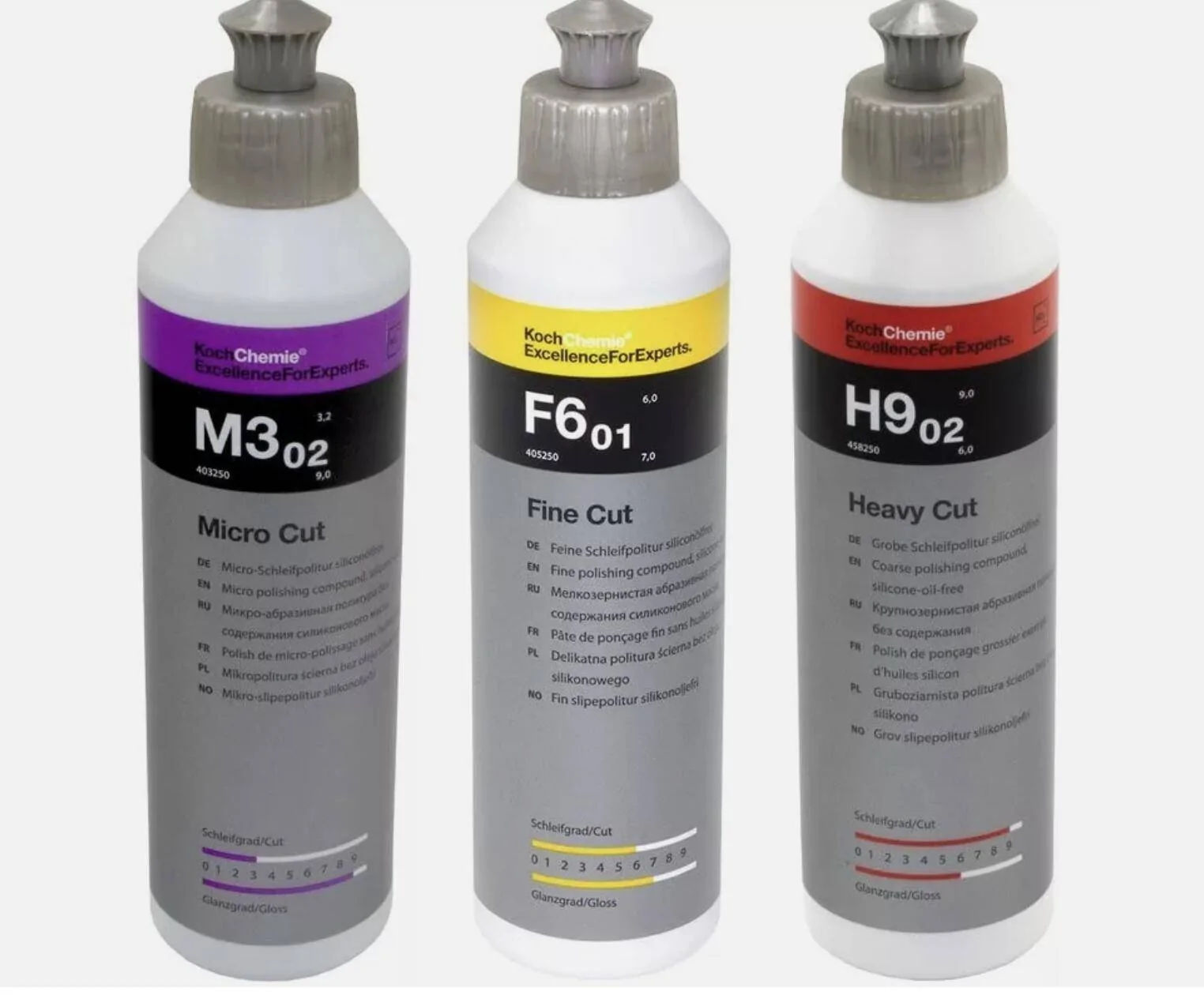

The DA Fine compound is a product that depending on the pad can either cut pretty heavy (with a Microfiber or wool pad) or it can be mild and finish down really nice with a finishing pad (Rupes yellow or white foam). The Uno Pure is a very mild finish polish, mainly used to amp up the gloss on already corrected paint or remove holograms on finicky paint... The coarse is just as it says, its a heavy hitter made for correcting severely neglected hard paint. I do not have the coarse in my arsenal, I have never found a need for it, the fine cuts really nice with a wool or MF pad... I use uno for that final kiss before laying down protection.
A very similar system that I have on hand is the Koch Chemie line. They have H9 (Heavy), F6 (Fine) and M3 (Micro) that are very similar in makeup.
