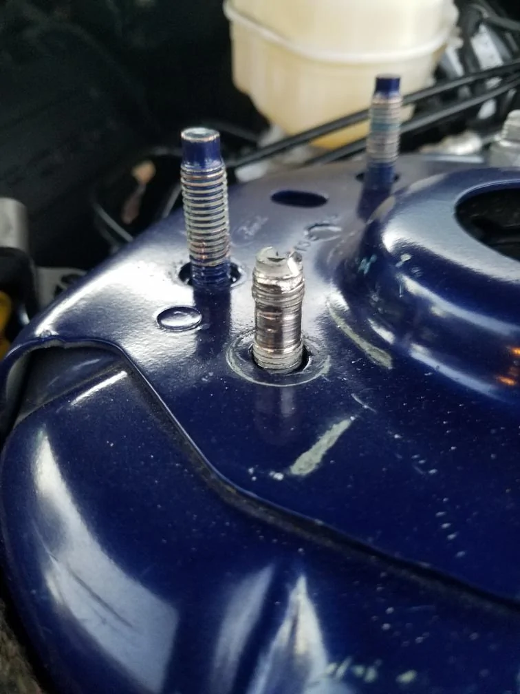

Thanks for the PM. it wasn't your part that failed. It was the cheapo nuts from home depot. Took car to my ford dealer. $29.99 for new nuts, $118.00 for labor. Also need a new left strut mount as the post is now stripped. Had to order a new one for $33 but dealership wants to charge me $390 to install it. Ouch. Gonna pick up the part & find somewhere/someone else to install it. I love Steeda & will always use their suspension parts when possible.

pics of the aftermath. Getting new top strut mount put on Saturday.
