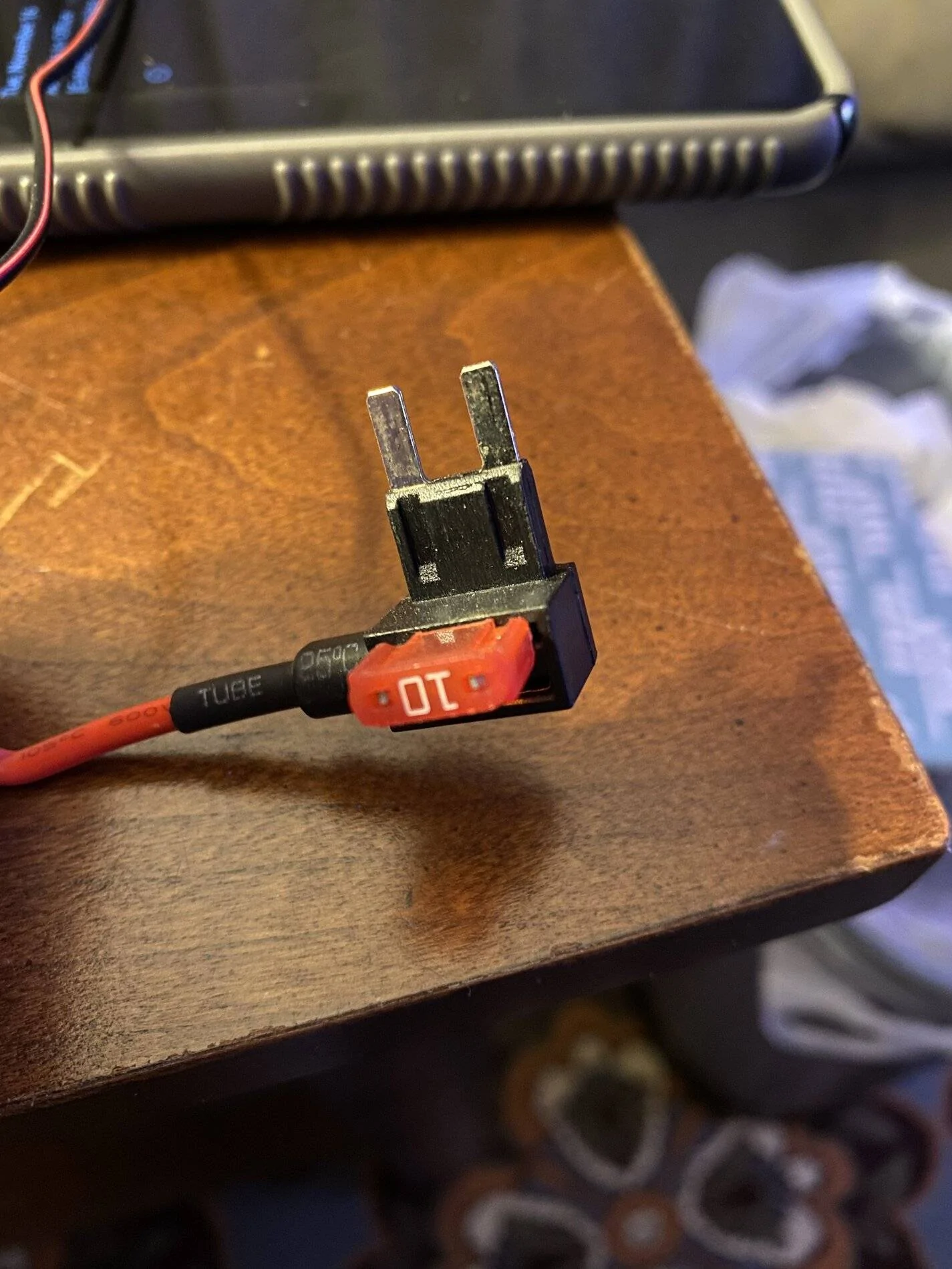

21 Stang GT Premium, 22 F150 XLT Sport, 07 Tacoma
dunno if it helps but this is the pic of the one i have.

i don’t unfortunately, she’s my 3rd really…i’ll be DD since i just got her lol but once the novelty wears off, it’s mainly my work f150. yeah i don’t think my Rove has that. i may just run it and tap off fuse 23, which everyone seems to say to do, but i don’t think my adapter will work. i think i need the micro now because mine may be a regular sized.

so i opened it and fuse 23 is the micro which is smaller than the tap i have. so i just ran the 12v adapter through the headliner and a bit through the pillar and under my weathertech mat and up to the 12v adapter under the radio. it just missed being able to go into my console which sucks. but whatever.
