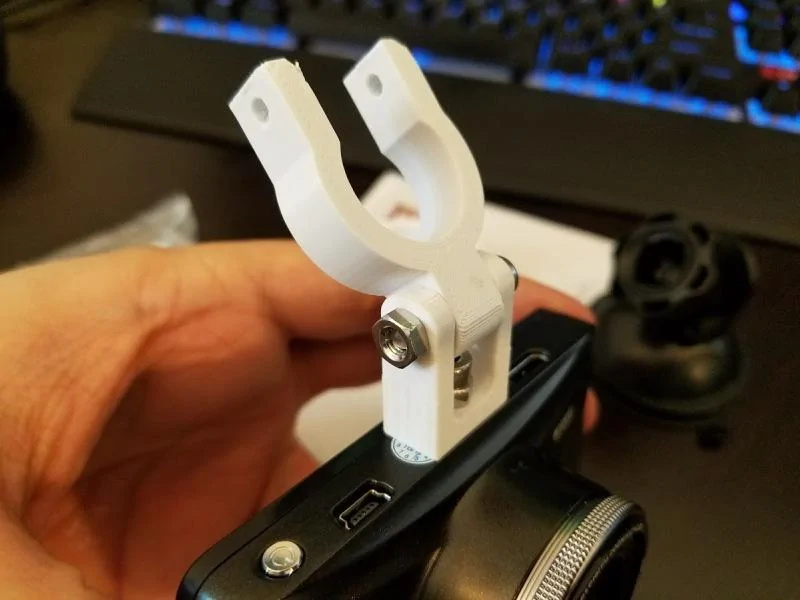

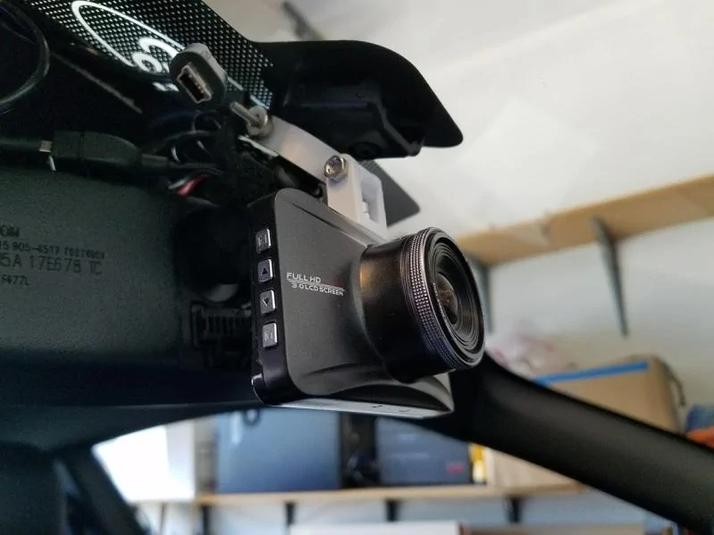

I had this problem too. The suction mount fell off multiple times, even after cleaning the glass and suction cup. Ended up designing a new mount in CAD that attaches directly to the mirror, printed on my 3D printer. So far it works great. It's printed in PLA, so i'll find out here in the summer whether or not i'll need to reprint in ABS or PETG to handle the hot air and sun beating down on it, as PLA tends to soften and warp when exposed to high temps. So far so good, though. Might find something like it on Amazon?

I plan to test it out a little bit more and might improve the hinge/joint to make it notched so it doesn't just rely on friction to hold the hinge in whatever position you adjust it to. I'll probably put it on Thingiverse once i'm happy with it. I don't care to make money off of it, and if anyone on here wanted one to have one, I could print it and mail it. Also, the one pictured is the first/only print I've done so far, and I think I need to make the clamp a bit larger to fit over the mirror mount a bit better. After that, I think it will be worthy to share. Should work pretty well for any cam that uses a screw mount. I even had thoughts of printing a "cover" for the top clamp part out of TPU (soft/rubbery material) so it's grippy and will hold better rather than clamping hard plastic against hard plastic.

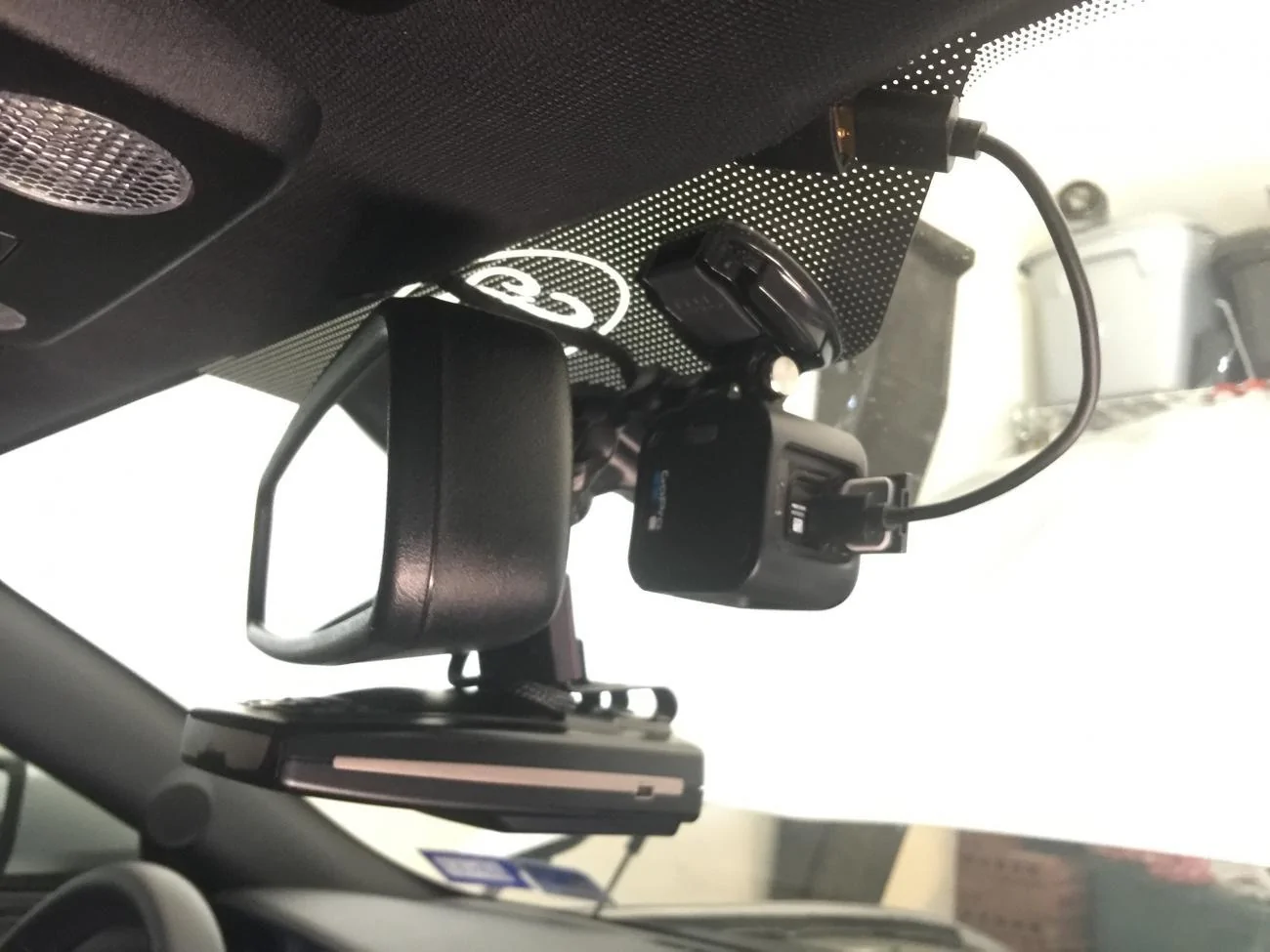

I use a GoPro Session 5 as a dash cam and I tried different mounts to the mirror but they all vibrated too much for my liking. I finally just used a GoPro adhesive mount directly to the black poke-a-dot close to the mirror arm and I'm very pleased with the results. I ran a 12v to 5v converter for power to the overhead lights and I'm also very pleased with that.

The first thing I checked was vibration and it's smooth, thankfully. Mine mounts to the part of the mirror that's attached to the windshield, not the mirror itself, so there's no vibration and the camera doesn't move if you adjust the mirror. I used a DC-DC converter to get 5v USB too, works great. :headbang:

Here's mine using the adhesive mount. Any camera with a tripod mount hole can use the adhesive mount and an adapter. I have a script that starts the camera when it gets power and turns off when no power and can watch it through my iPhone.
