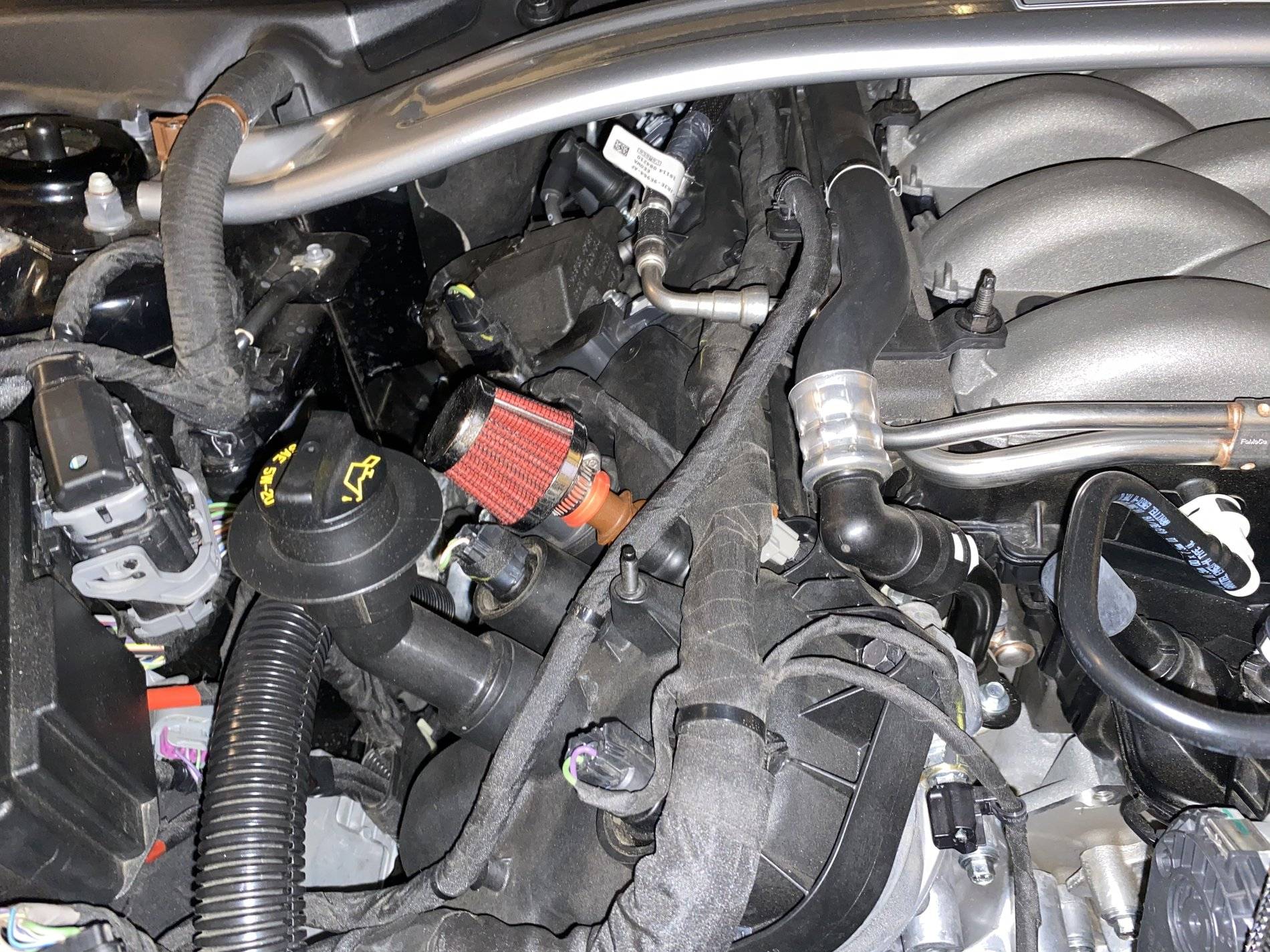

I have been running a single Spectre filter on passenger side for over 10k miles. Car just turned 11k. No oil anywhere. You have to pop the check valve out of the pcv valve cover insert. When I swapped my TB around 5k miles there was no oil in intake or tb. With the cover on you will not see it unless you look. fyi.

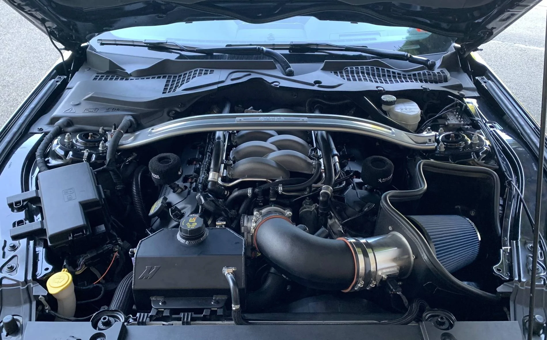

Check out JP Racing's stage 2 breather kit. Running them on my n/a car. Got them wrapped in some breather socks I found on Summit Racing.
