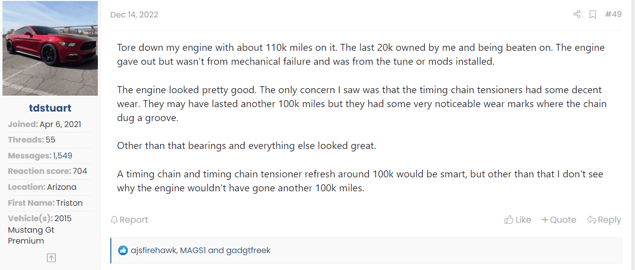

https://www.mustang6g.com/forums/threads/coyote-longevity-prospects.183181/page-4#post-3691649
Specifically this post
Now I personally would not even worry about it if its not making unusual noises until maybe 150K miles. But if the engine is boosted or abused might consider earlier change. The timing chain in this car is supposed to last lifetime of the engine but shit happens. Based on the number of engines with issues I would say its more of a rare occurrence.

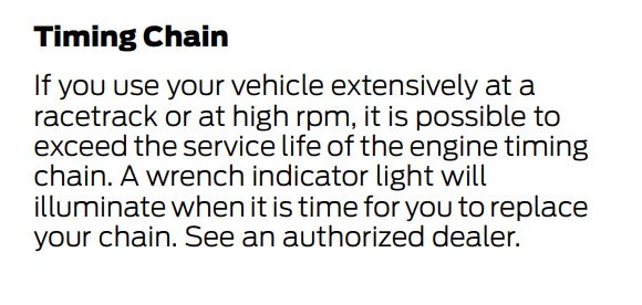

The manual on the 18+ says a light will illuminate on dash when time to change timing chain. Based on revs, temp and other inputs I’m guessing.
anybody else saw that?
Yeah mine says this on the Mach 1 supplement Manual.

Coyote tick is not timing chains although timing chain failure and excessive stretch may result in a tick similar to the coyote tick.
If the coyote tick starts getting louder than I would worry.
As referenced by another poster I tore down my motor with 100k miles. The plastic tensioners do get noticeable groves from the timing chains eating into them. If you plan on driving the car somewhat aggressively I would recommend changing tensioners, tensioner arms, and chains at 100k. If you are boosted more frequently and upgrade to the 350 primary chains and boss tensioners.
