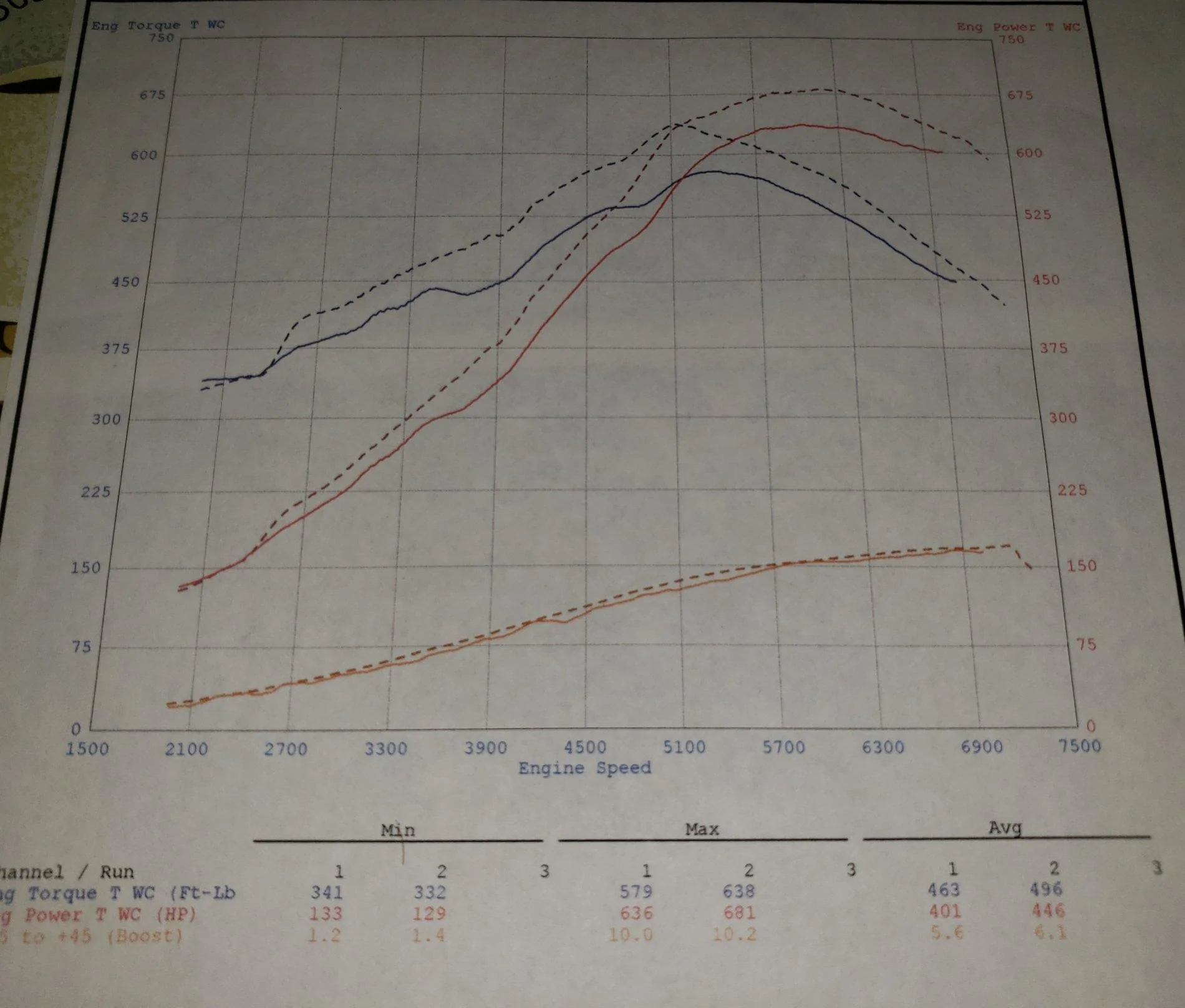

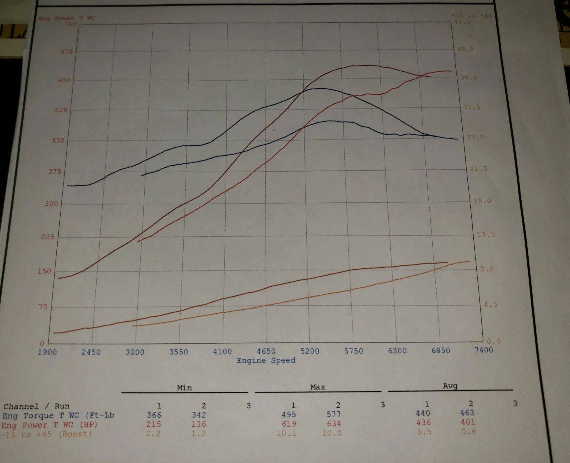

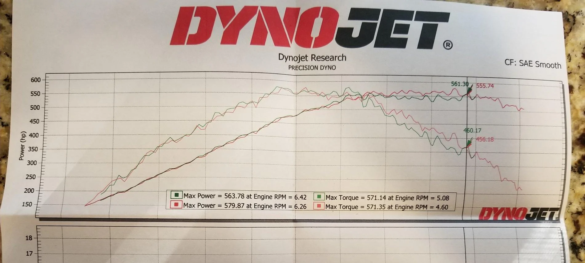

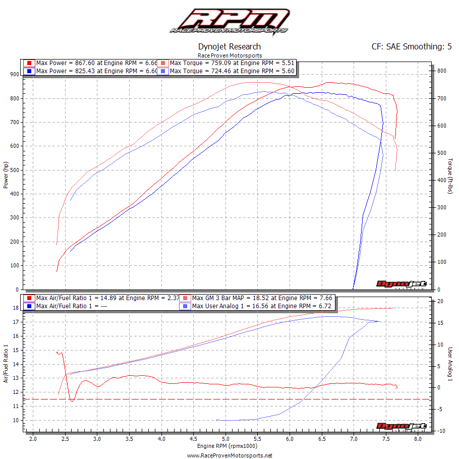

I ran my d1sc with a tial wastegate on a stock engine with 10psi all the way up to a rods/pistons shortblock with 18psi. Your dyno graphs looks similar to mine with power peaking in the early 6000rpm range. I would shift at 7000rpm and the car ran awesome at the track.
Thats 10psi with a 4.62 pulley vs 10psi with a 3.9 pulley and wastegate.
This is pump 93 vs e85 with the wastegate
Rods/pistons on 16psi gate vs l&m cams and gate at 19psi which it didnt hit. The d1sc ran out of steam on this pull. Before the cams it went 9.6 at 147 with a stock mt82 in my 2012.
