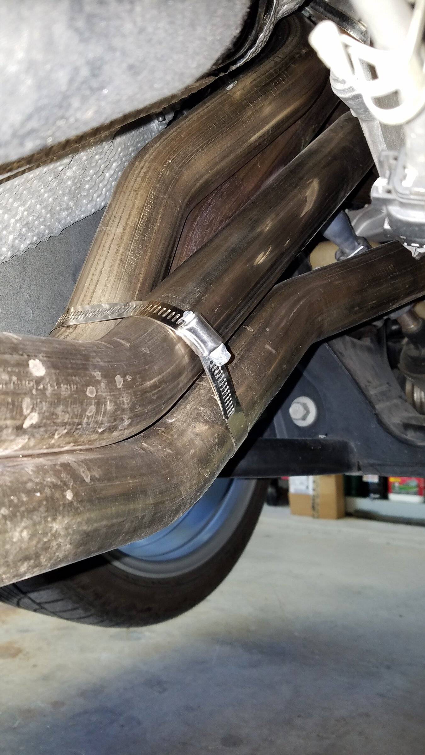

Put a hose clamp around the 4 tubes and tighten it up. Drive it and look for knock
This! I did this very thing with my headers. The primaries were just close enough that under heat they would slightly touch causing a minor vibration at certain RPM's and right at throttle lift off.
While I haven't performed the fix yet, if that is your issue a small tack weld between the primaries should fix the issue.

Thanks for the ideas. I'm definitely going to try the hose clamp, and try to make sure nothing is stuck in between the pipes.

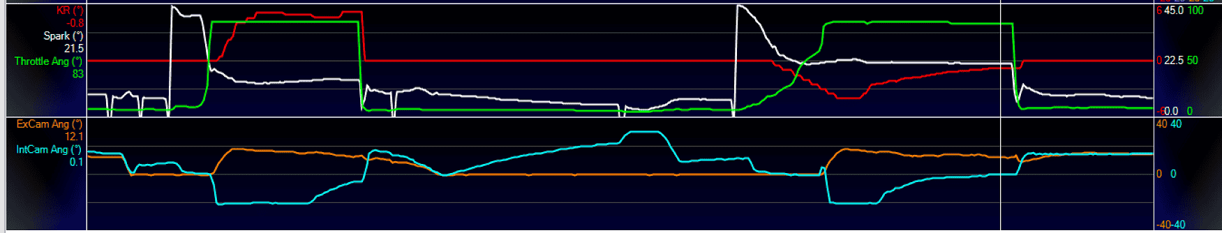

I've been all over the car tapping on things and moving stuff around. I removed my driveshaft safety loop just in case, tightened up a bunch of exhaust clamps, and I have a band clamp on each header. I'm still getting false knock, but it's only when I stab the throttle wide open. If I gradually roll on it, the knock sensor is happy and adds timing. I may try multiple clamps per header... I don't know what else to try at this point.
I took this log today with 3rd gear runs back to back. First one was stabbing the throttle and the second was gradually getting to full throttle. Funny thing, after this, I couldn't get it to knock again, but I'm sure it will be back tomorrow.
Mine does this too, sort of gave up. The only thing I could say for sure was it didn't happen when I rolled into it. I also looked at some logs from the track and it didn't seem to do it then either. But stabs, yes almost always now. Sometimes a little positive, Sometimes it just doesn't quite add as much timing. But roll into it and almost instantly it adds 4 degrees.

I can say I had a tune that did this. Stabs of the throttle and instant positive kr reading. Rolling on the throttle a tad before stabbing it reduced the occurrence. Could even get it in neutral blipping the throttle. Some say too aggressive "throttle tip in". Idk, but I went to a different tuner and it cleared that up.

My issues are similar. Only happens to me in 2nd (occasionally) and 3rd more often. Mines a manual though so I figured it was something in my tranny getting ready to let go. Been like that for 15k miles now. First 5k boosted it never did it. Doesn't happen very often now but I noticed if I slam gears over 7k I'm fine. If I slam 2nd or 3rd around 5500-6500rpm, good chance it will happen, but if I shift smoother and get into the gas gradually at those rpms I'm good.
