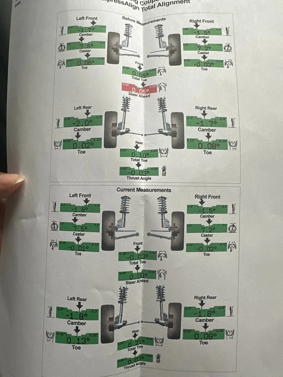

I've seen those tire sizes (275 and 305) to be most common for 20 inch rims at either 10 or 11.
For up front how negative are you talking? Above -1.6?
And for toe are you saying zero toe on both sides or are you talking about the total toe?
This is my last alignment with those tire sizes.
Yeah without camber plates, that's fine. Safe and my only very minor gripe is I'd rather have 0 or very slight toe on on the front that toe out, but its so close to zero it really doesn't matter much.
For carving you want camber plates and over 2 degrees of front camber, but that will take camber plates to do it well.
As mentioned, the tire stagger is going to leave you with understeer at the limit, but for most people that's the safest option if you aren't used to a car which can oversteer in a corner on demand. You can't easily dial that out with just an alignment, but more camber would help.

IMO (since there really is no "correct" alignment) your After measurements look really good. I wouldn't change them or worry any further. I also don't recommend camber plates for your use.
You can test that slight rear thrust angle by finding a real flat, smooth, level (no crown) stretch of freeway and see how far you can drive hands-free before the car wanders a bit to one side.

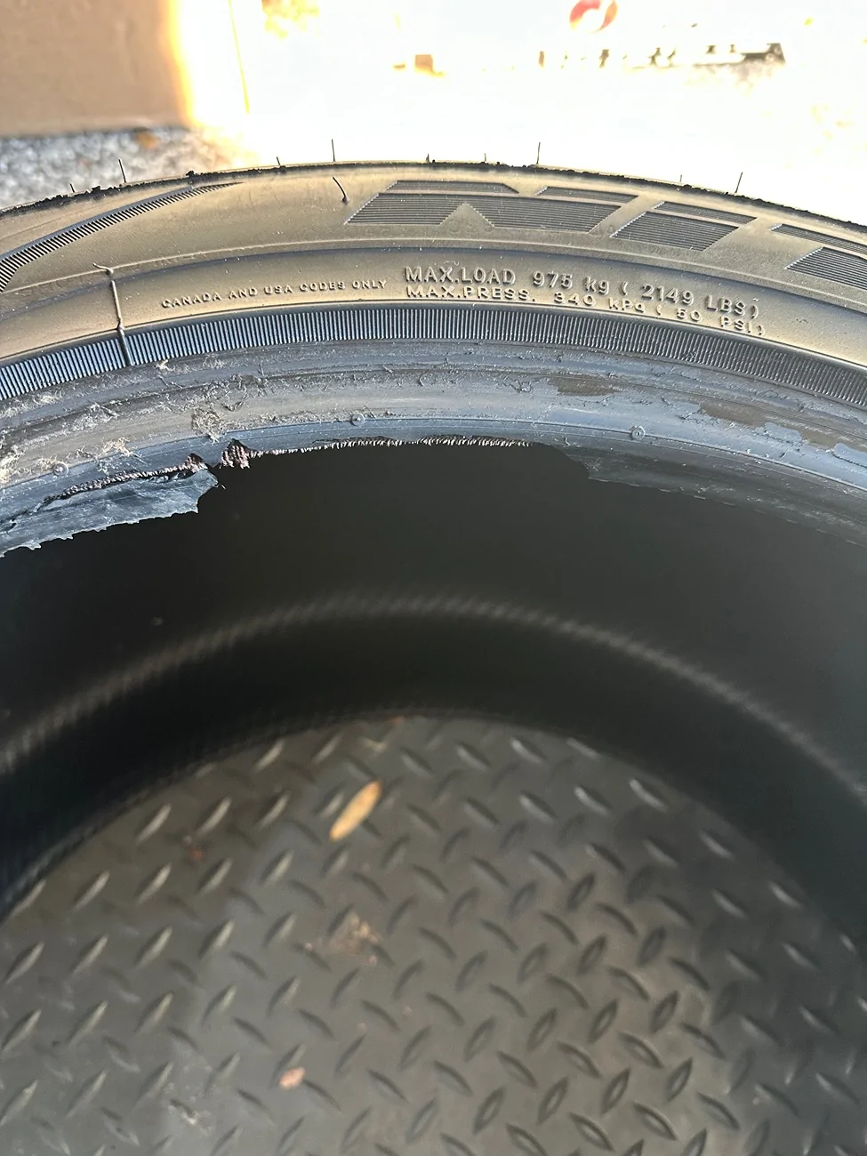

It’s always something……is this an issue?
luc
Mar 25, 2018
2,255
2,588
CA
2017 GT with PP
Yes
Whoever mounted/ dismounted the tire damaged it
Go back to them

Lol
Not usable at all?
I would not. Not only there is a good chance that the tire will not hold pressure but tire has been weakened
And could fail. Not worth it to take that chance
Who did the tire job ?
Local rim and tire shop
