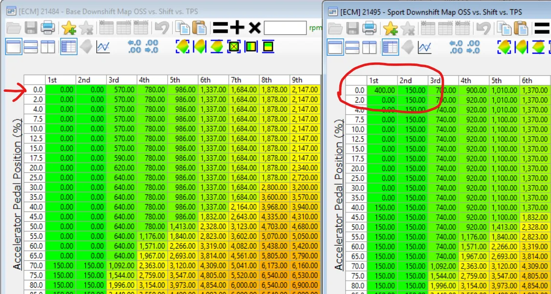

I pulled up a random 2020 Roush Mustang file and checked these tables. The coastdown downshift tables are identical in this file, between sport and normal modes. However, the "normal" downshift tables compare as follows:
Based on this table alone, it wouldn't surprise me to see the behavior you're seeing since it never actually triggers a 2-1 or 3-1 downshift on the sport table. My *guess* is that this downshift is triggered by some other table or parameter that is set up appropriately for sport mode but not normal. There are dozens, maybe hundreds of other possibilities that could initiate this shift in sport but not normal, such as min speeds for downshift, max launch gear, etc.

Actually its the coast down that has the issues. It seems sport mode is pretty much all 0 revs/second (-600 to 0) vs OSS. The way I understand it at whatever the speed change equals vs the drive shaft speed will initiate a downshift. Alot of the sport table has 0 OSS which I assume means a downshift wont happen. At 0 revs/s and 400 oss it will downshift from 2 to 1.
