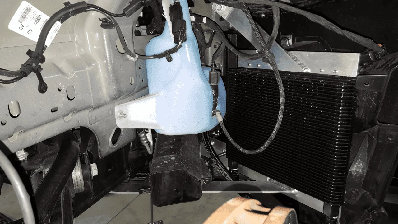

Shelby Omni
are those aluminum brackets?
Yes they are. They are 3/16 thick though, so more than up for the task. We use this same material to make intercooler mounts out of as well which weigh quite a bit more than this cooler and pump.

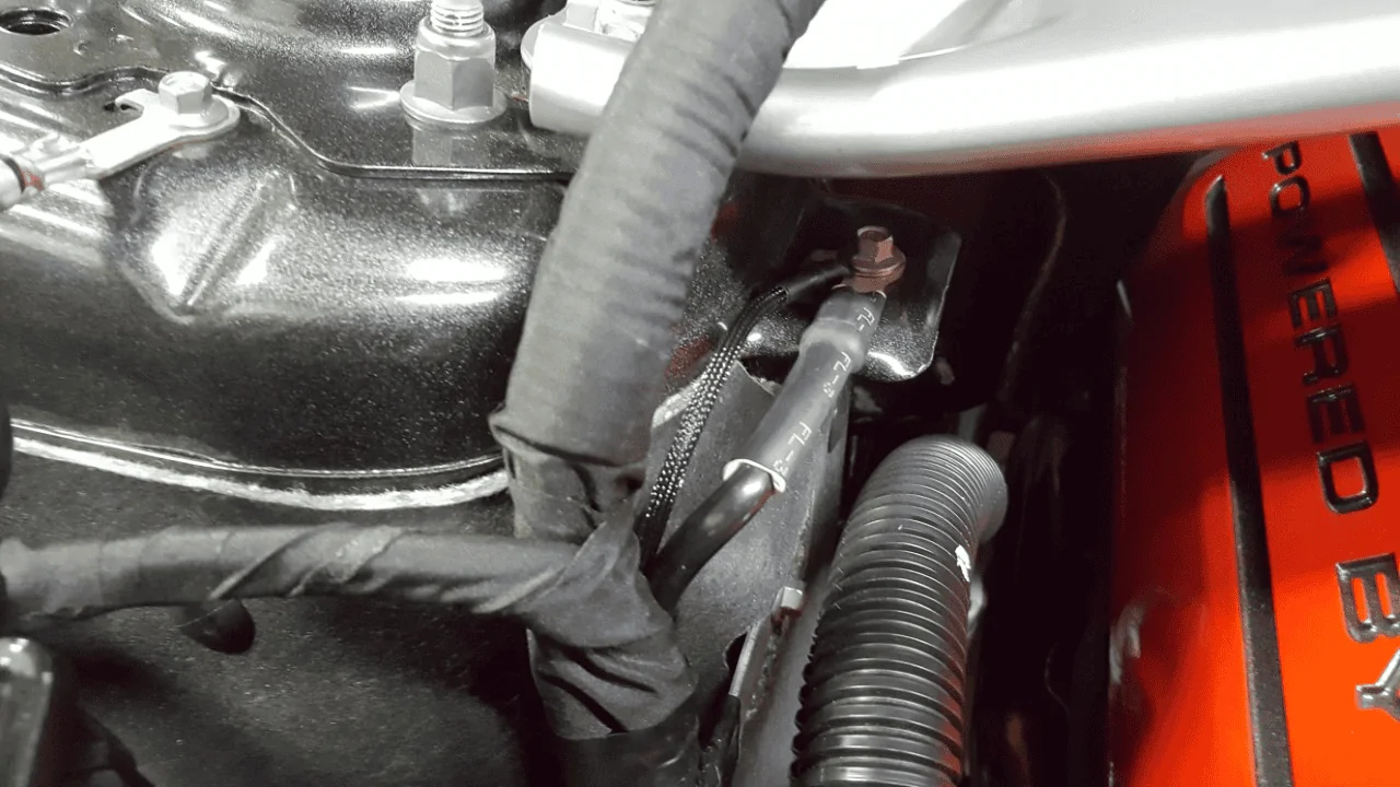

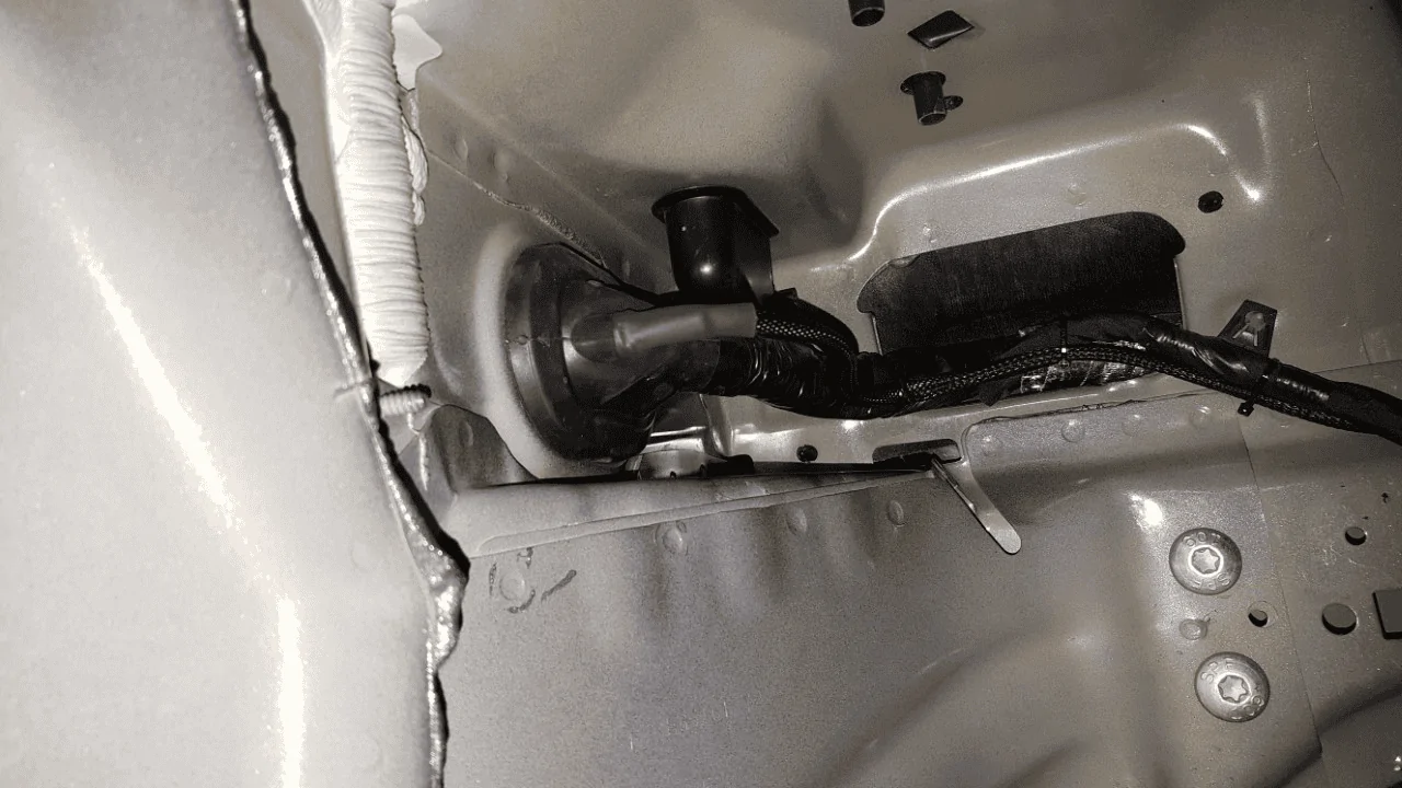

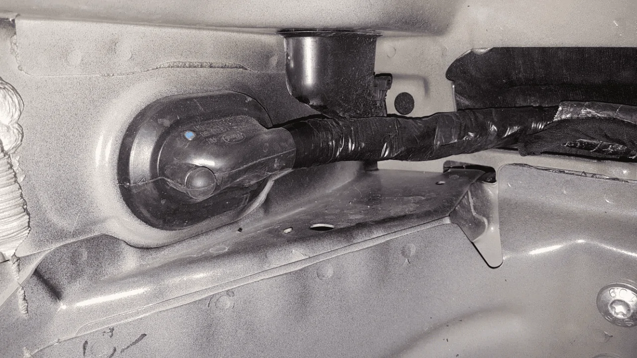

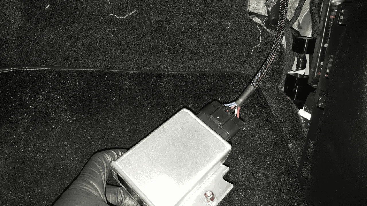

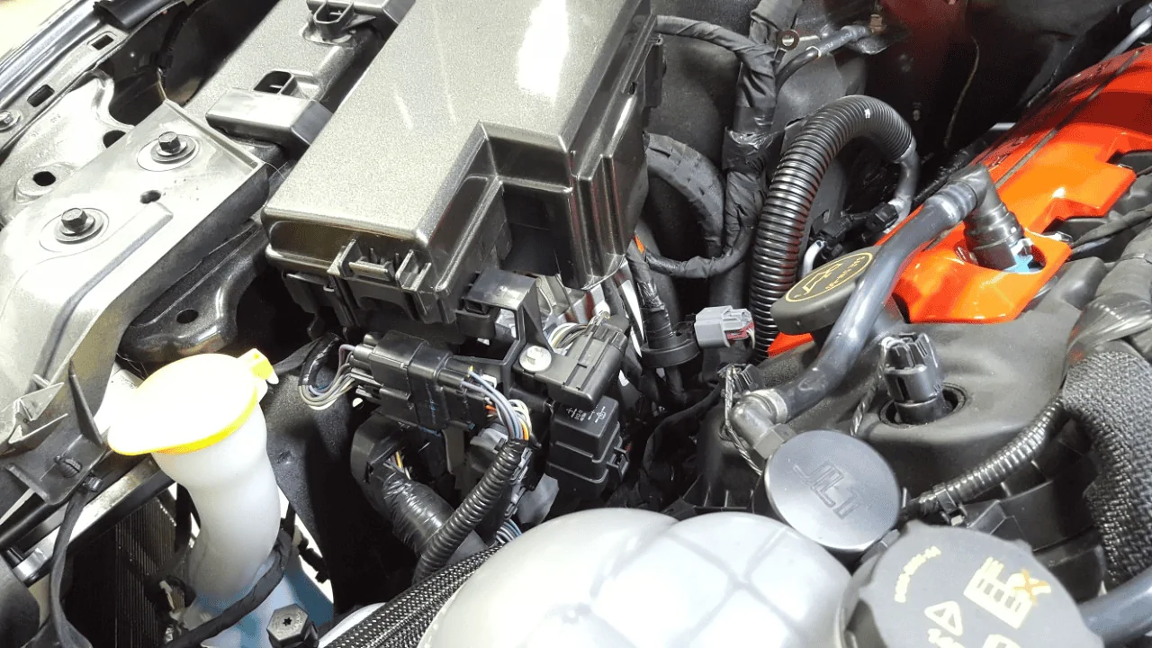

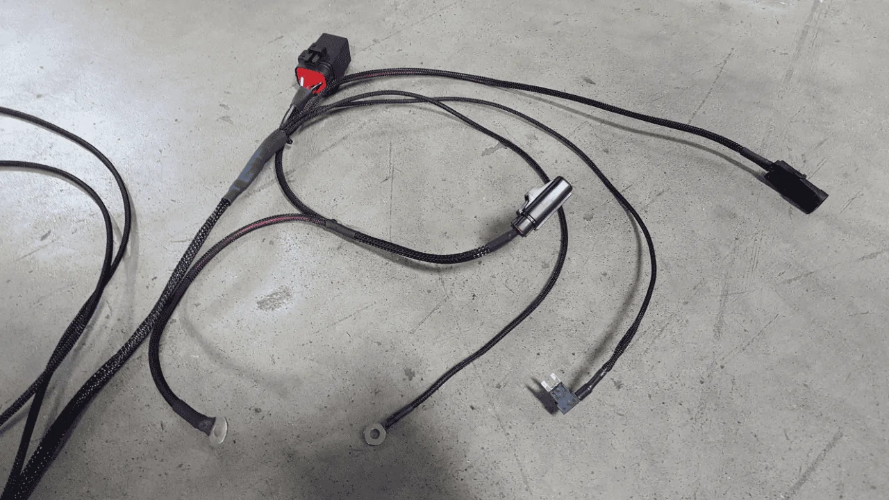

Here are some updated photos..some pics of the wiring..

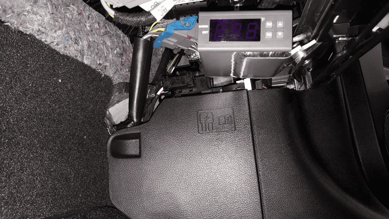

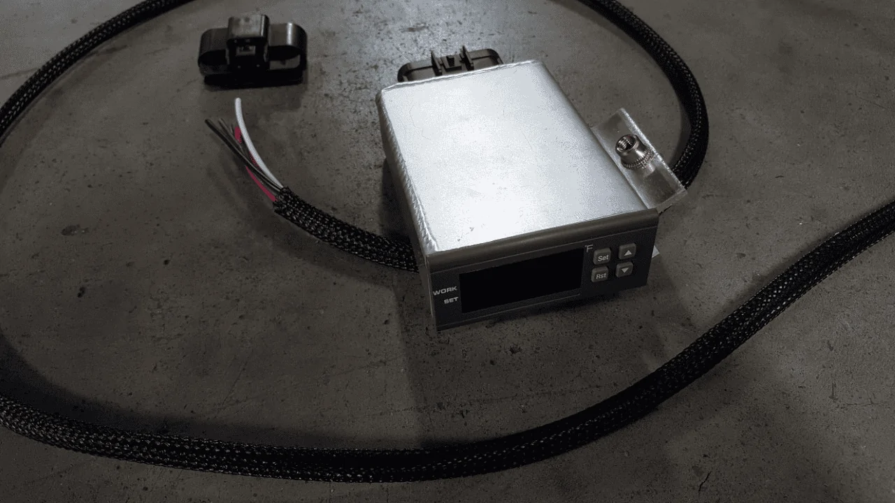

A few more..the box is the thermostatically controlled pump switch..

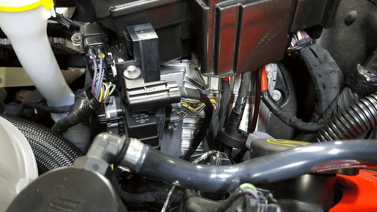

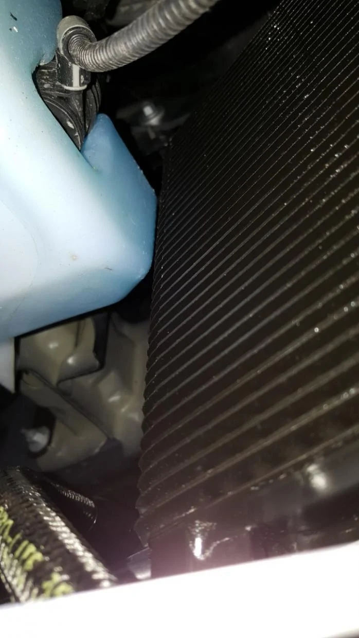

Few more..

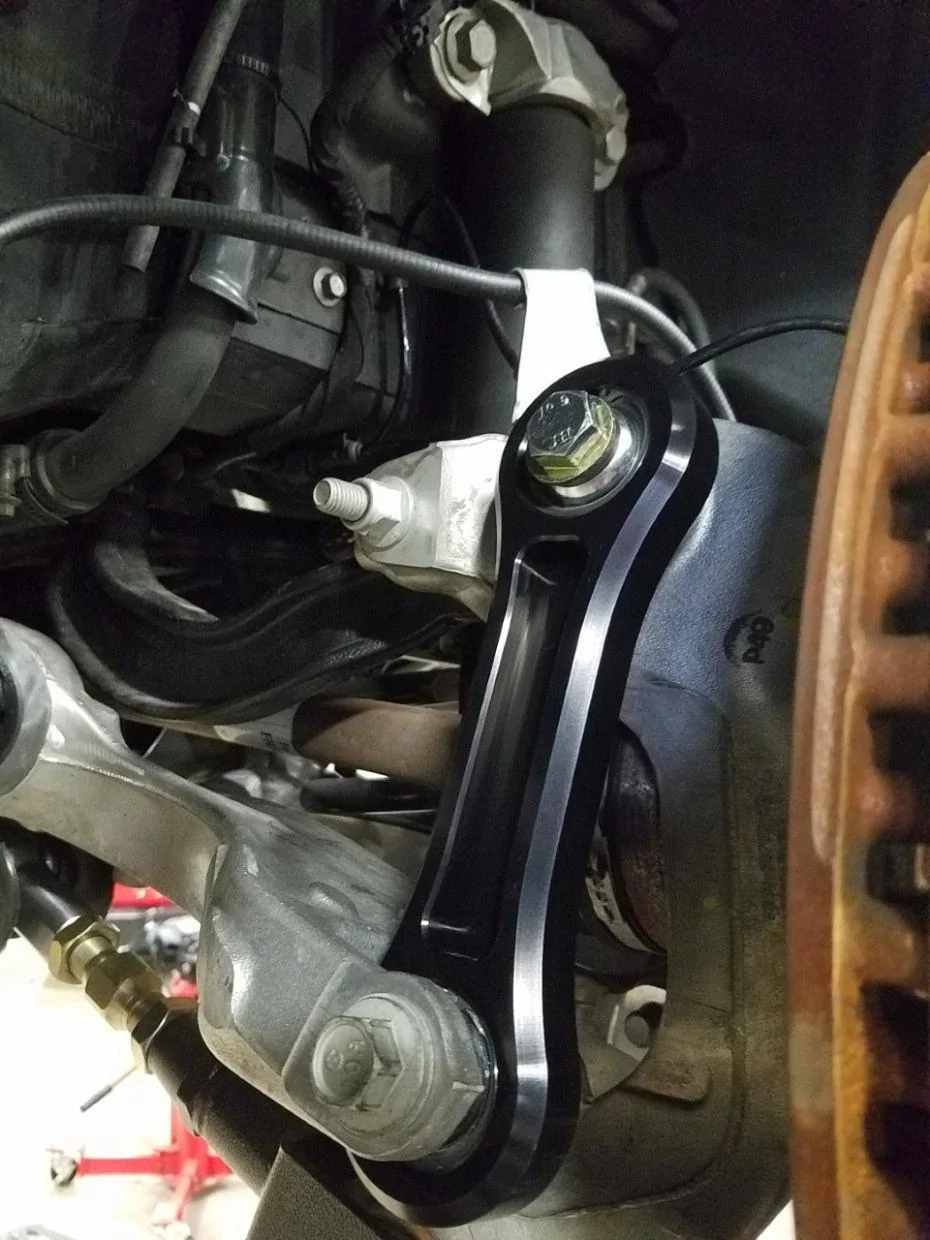

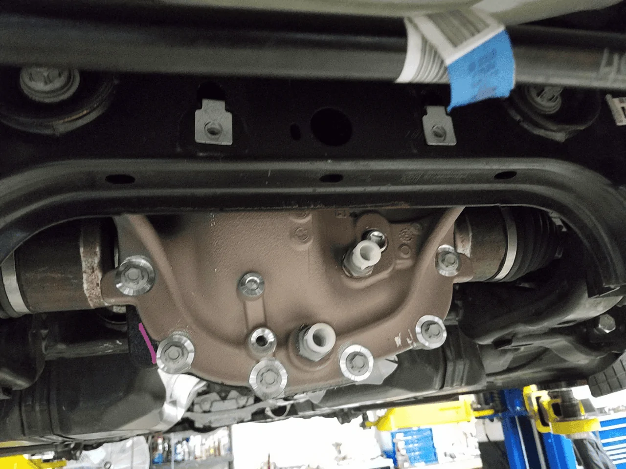

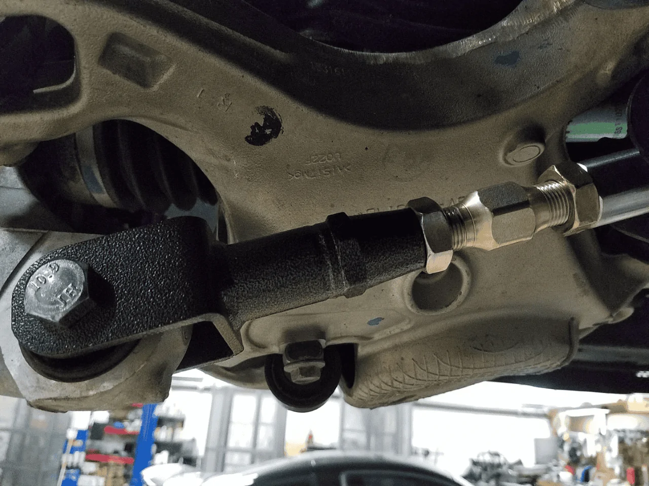

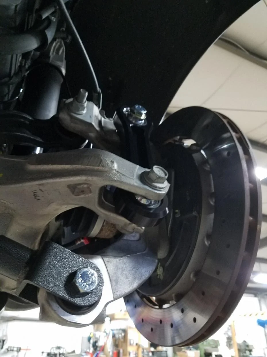

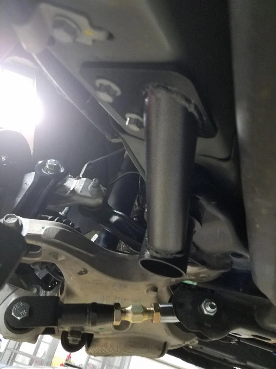

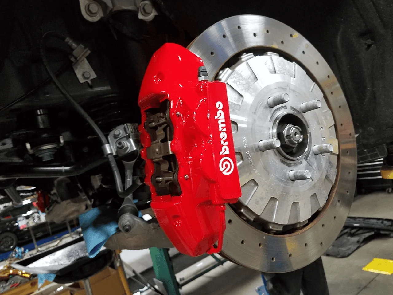

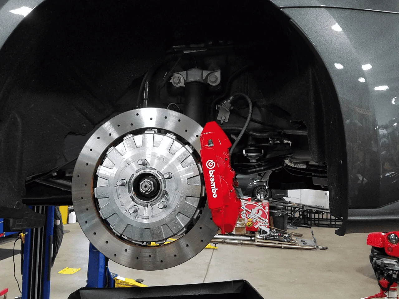

While we are at it...here is some photos of the BMR Craddle Lock out parts going in to help the wheel hop....and some new Calipers.. The last pic is of the Track Pac Diff cover installed..awaiting the diff cooler!

did you need the track pack diff cover? or does the tech pack cover need to be drilled?
TonyJ5150
TonyJ5150
Apr 2, 2016
40
261
237
Indianapolis, IN
2016 Shelby GT350
I think it may be able to be drilled, but I didn't want to take any chances...
