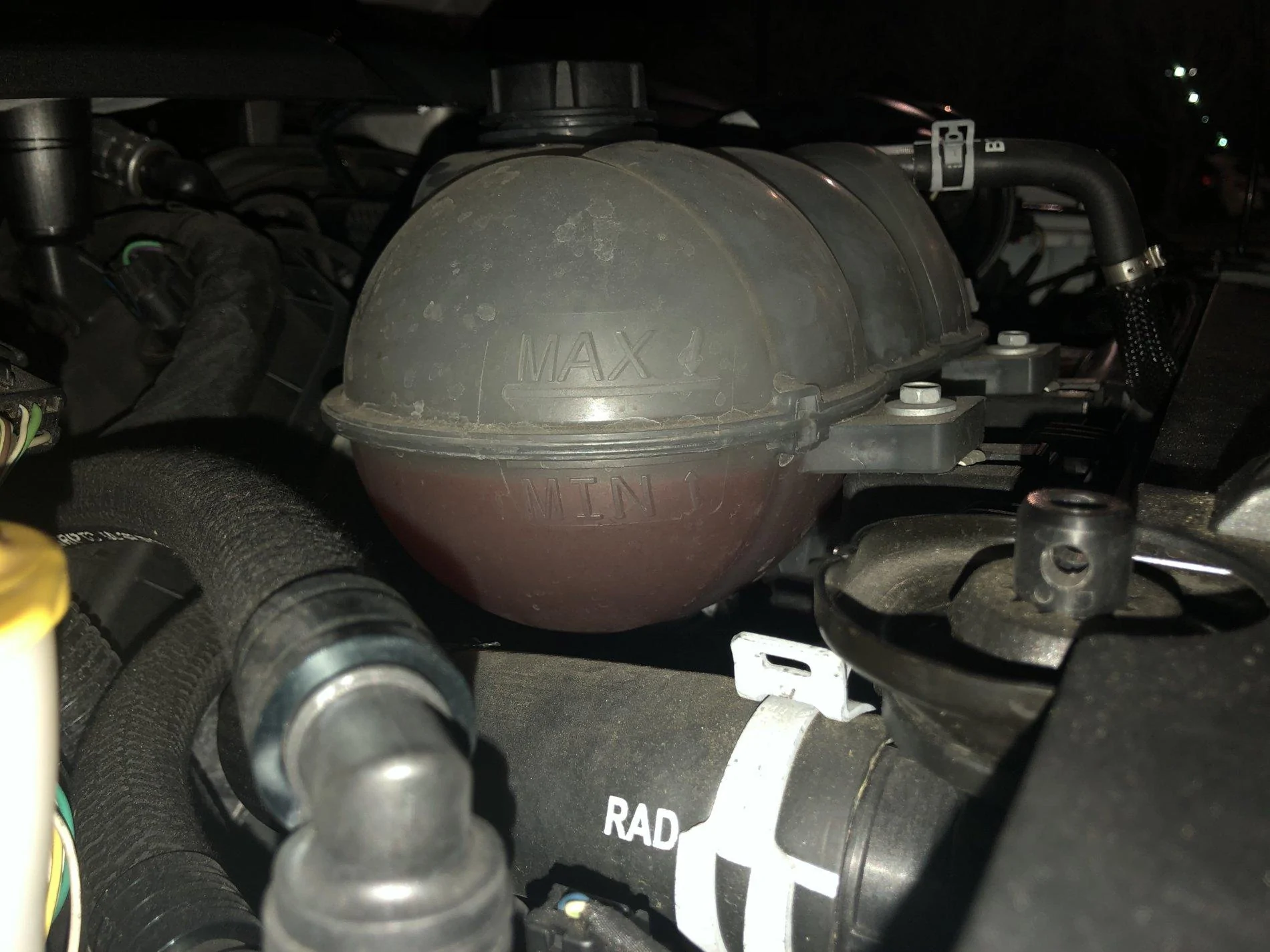

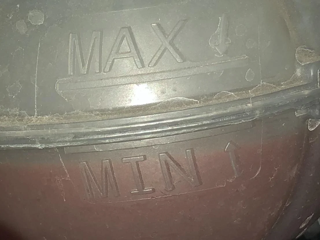

Purchased 2018 gt in January 2019 I never really paid attention to my coolant granted it’s a brand new car I didn’t think I had to honestly but the other night with a relatively cold motor “car had been sitting almost 6 hours” I took notice to my coolant level being slightly below the minimum line I haven’t noticed any issues with my car never smelled anything out the ordinary but truth be told I never really remember seeing the overflow tank full of coolant the few times I did look under my hood is it possible it just got a low fill from factory? And no telling how long I have been driving like this but is there any harm that could have been done granted it’s below the “min” line? I plan to go to the dealer in the morning and pick up the 50/50 prediluted mix and fill it up to the “min” line Car has just shy of 7,000 miles now

That small amount below the min line will not cause any issues. Mine was the same way when I took delivery. Use the pre-diluted orange antifreeze and fill it to a point between the lines and then use that point as a reference for future checks.

Ok great thank you and if it drops again I need to take it to dealer correct?

If it drops a lot, yes. Over time (months), it may very slowly drop a little, but this is normal for the most part. In every car I have owned, I have always had to add a bit every year or so. I would think my Mustang would be no different.
Keep in mind that outside temp can have a slight impact on the level. On a very cold day, it might be slightly lower that it would on a hot day, all else being equal.

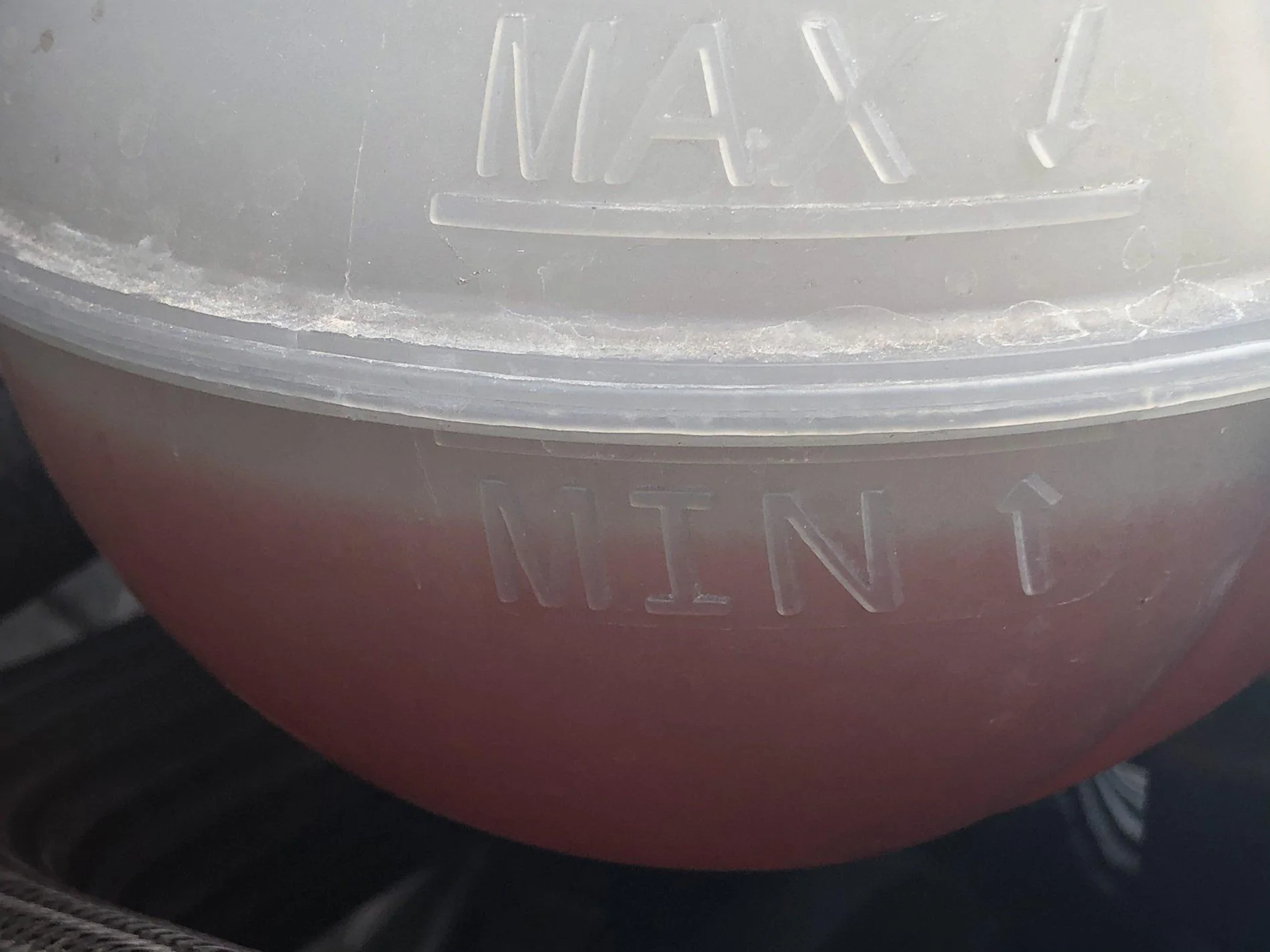

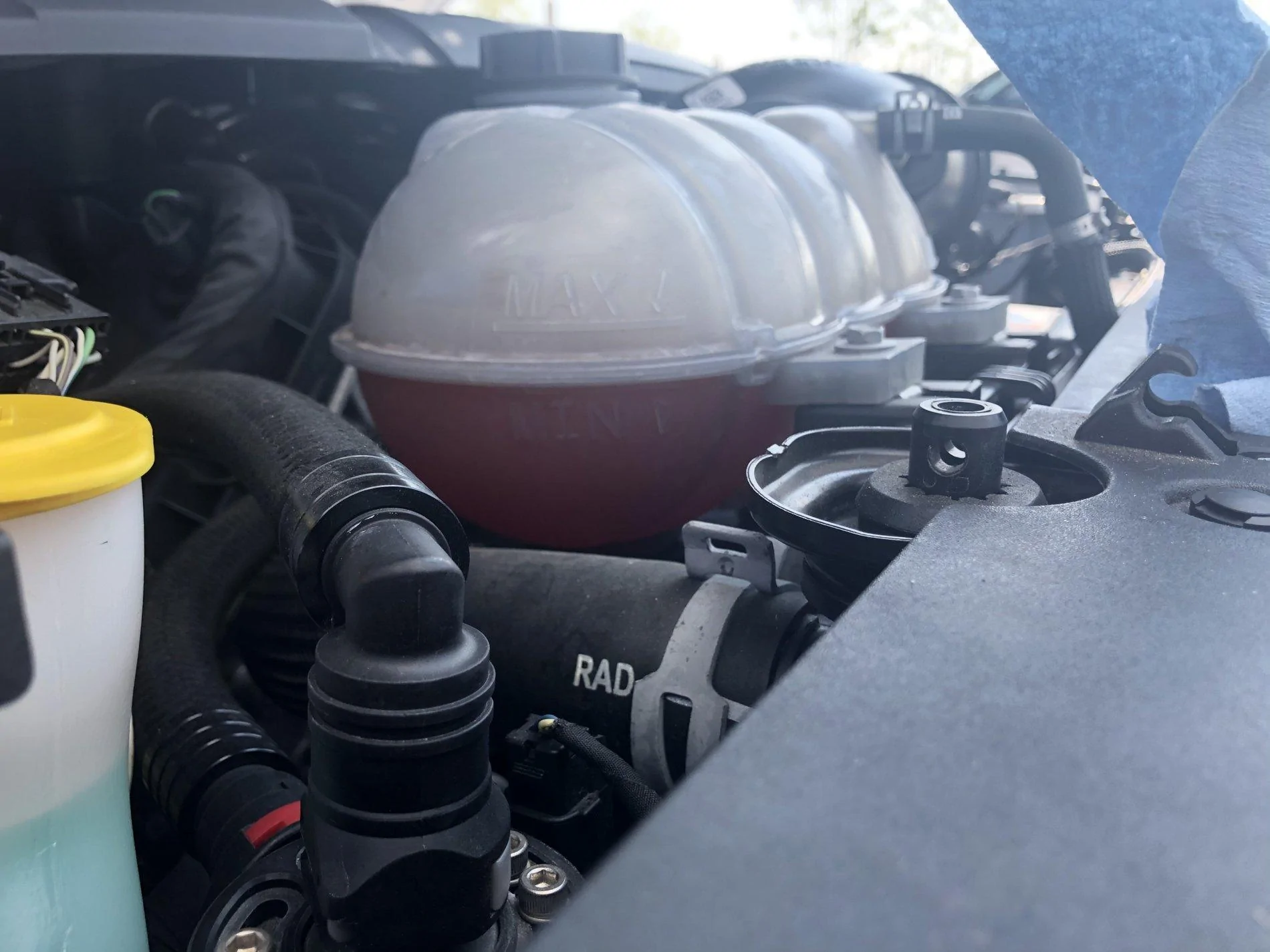

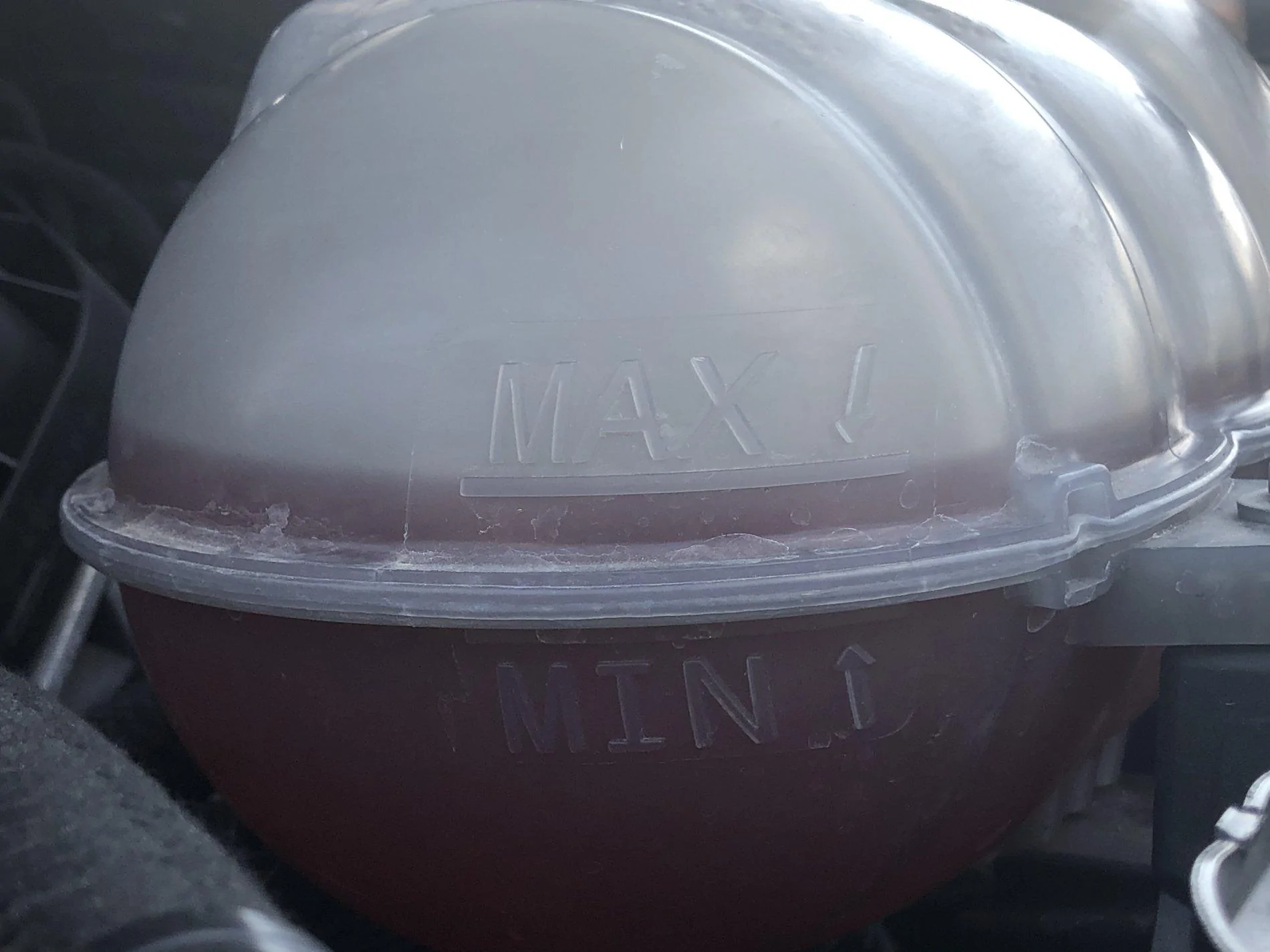

Welp verdict is I think something is wrong I came out to my car this morning I didn’t drive it and coolant seems to have moved quite a bit I showed where it was when I left for my trip where it was this morning and then I filled it up to where it currently sits

Just took a short drive I got out head temp was at 203 and car was warm

I updated my post and without even doing a cold fill I think I may have a slight problem coolant seems to have dropped from initial level before I took my first drive

So you added coolant when the engine was completely cold, then checked it a day or two later without ever driving it and the level dropped?
If the level is dropping while the car just sits without ever running than take a flashlight and look around in the engine compartment for any signs of coolant leakage.
