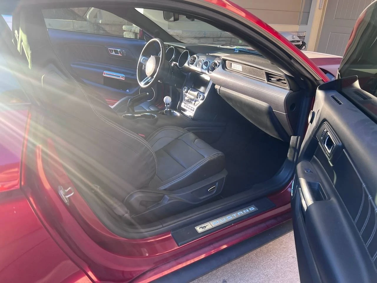

I also swapped in a nicer version of the center console with soft touch surfaces and white stitching from the mach 1, so everything is a lot nicer inside!

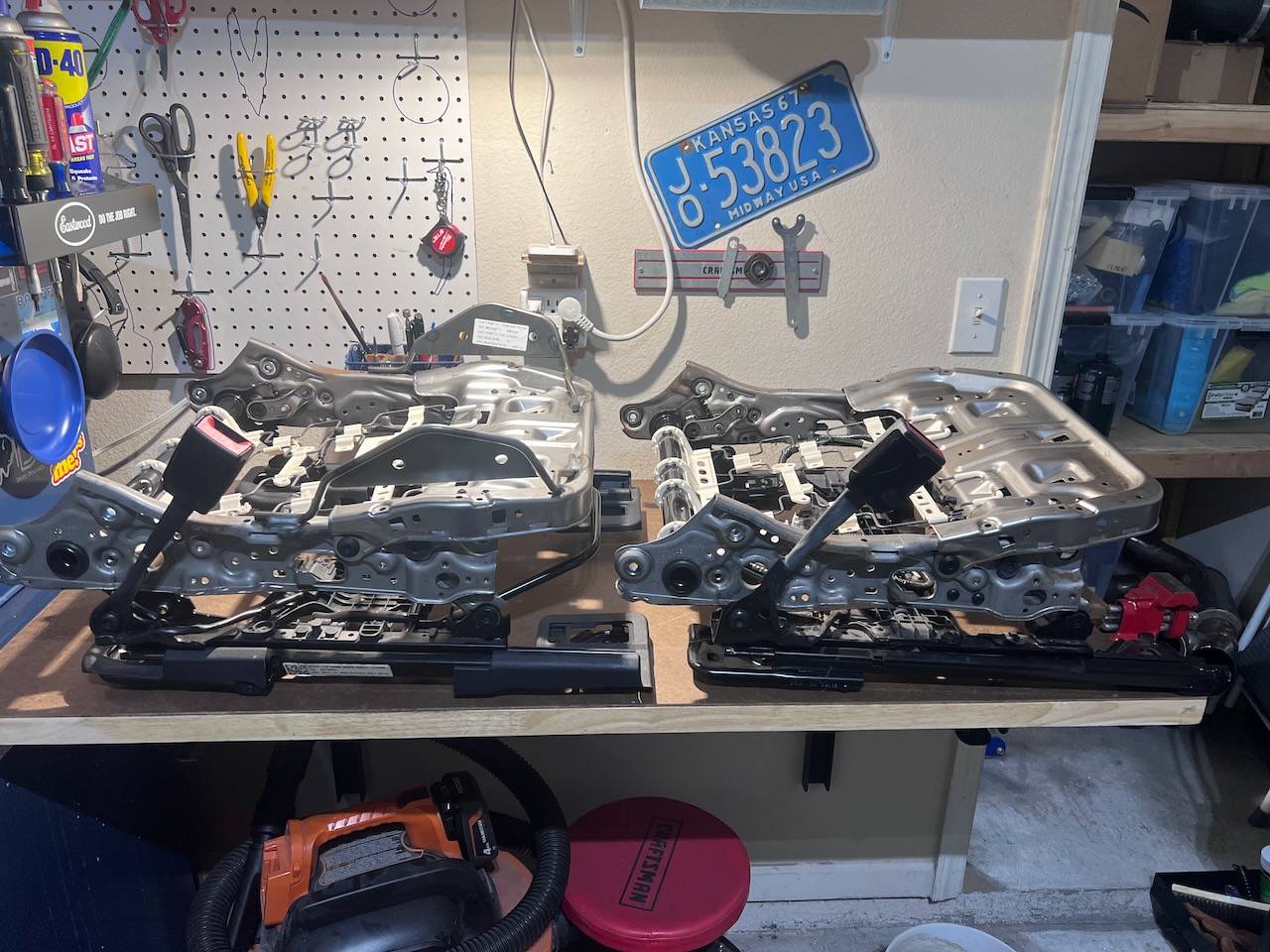

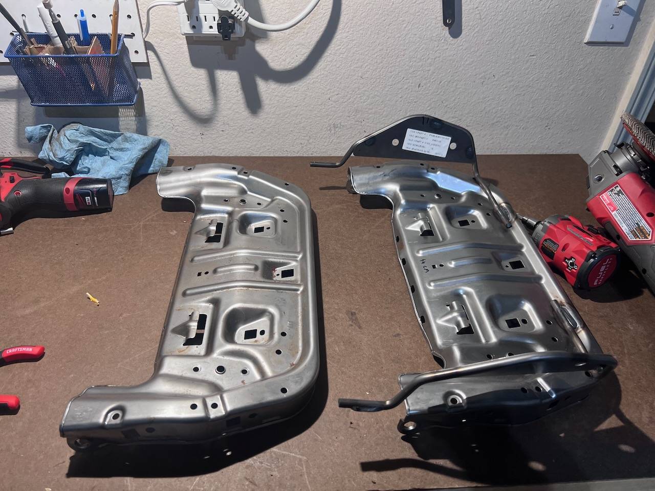

Recaro base left, power base right. As you can see, they're almost identical. All we need to do is transfer the plate on the front of the seat that has the bolster support brackets from the Recaro base to the power base.

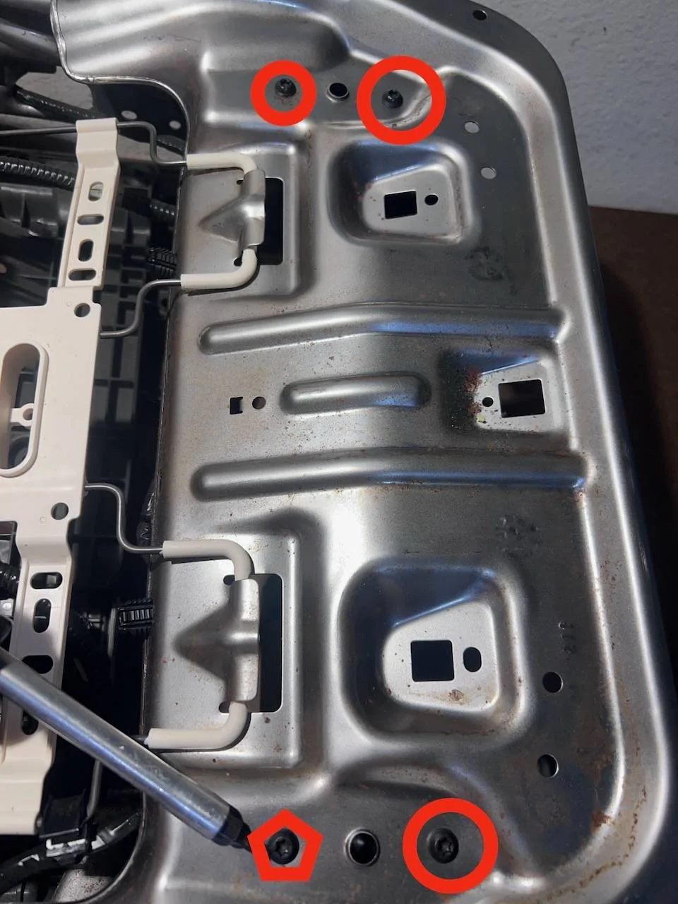

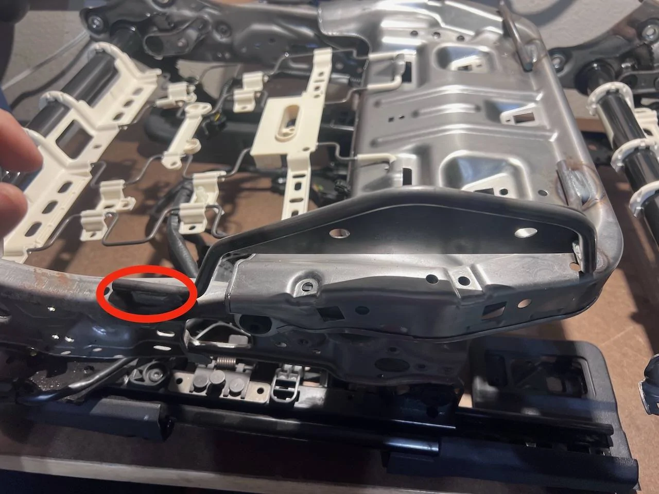

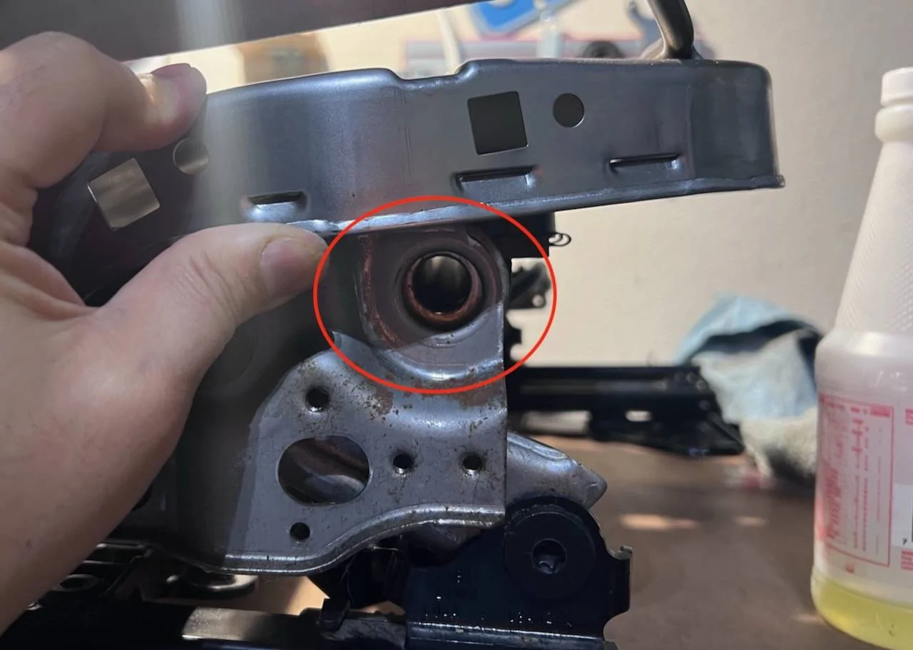

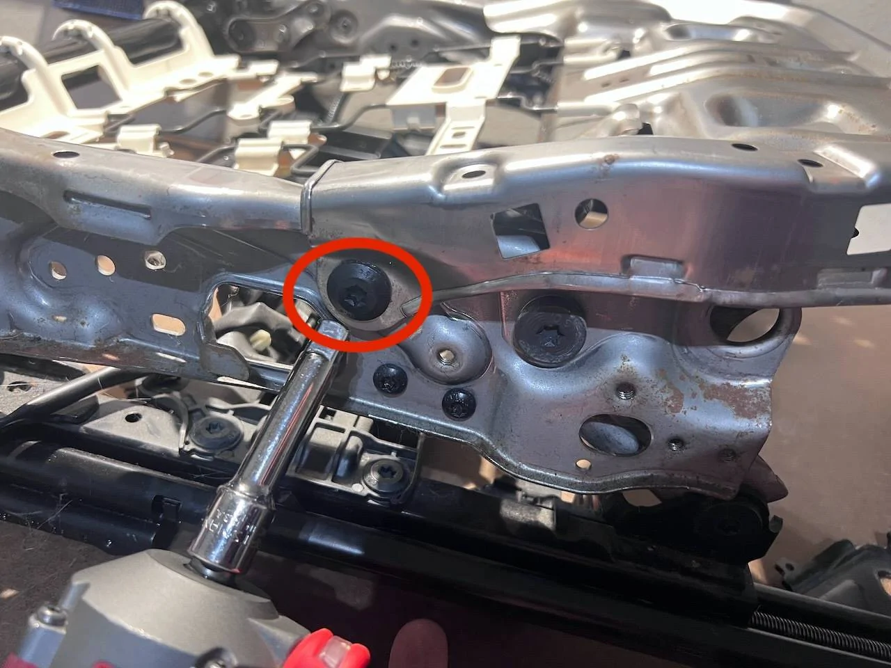

Start by removing the plate from the power base by undoing these fasteners. This is the part that pivots and lets you raise/lower the front of the seat. Note that you will lose this feature.
You can now remove these brackets that were held on by the screws at the top:

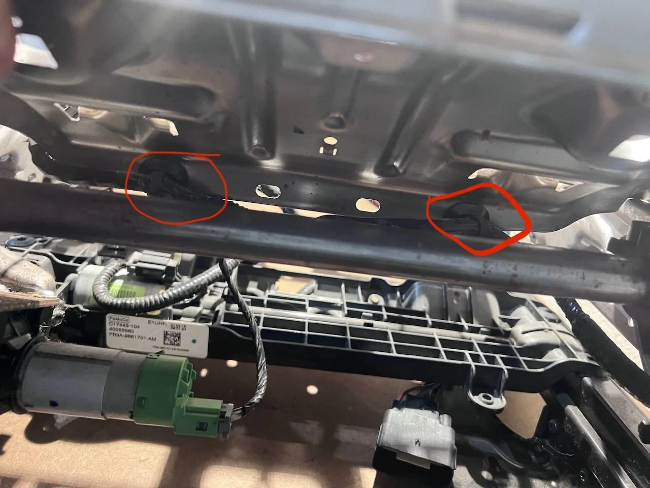

Remove the wiring harness from the bottom of the plate, it's just held in place by some christmas tree fasteners. The plate should now be free, unhook it from the top and pull it off.

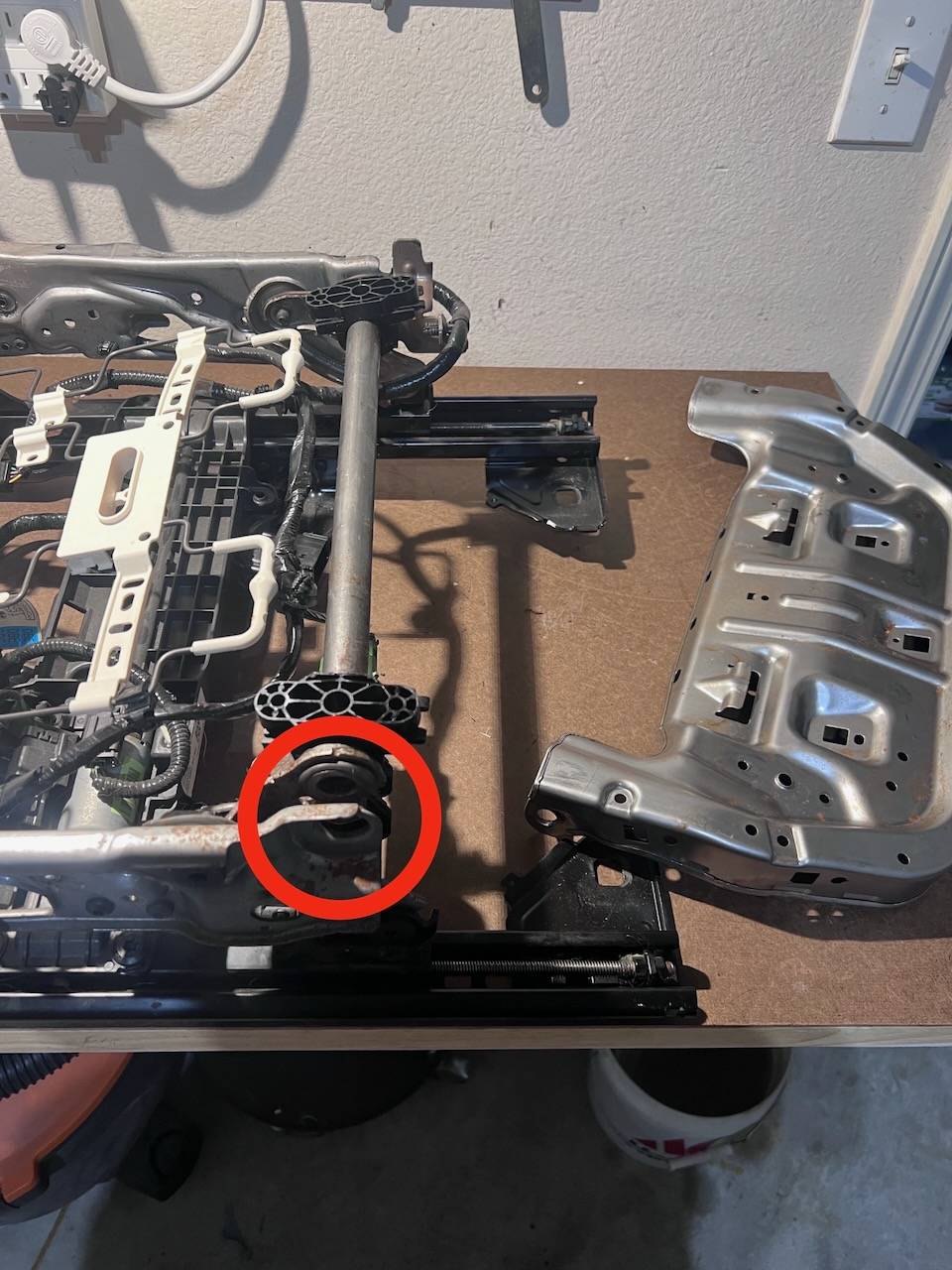

Next, we need to adjust the tilt mechanism so that the recaro front plate sits in the same position that it did in the Recaro seats. This is achieved when the hole in the frame aligns with the hole in the tube:
Temporarily plug in the power seat controls into the base, and take the base to the car. Plug in the main connector on the bottom of the seat and adjust the tilt up/down till the view from the side looks like this:

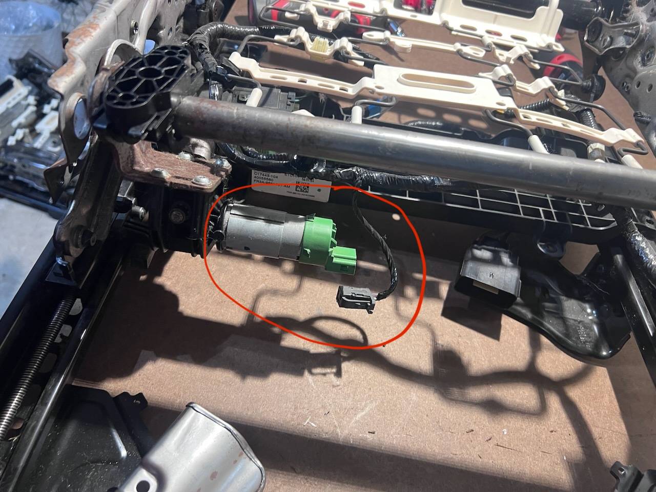

We can now disable the tilt mechanism. Unplug the connector from the tilt motor and zip tie it safely out of the way:

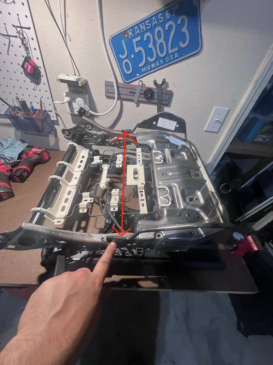

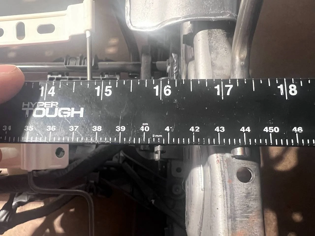

Measure and record the side to side distance between the ends of the support brackets:
On my seat, this measurement was almost exactly 17 1/4" or 44 cm:

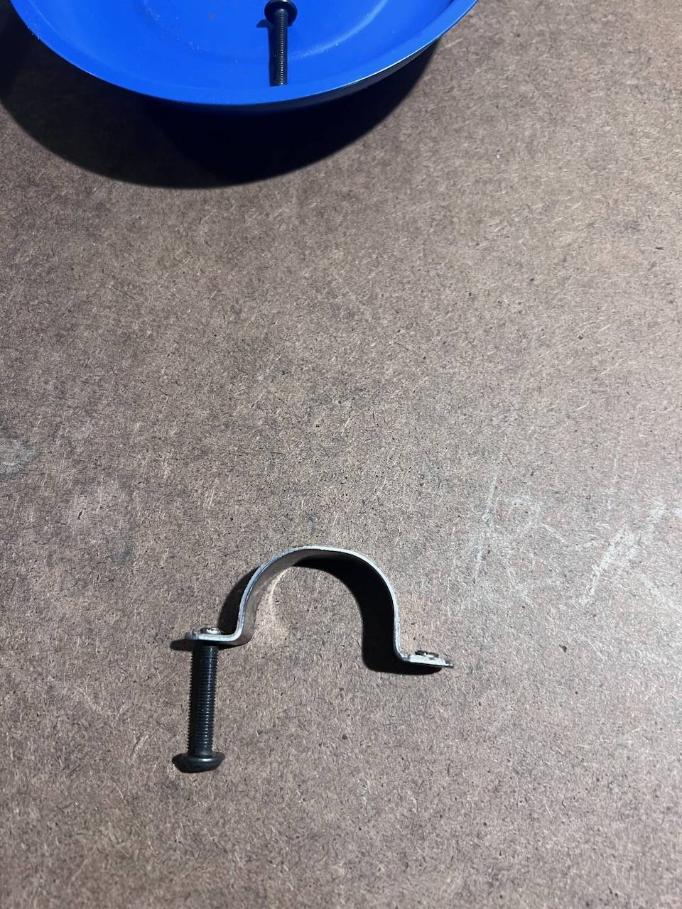

Adjust the distance between the ends of the bolster support brackets until the distance between them matches the measurement you took earlier. I used clamps to hold the ends at the correct distance.

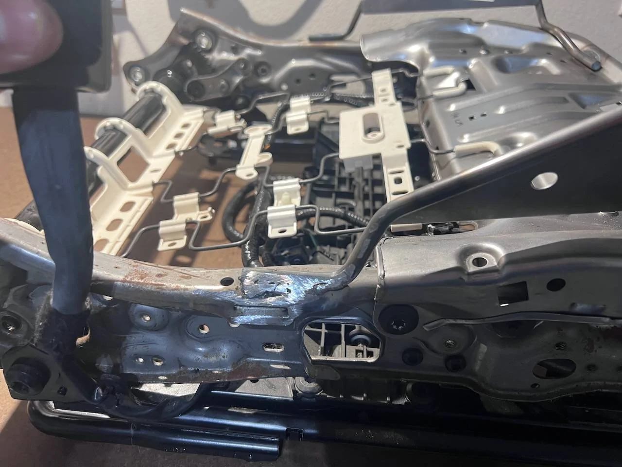

Once you're satisfied with your measurements, weld the ends of the bolster brackets down to the seat base (please excuse my crappy welds, I've never welded before lol) Alternatively, you might be able to drill a couple of small holes through the ends of the brackets and attach them to the seat base with small nuts and bolts or pop rivets.

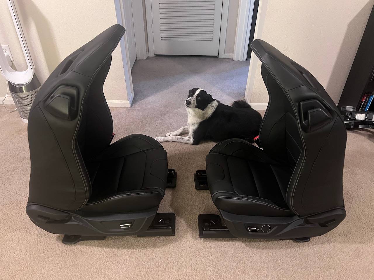

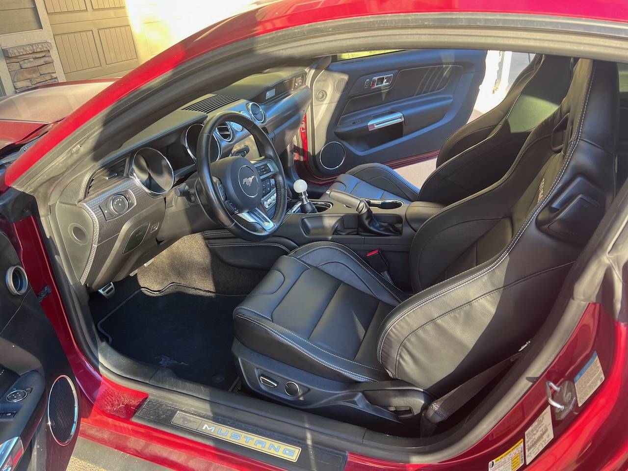

That's pretty much it. Reassemble the Recaro seats with the side panel from the donor seat that has the switches and you should be all set.

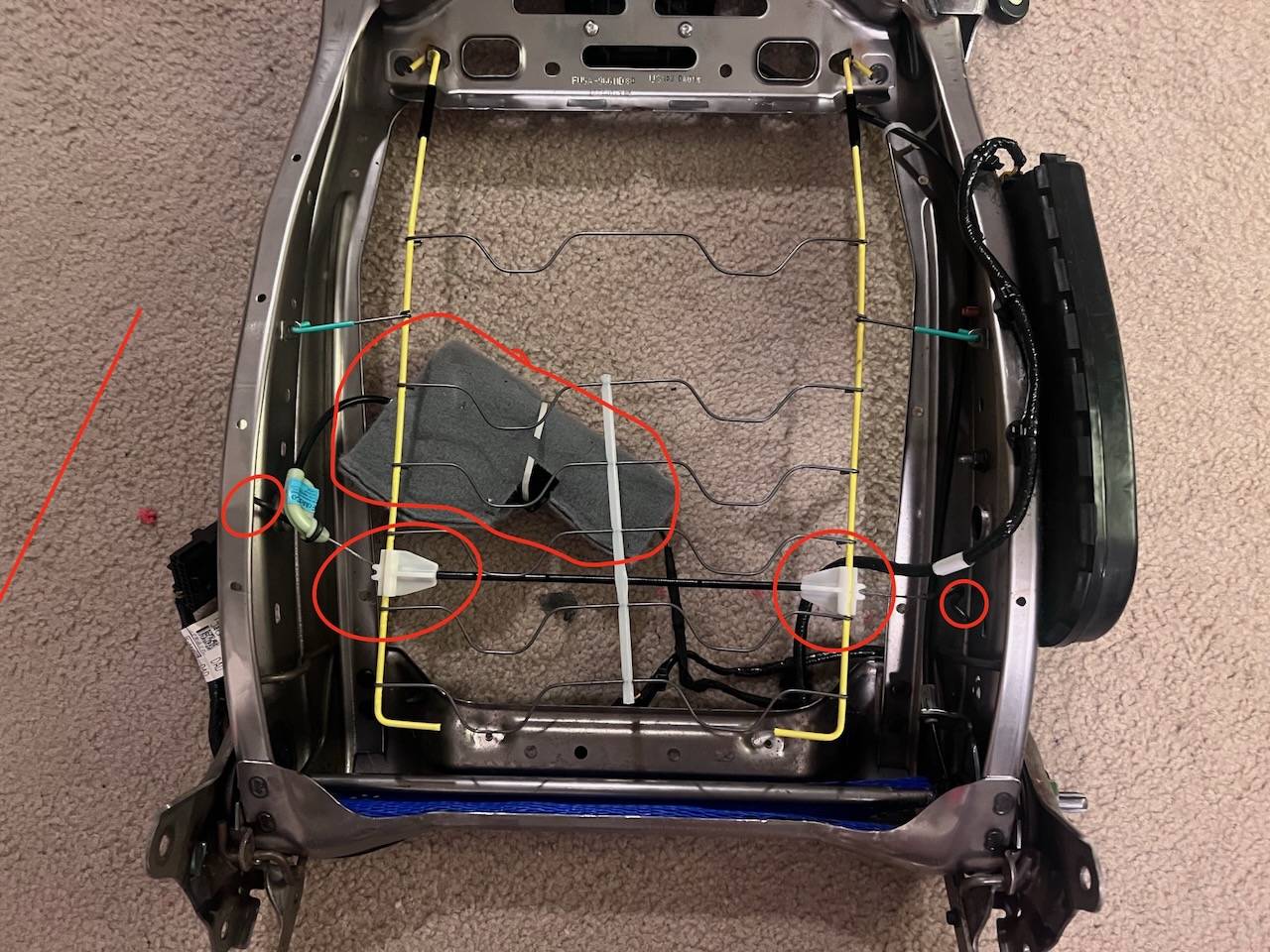

If you want power lumbar, you will also have to take the seat backs apart. From your power seat, pry off the white parts off the yellow rods and unhook the cable ends from the sides of the seat. Next, cut the zip tie that holds the lumbar motor in place (the circled gray object) Disconnect the wire from the motor and the whole lumbar assembly will come off the seat.
Transfer it over to the recaro seatback and attach everything the way it was attached originally.
The Recaro seats will not have the lumbar wiring, so take the whole wiring harness off the donor seat. Remove the existing recaro harness and attach the donor harness.
This is the only picture that I have unfortunately, but it's pretty easy to figure out once you have the seat apart.

Next, move on to the Recaro base. The plate for this seat comes off in exactly the same way as the power base, but the added complication is that the bolster support brackets are welded to the seat frame in the back:
