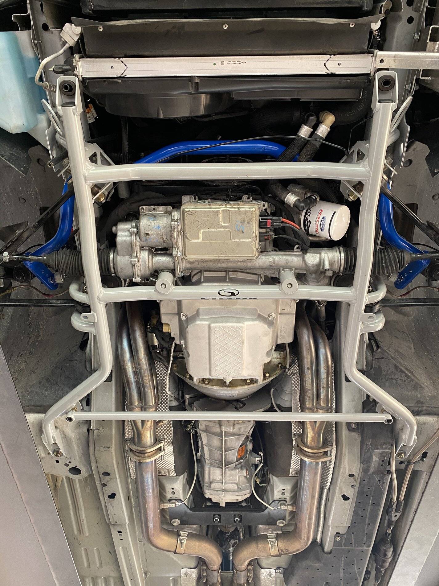

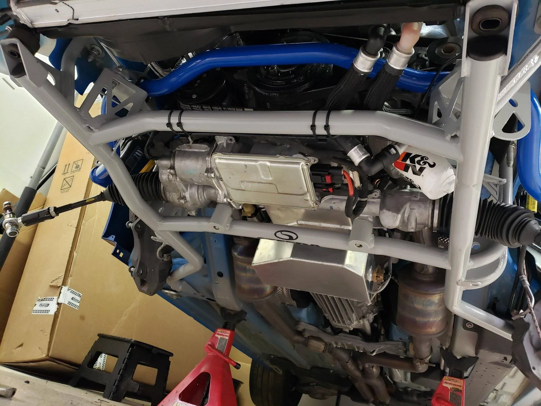

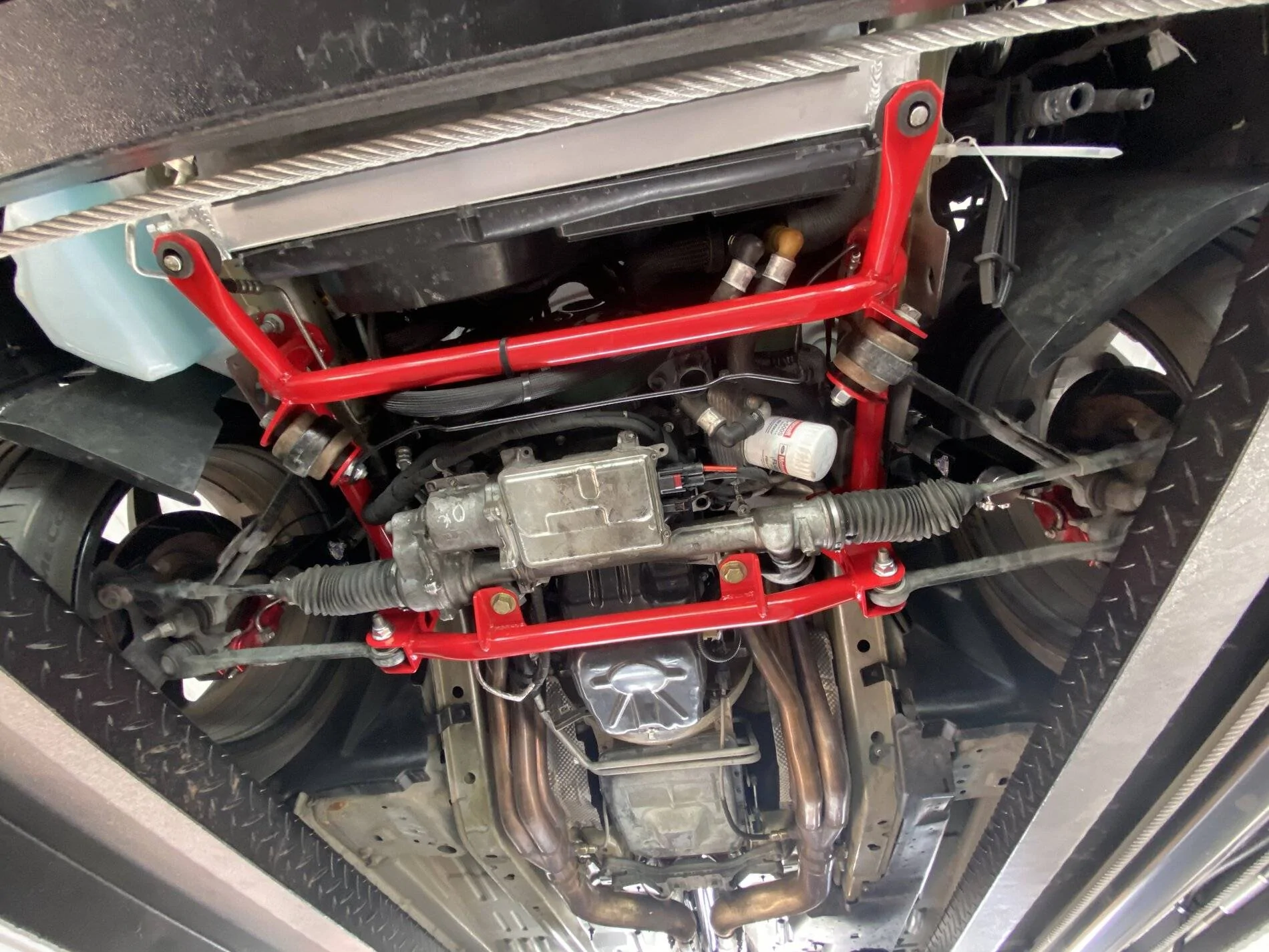

I’ve installed both. I have the Steeda road race version (love it) on my car and put the BMR drag version on another car. The BMR owner has a Hellhorse mid twin turbo kit coming and I’ll be putting that in as well so we will see how that goes. Per Steeda, I was told the only difference between their road race and drag version is extra gusset strengthening and the rear crossbar for lateral strength. Both Steeda types have provisions for a front sway bar but the BMR one does not which you may not care about being a drag car. The BMR owner here still drives on street with no adverse handling effects but has other upgraded suspension. Other factors that may concern you is that the Steeda k-members can still use oem motor mounts among other aftermarket setups and the BMR one comes with their own style of mounts that allow you to keep stock height or lower some. The BMR mounts will increase NVH as they are a higher density. Any other questions, don’t hesitate to reach out.
Mine....
His.....
