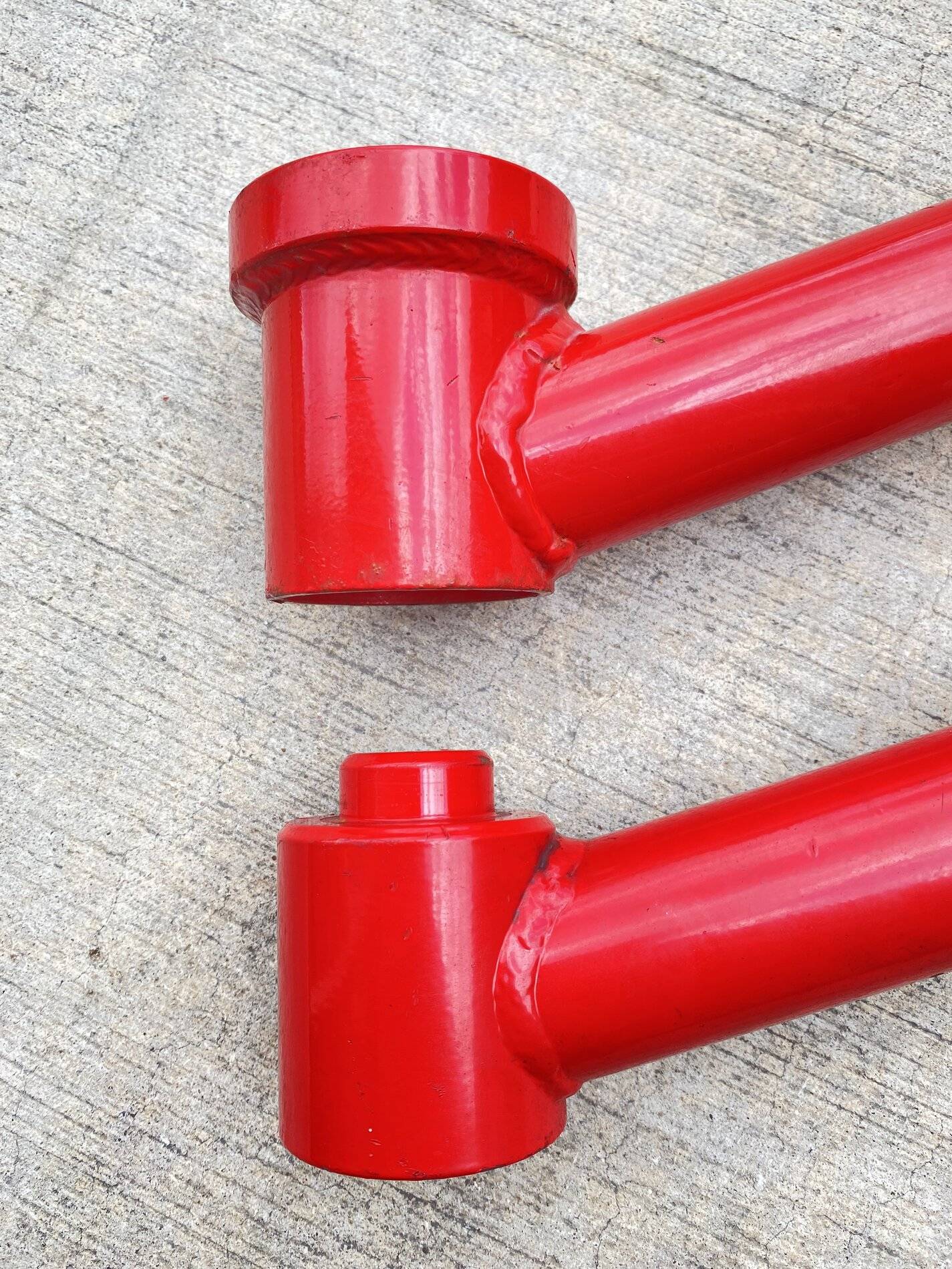

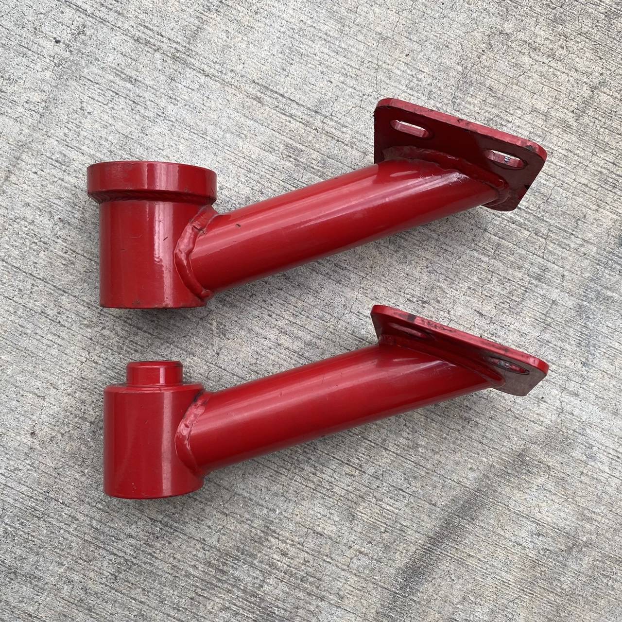

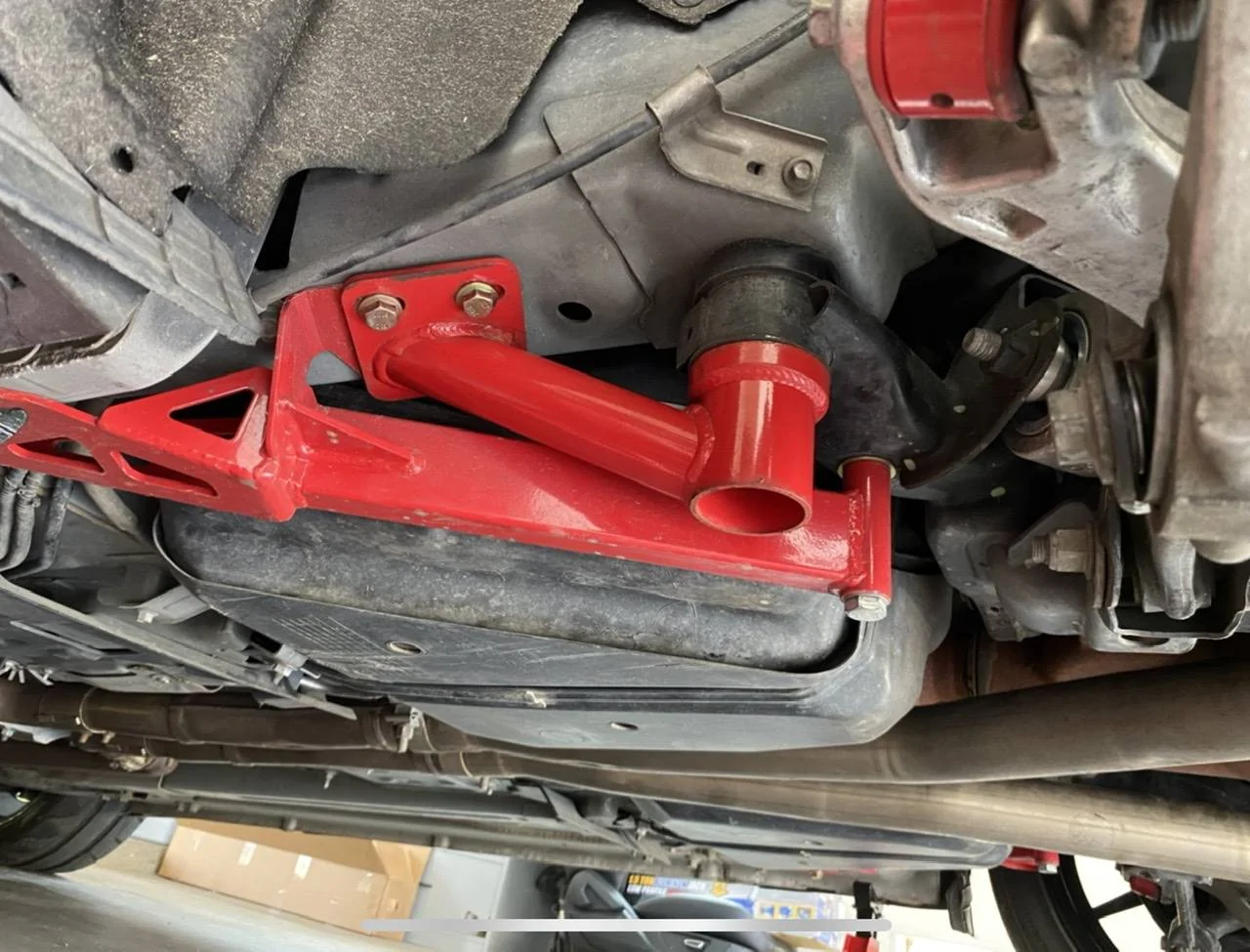

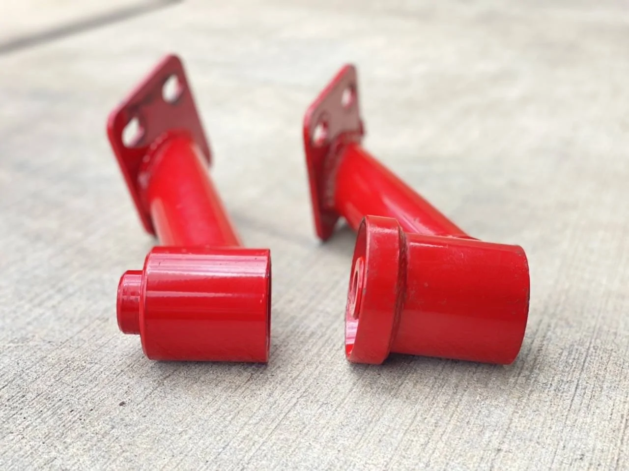

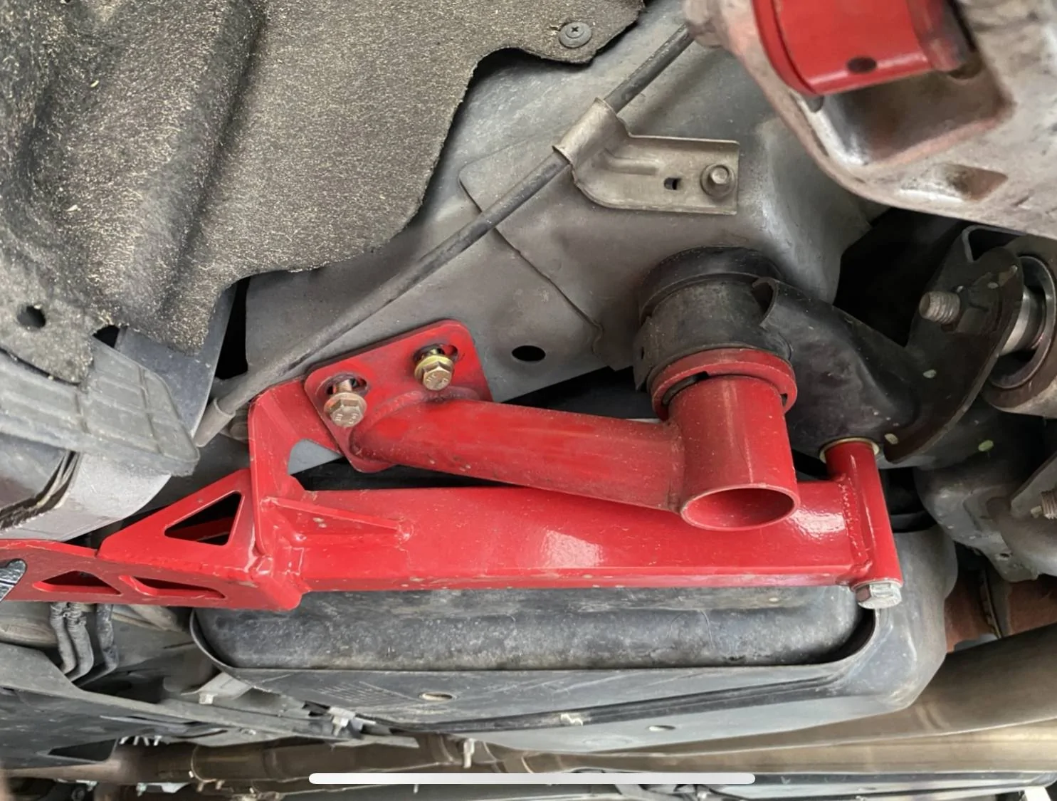

In looking at pictures of the CB005 from different sellers, there seems to be an older and a newer version of BMR’s CB005 lockout.
I’m cheap. Naturally, I ended up with a used, older version of BMR’s CB005. Used it for about 3 months with no issue.
Last month, I bought a group of parts that happened to include the new version of the BK055 lockout. I was curious about the differences, and I hadn’t seen a side-by-side comparison here, so please see below if you’re curious.
I didn’t notice a big difference between the results. Maybe slight - but nothing you would really notice on the street. No difference in NVH. I do like the look of the newer lockout and it seems like a more stable method of controlling the subframe.
I didn’t notice a big difference between the results. Maybe slight - but nothing you would really notice on the street. No difference in NVH. I do like the look of the newer lockout and it seems like a more stable method of controlling the subframe. Build quality is the same between both.

That part actually doesn't serve much purpose compared to just a spacer to fill the gap below the bushing. Heck, you could stack washers to fill the void and it would work as well. Lol. It is nice to have the lug that goes inside the bushing sleeve to assist in squaring the subframe. Its also very convenient to use as a jacking point.
The reason for the redesign is that Steeda filed a patent infringement lawsuit over that washer design. Lol....... Yea. They're that petty.

BMR needs to send their welder back to school.
