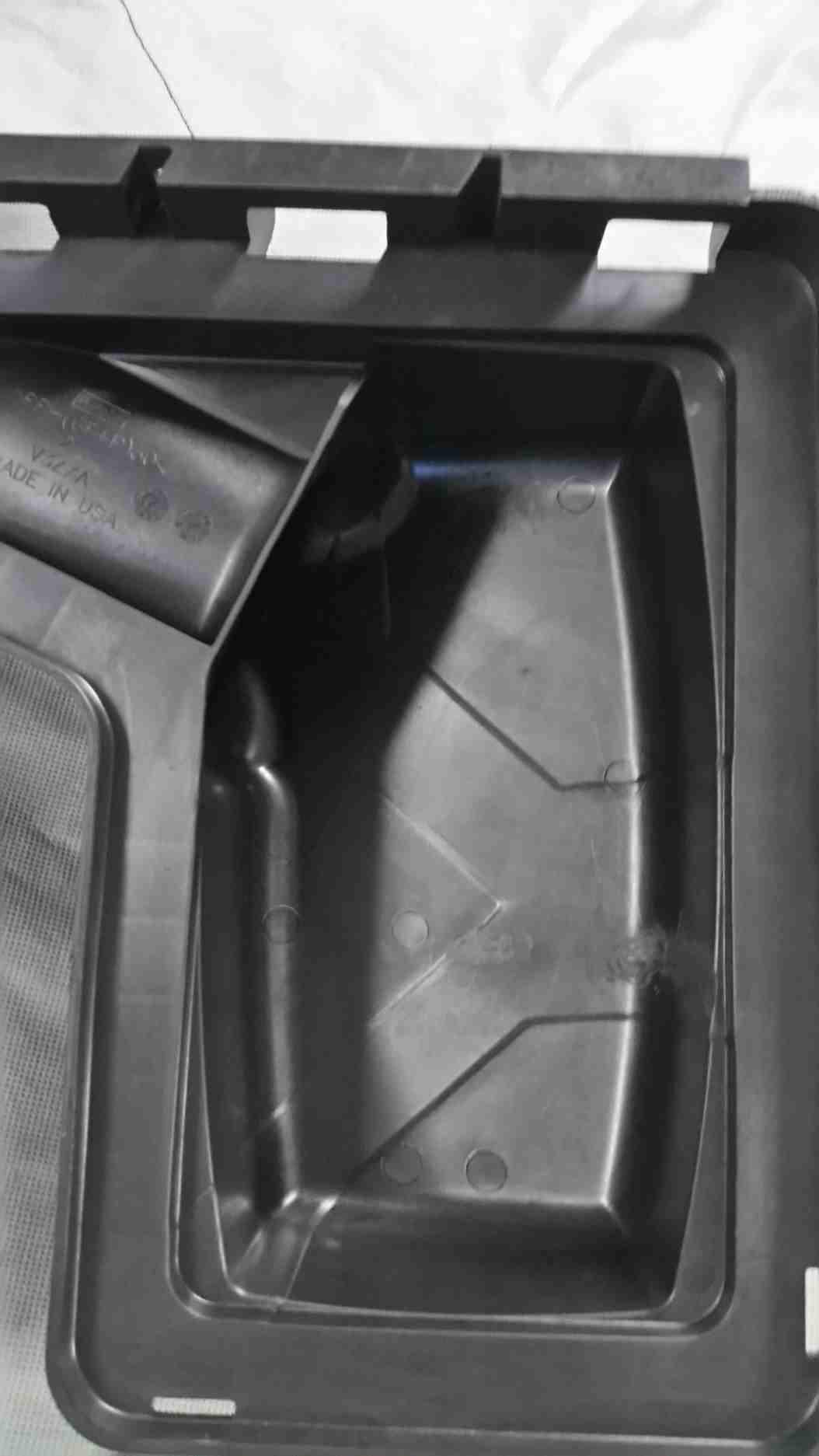

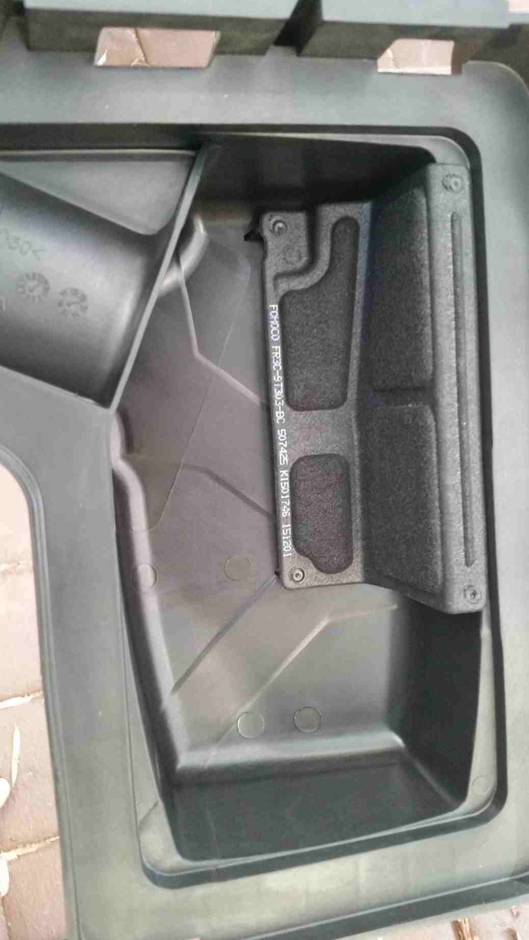

As for me I'm going to get an Airaid tube to replace the convoluted stocker, take the carbon thingy out of the airbox, open up the grille, and fit a Velossa Big Mouth when I can get one. And save the money for some axle backs and a tune.

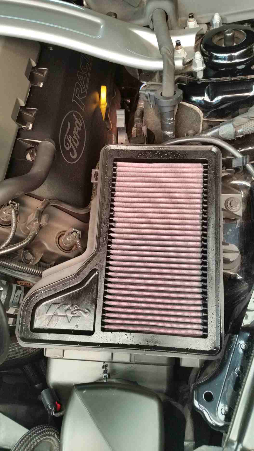

Yeah great read. Im starting to think i will just buy a new k&n filter and modify the air box.

Hey snake bite look at the K&N filter and intake tube set, uses the factory airbox no modifications needed. also it does not have the port for the sound tube if you have deleted that.

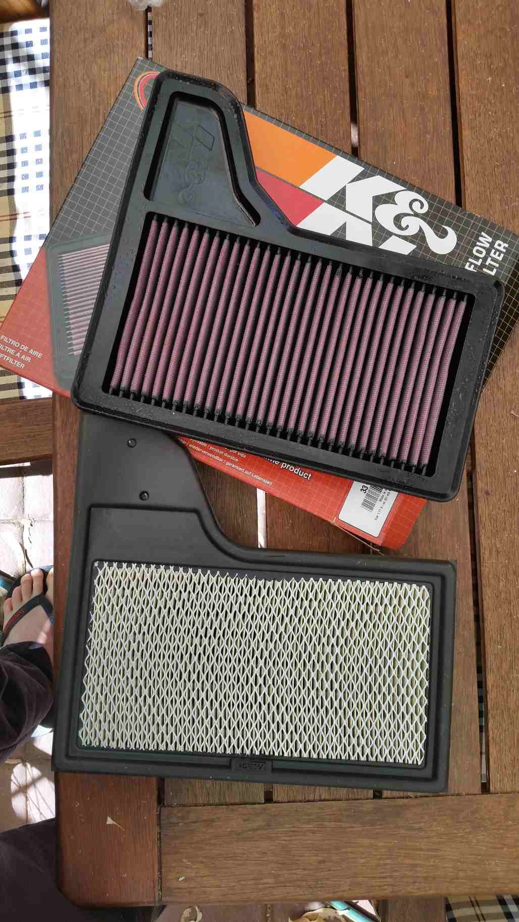

If you think it's worth frigging around cleaning it and reoiling...:D
FWIW I just ordered the Airaid elbow, $50 cheaper delivered from JC Whitney (on ebay) than CJ Pony.

Its a non oiling filter $92 ebay K&N Filters 33-5029

@ snake bite just saying but if you don't want to do the reoiling thing I'd double check to be sure. I'm genuinely intrigued, afaik all K&Ns are washable and need oiling so I checked the CJPP site for this p/n and it says:
The cotton is treated with specially formulated oil...you can wash & reuse it...every 50,000 miles.

....afaik all K&Ns are washable and need oiling....
They do, including the quoted one. Of course there's nothing stopping you from not cleaning and reoiling it and treating it as a disposable filter.

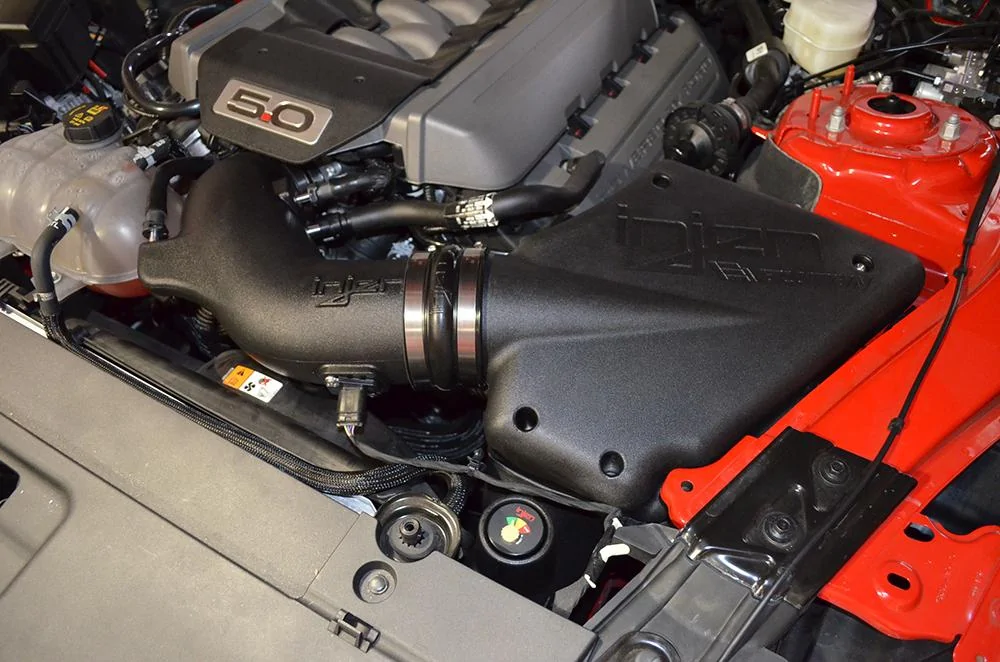

Guys check out our US Designed and US Made Injen Cold Air Intakes for the GT and Eco's. Another new shipment of the Injens CAI's arriving back in stock late Jan. These use a unique nano filter and the filtration area is by far the larget of any CAI. Being a dry filter means you wont have any oiling issues on the air flow sensor. The nano filter is easily cleaned. The whole unit is designed to flow air. The inlet is a patented tuned design that flows plenty. No tune is required however if you choose to do a tune and are chasing additional flow there is an internal section that can be easily removed to open it up. It also has a filter minder gauge that shows the condition of the filter. They also carry much lower intake temps than others. If you want further info go to US Injen website Injen.com or visit our website suspensionpartsonline.com.au Our phone number is 03 9553 6915. Also coming in early 2018 will be our new website mustangcity.com.au

Fred thanks for posting it looks like a well made unit. Getting down to the detail though, can you please let us know;
Airflow capacity compared to stock airbox
Filtration quality compared to stock filter
IAT compared to stock airbox
Power, performance or response improvement over stock airbox on a stock engine
Happy to invest, just need to know what bang for $ I'm getting.
:cheers:

Because I like factory look and still not convince of big CAI gains without tune I've gone for K&N filter and cleaned up air box lid. Probably a placebo but it seems to be a bit more responsive.....Anyway it can't do it any harm :headbang::D:thumbsup:
