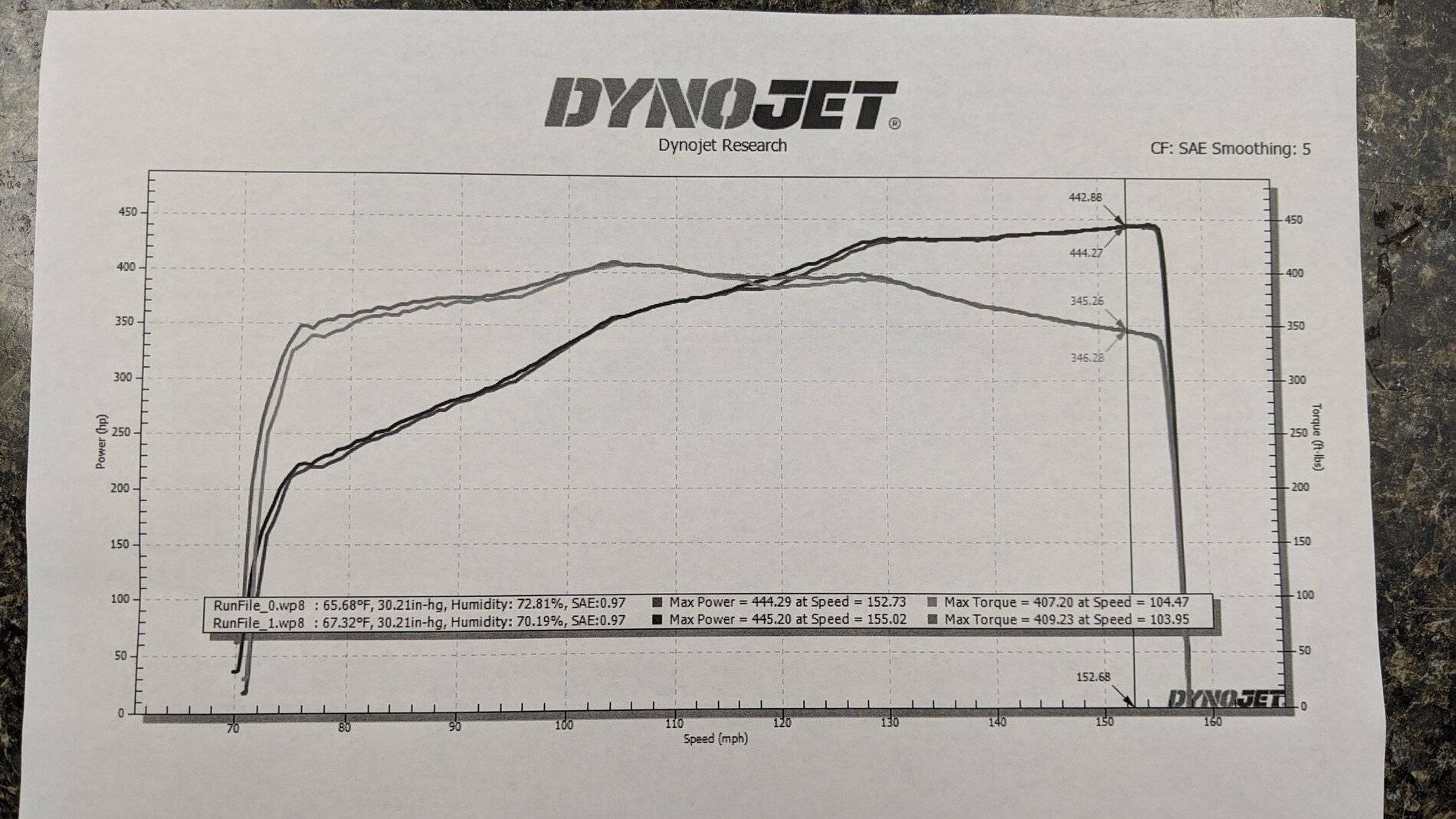

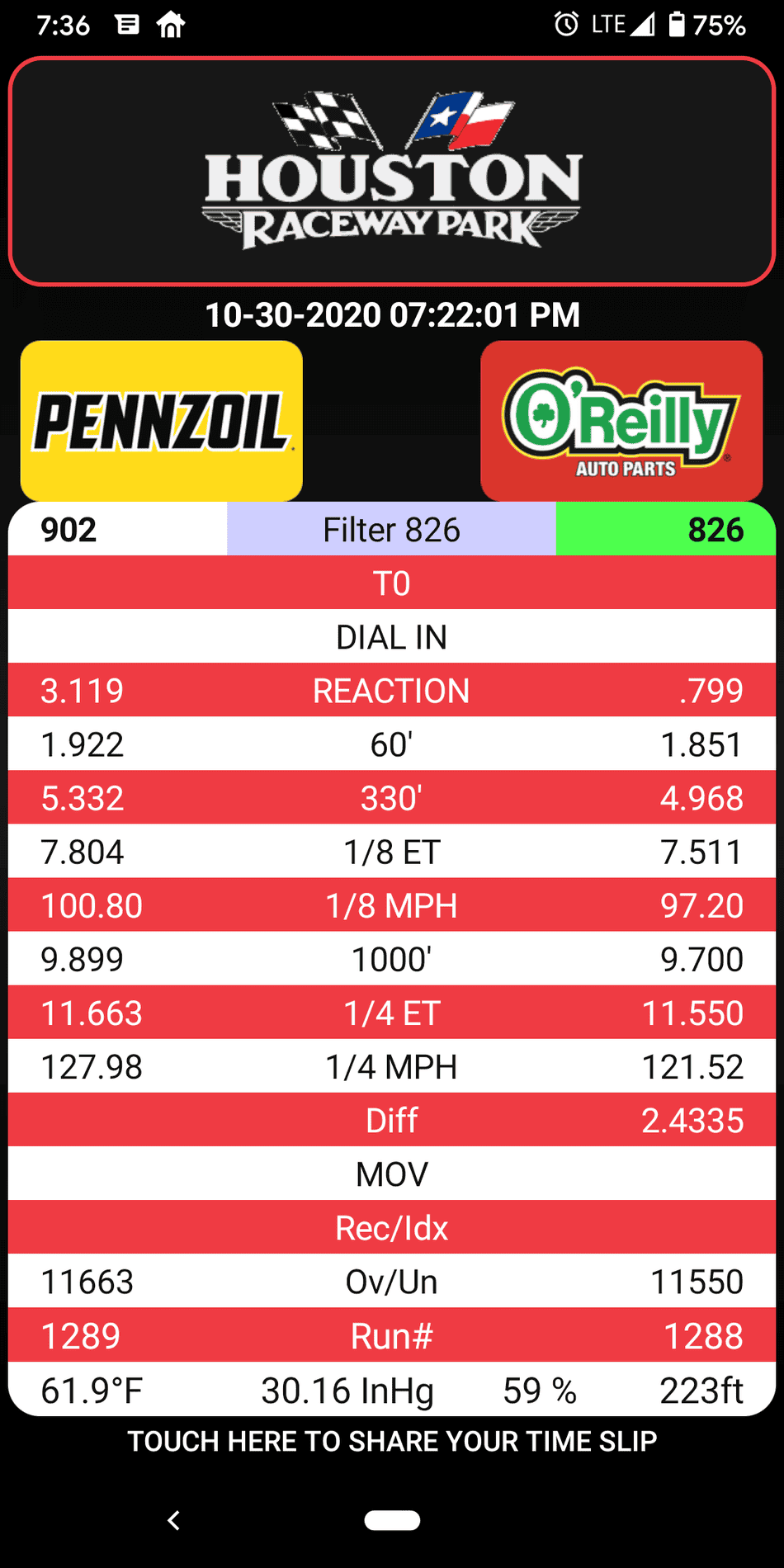

I'll let you know when I do an E85 tune and re-dyno. This is my baseline on stock tune with only a K&N drop in filter. Before you think "happy dyno", I included my time slip trapping 121.5 before IRS lockouts, with full interior only on drag pack.
