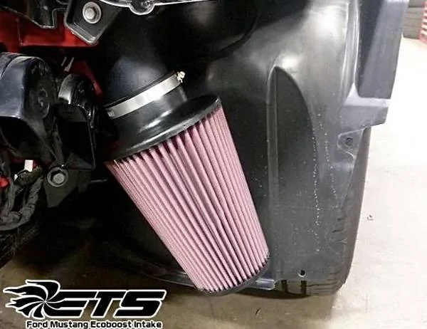

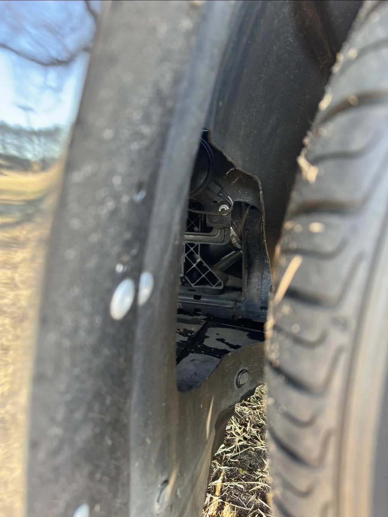

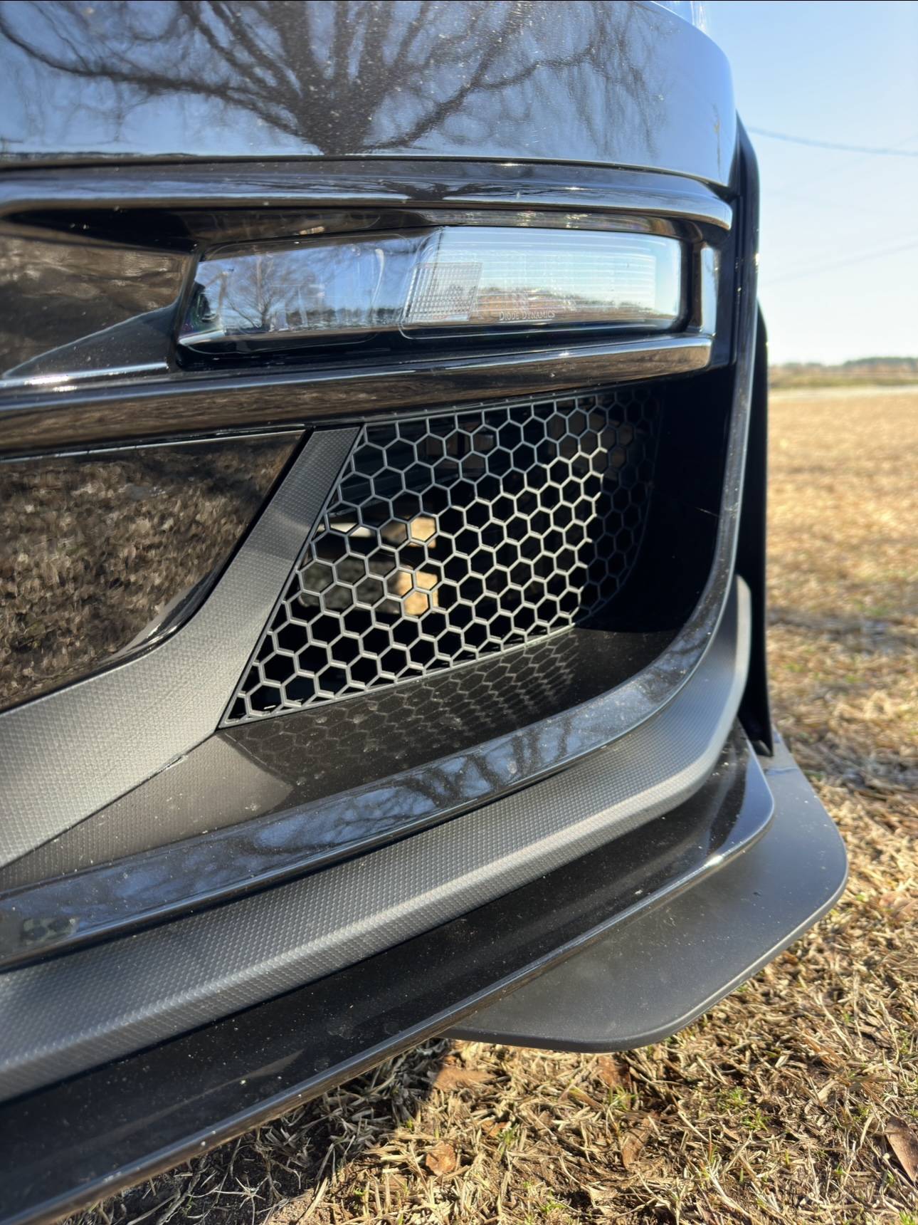

Hey I would really really love some help I have a daily driver 2019 ecoboost and I want a cold air intake but I want one that goes into the finder well I have the GT500 bumper and I have 2 big vents on the bottom of each side I also cut my finder liners so air that gets pushed through those vents will shoot out of the finder liners into the wheels the only thing that I’m worried about is if I put the cold air intake down there water rocks and mud will get on the intake and I’m really scared to hydro lock my engine but I really really want to put my cold air intake down there. I feel like it will get so much cool air constantly if it was down there.

Unless you drive in huge puddles and heavy rain, you're not going to have an issue with hydrolocking the engine. Rocks and dirt might be an issue, but you just have to keep up with cleaning the filter more often. I wouldn't worry about mud unless you go off-roading for some reason.
But...it seems overkill. The OEM setup is perfect for what you want eg. cool air. By sealing the intake box to the front snorkel (and maybe adding a velossa tech) you get 100% cool air from the front of the car and a bit of ram air too.

Yeah I always was the one that liked the closed box element but after looking at my finder well I have been more and more interested in putting the air intake down there thank you sooooo much btw😁

Can't argue with that, love it. I would say keep it close to the backside of the bumper and maybe fab a little interior mudflap type thing to keep the tires from throwing stuff directly at the element without actually making an enclosure.

I was thinking the same thing I was also thinking of putting this around the the vents
