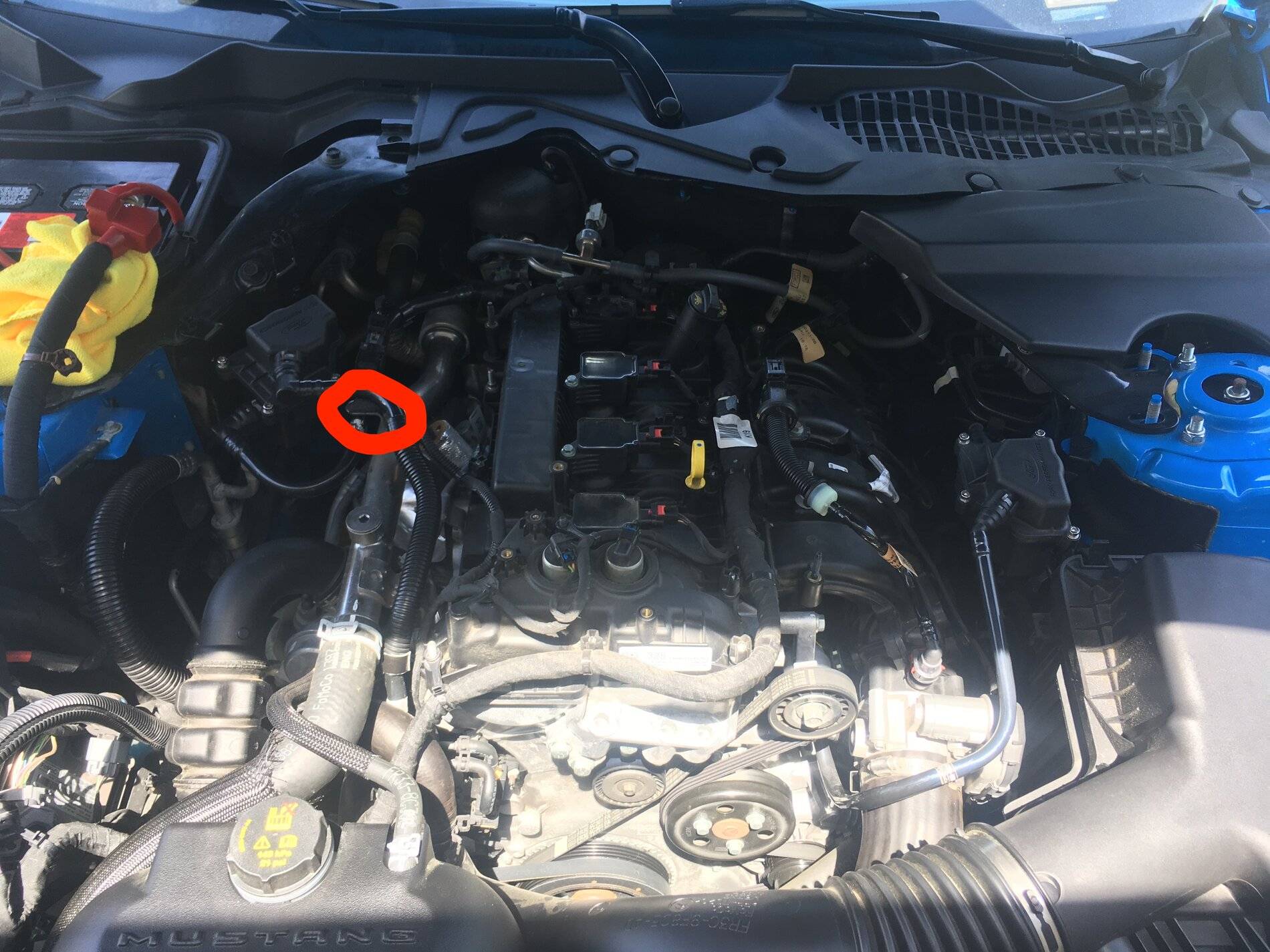

The orange I circled, I put sound dampening material on that, since the little hose is resting on it, the previous hose that I removed to install catch can, had a zip tie poke pin thing that went into that and secured it.
havnt had any knock registered since I did it, so I think it was bumping it under wot or something.

I did not gut anything, ford perf ones aren't supposed to gut the PCV from what I read, its the passenger though that is causing this new cel, the p04db-00
I'm confused about how a hose touching something could cause engine knock.

The knock never happened again Idk
could of been bad tank of fuel to be honest
