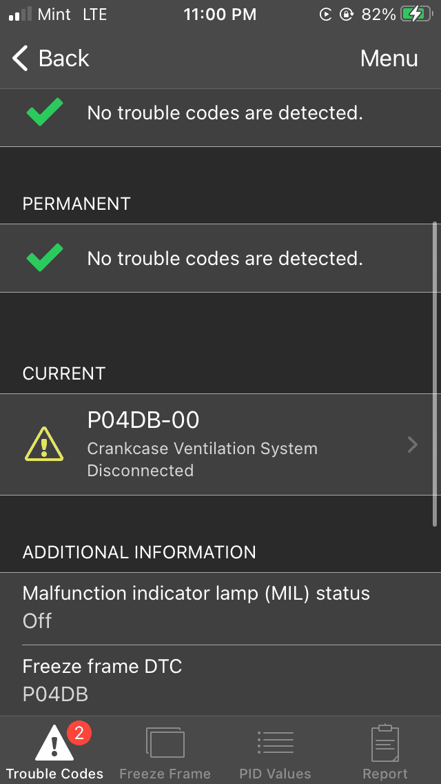

I lied, I just scanned and got this code on obd fusion.
when a code shows up on a obd reader, but not on dash, does that mean there's a chance its just a false alert and will go away? or does it have to appear so many times or something before it throws a wrench on the dash?

I have 2 ford perf catch cans. I had right side (dirty side on EB) for last 20k miles, never a hiccup, I added the left clean side ford perf, and many have had the same CEL from it, (mine hasn't popped up on dash) but it did pop this up when I scanned.
as long as it doesnt illuminate dash light im happy, should I worry at all though? reason I ask, as long as its flowing just fine, the light can be considered a dummy light right? I am thinking there's too much volume in the catch can, and its throwing off the sensor/pressurization expectation by having to fill the volume of the catch can and not being what it expects, because the catch can has a electronic clip that plugs into fords harness.

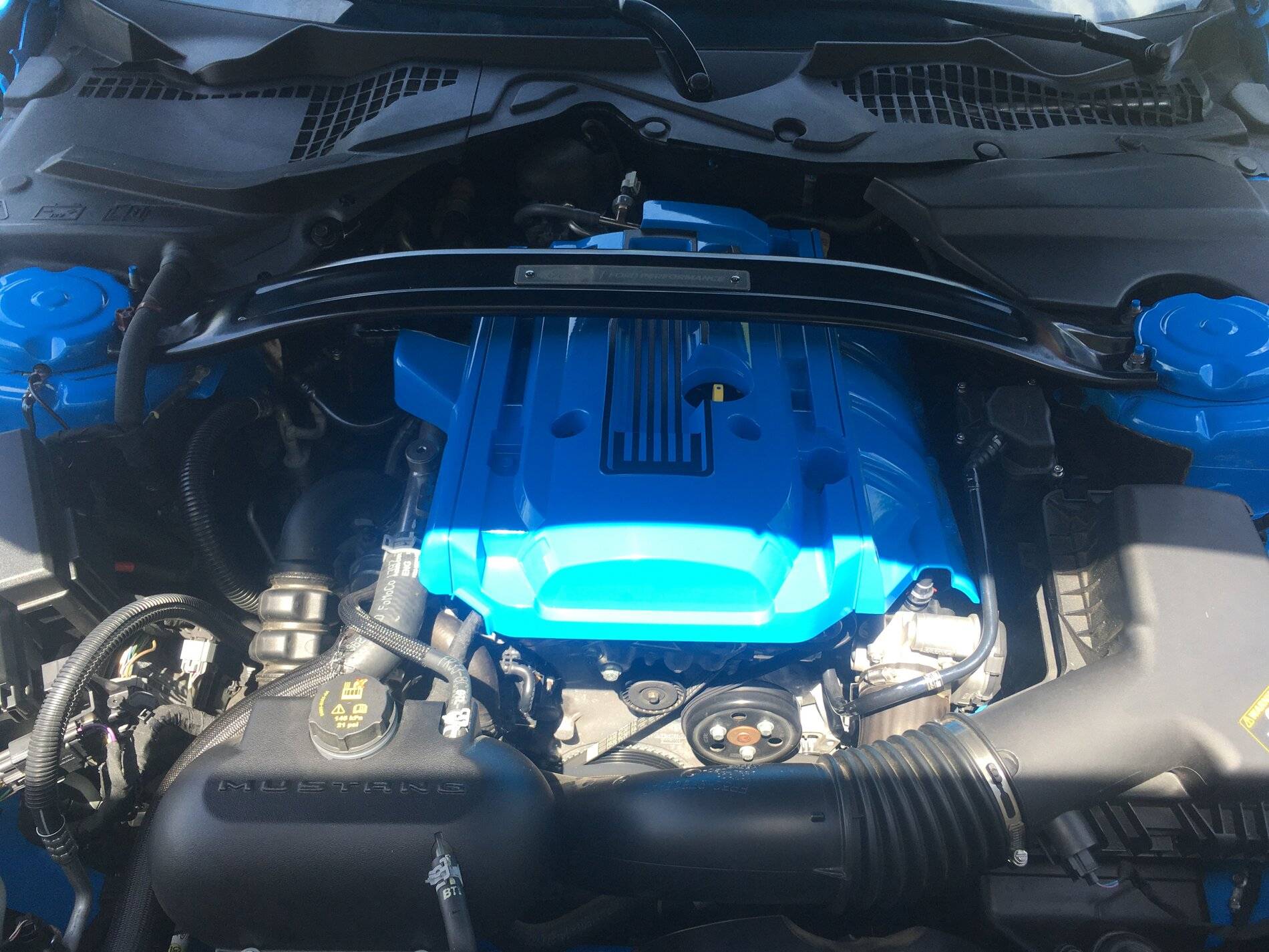

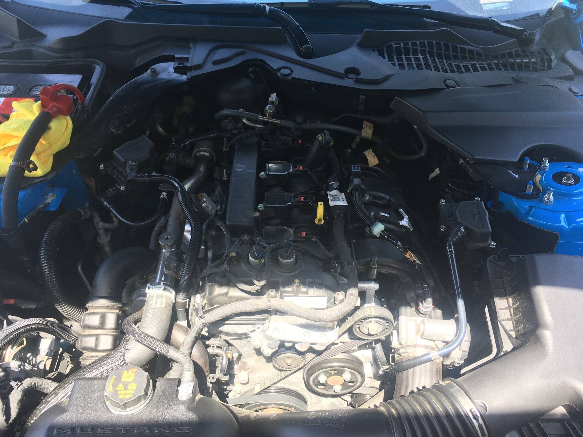

I took a pic before I put everything back on, you can see the 2 catch cans.
the other people who used ford perf catch cans, any catch can really on clean side, all seem to get this code for most part. just wondering if its fine to ignore, and its actually fine, and disregard the code. as long as doesnt hit my dash I dont care really. but if its an actual issue, like pressure is being too much build up or not letting enough build up, then that could be an issue.
