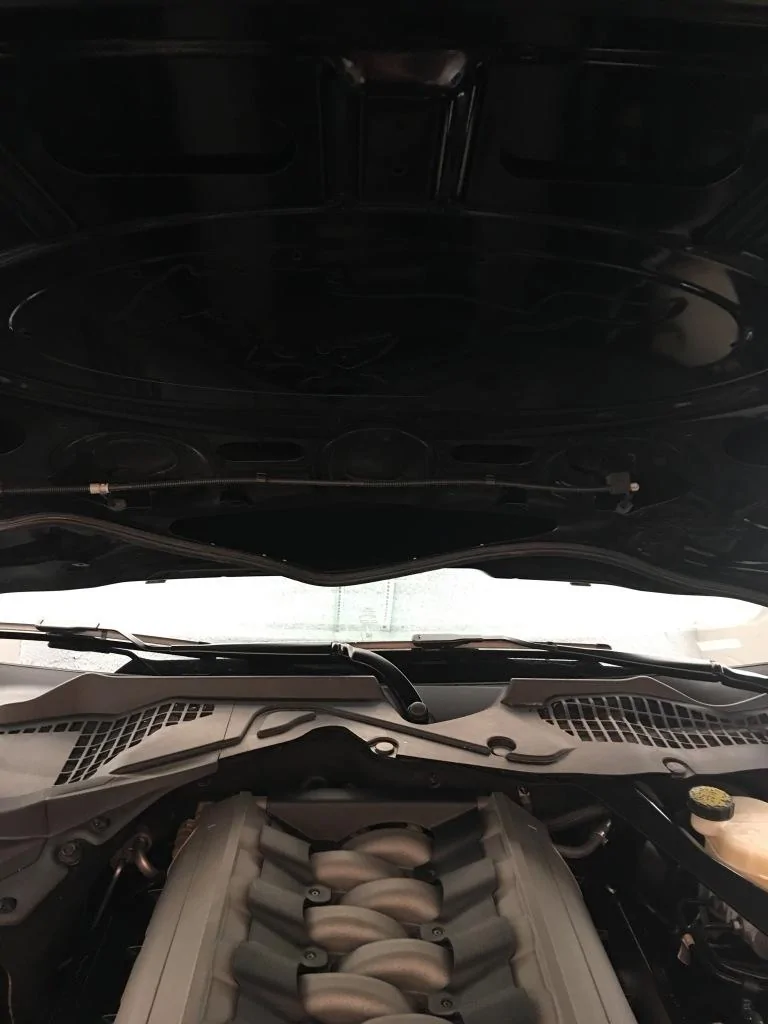

You can make the cut look like it was on the car to begin with it you want. I free handed this with a 4.5" angle grinder because I'm too impatient to use my dremel for this lol. I haven't seen anyone cut there's like this so I figured I'd share.
CJ will be on soon I'm preparing everything and making sure I have everything I need because this car is my daily driver.

looks nice! did you end up dropping the motor for the cj to fit or did you change your hood?
Terminator2
Apr 21, 2016
1,960
448
Spring Hill Florida
David
2016 Mustang GT Premium
He has an aftermarket hood but still had to cut the rear cowl portion of it to clear. The problem is the manifold sits so far back that it hits the rear cowl portion of the hood skeleton on even some of the aftermarket cowl hoods.
