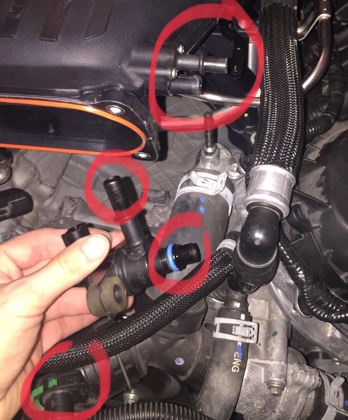

I’ve been trying to search but haven’t found many details on vaccum routing. I can not figure out vacuum lines for he life of me... I attached some pictures I have no idea what goes where. I should also mention I will be deleting pcv and using filters so I know some will have to be capped off any help with pictures will be appreciated

The problem is I do not know what goes where. And the ford performance instruction manuals don’t help much

Just did this instal but using the boss kit which you do not need.
Green clip goes on the purge control valve line below the electrical plug, you will need to buy hose to run from the nozzle with the blue fitting to the top fitting nozzle on the manifold (bottom for brake booster).
You can mount the purge control valve underneath the manifold using any type of metal bracket, there are two open bolt holes on the block that aren’t used
Hope it helps

Thanks that is what I was thinking I will go with that !
