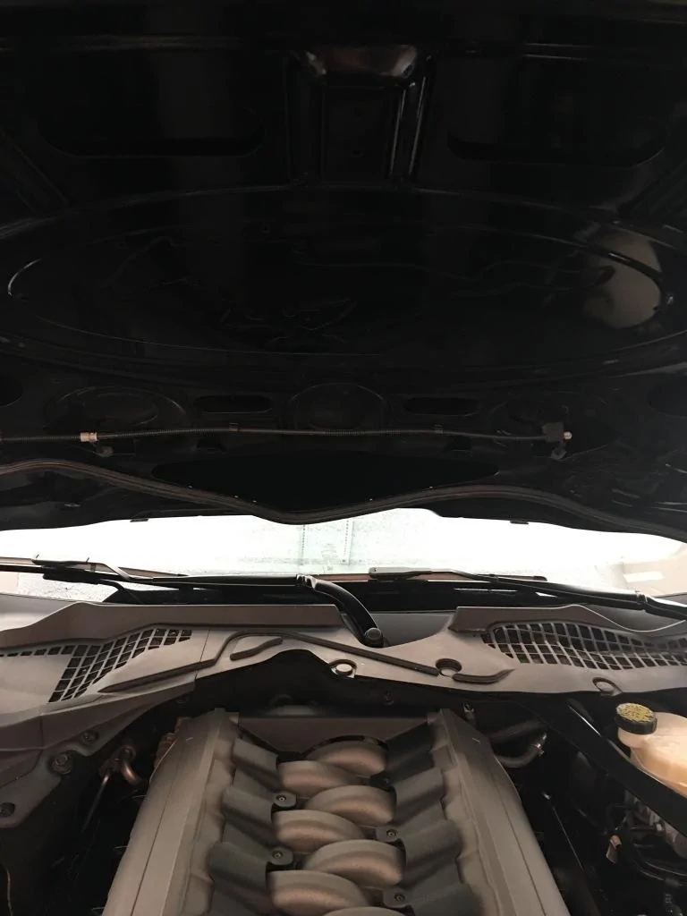

Haven't cut it yet. My good friend has a fabrication shop. We've discussed a Ti intake with a PMAS filter and bellmouth on the end since I have an extra but not sure I want to mess with it.
I keep wanting to go out and see if we can machine the stock mounts in any way to gain 3/4 clearance. I don't want stiff mounts so I'm going to cut if I can't lower the stock mounts in any way.

I would worry about your headers hitting the steering shaft I've heard others with long tubes have had this issue. I decided it was less headache to just cut mine.
