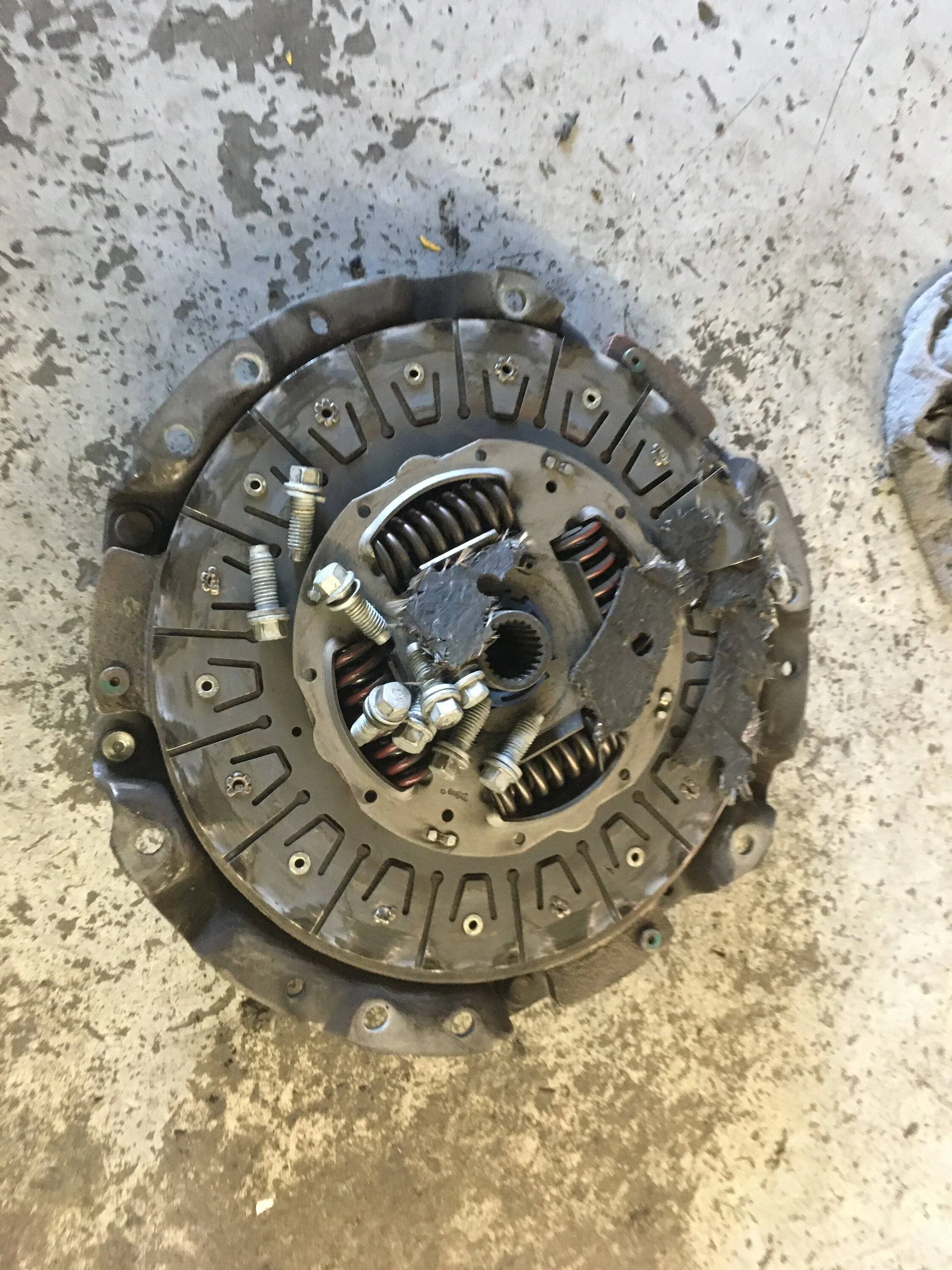

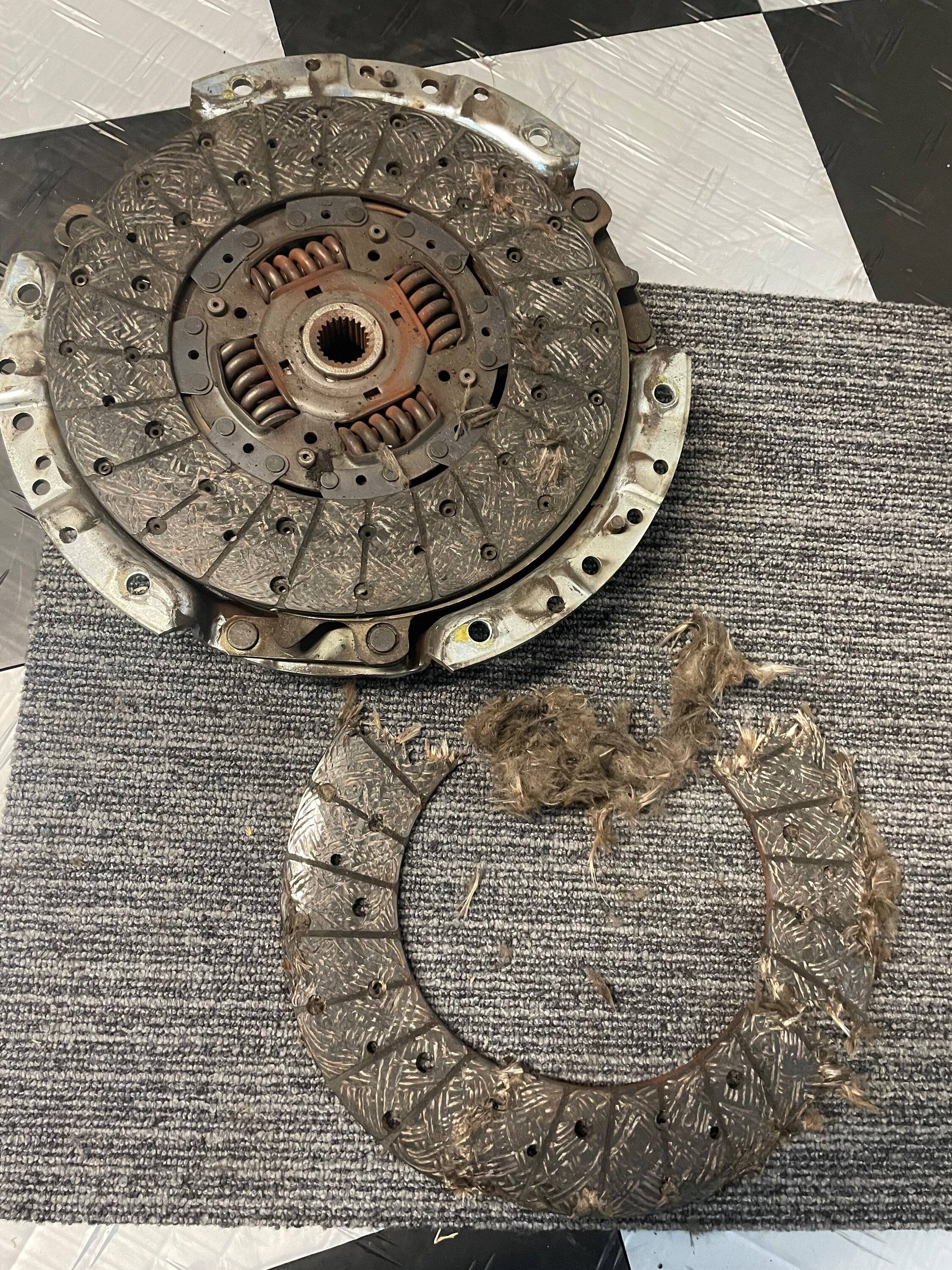

TADTS.
"They All Do That Sir...."
Although mine went on track shifting at over 7K rpm :)

Yep, it’s what happened to me …twice…until I went to an aftermarket clutch…
The factory “ made in Turkey” clutch can’t handle high rpm’s shifts

Organic material Clutch and 7k+ rpm do not mix..
irregardless of HP and manufacturing location.
After stock failure then Exedy organic.. I‘m changing to Ceramic.
