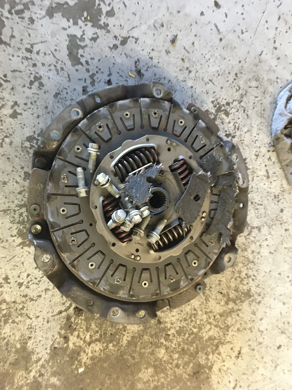

2 clutch exploded on me (17pp1) when changing gears at high rpm’s
Not saying that it’s your problem but they are very weak for track duty
Went to an aftermarket and never had a problem since then

My factory clutch exploded broke twice when changing gears at high rpm’s
Upshifting, not downshifting
My guess is that the centrifugal forces did it when the pressure plate is away from the. Clutch disk

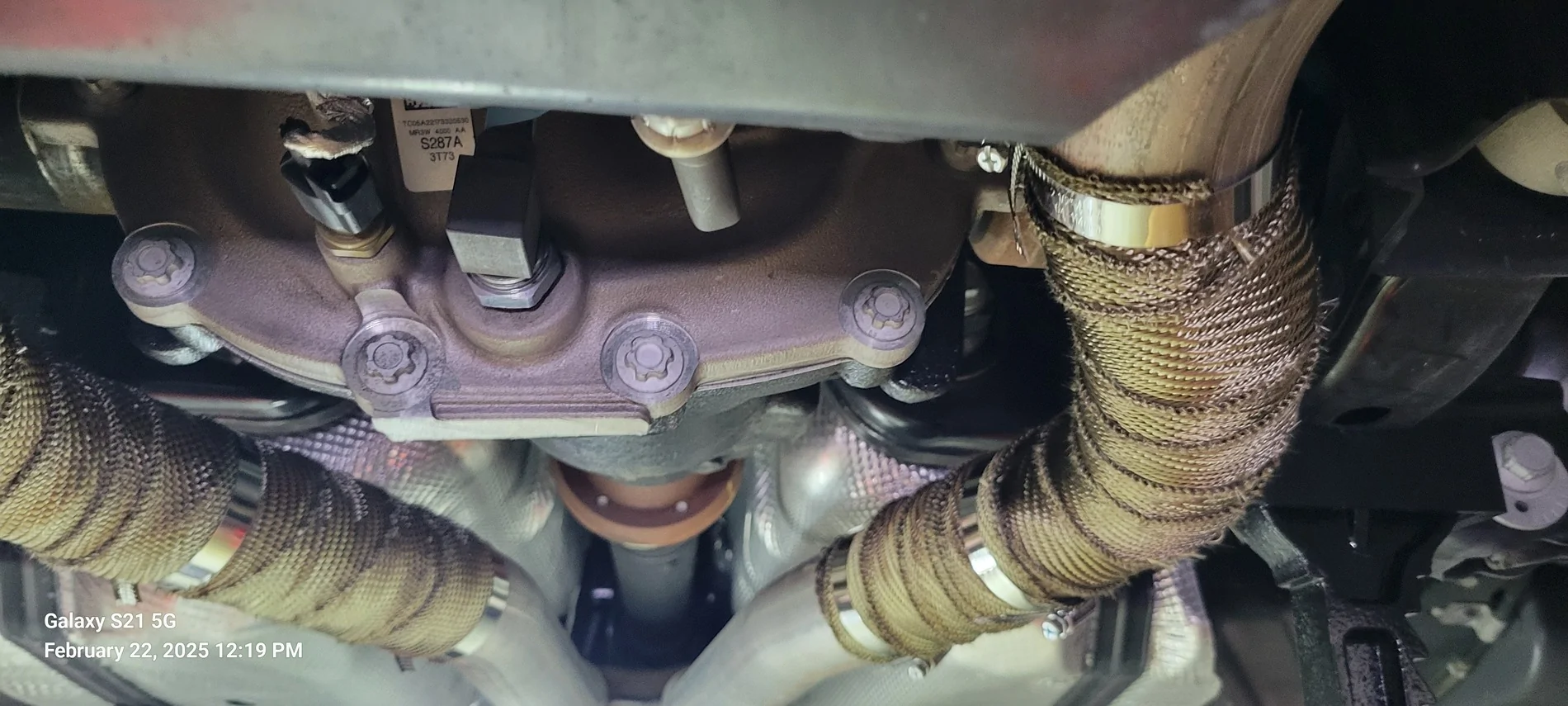

Beside using thicker oil, wrapping the exhaust pipes on both sides of the diff with insulation will allow you to run without a cooler

Good point. I recommend that also. I did it even with a diff cooler. Never overheated at Daytona a couple of weeks ago even at 95 degrees after 8 lap session.
