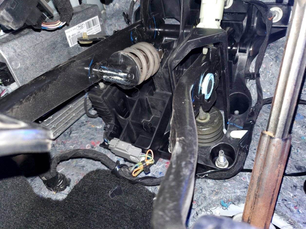

I've thought that and It could be possible but I don't think owner #1 would change it out for funsies. The only other thing he did was put some carbon fiber on and did some exhaust stuff. The previous owner was a Florida-Man so who knows. Shame I can't ask him or take a look without removing the transmission.
This looks like the stock clutch spring to me. It's definitively not the Steeda spring.

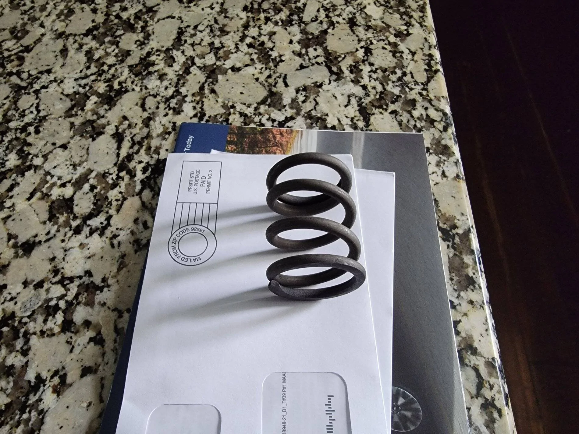

Yes, your spring looks stock. I attached a pic of mine. Even if it were the Steeda spring; it would not be hard to engage the clutch. The Steeda spring mostly makes the engagement point easier to feel and in the same place each time.
