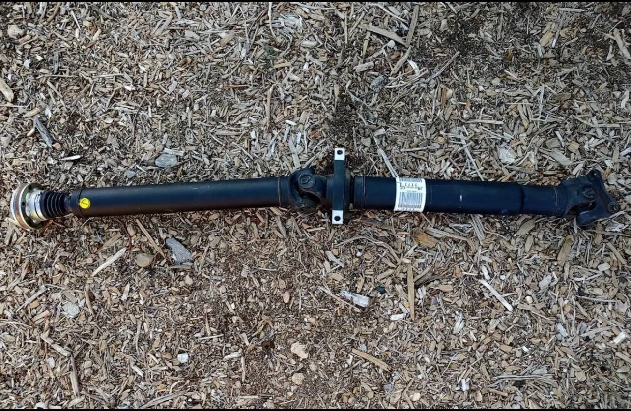

A lot of people are saying the correct things, but it’s nothing serious. Just your driveshaft. It’s a two piece shaft so it’s metal on metal. From stand still it turns and gets the other piece going.
