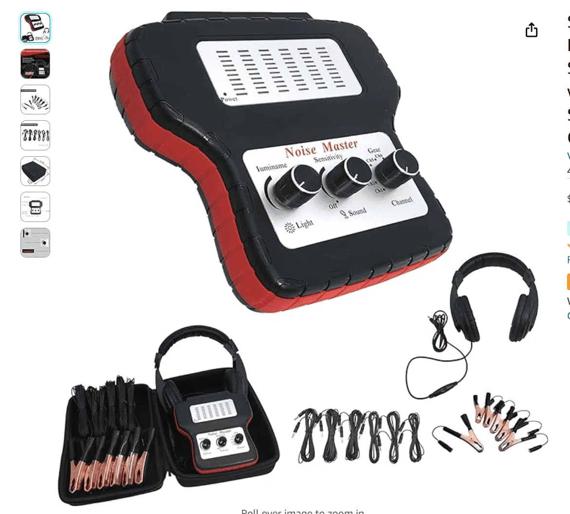

On another note, would something like this be an awesome investment? Any of you tried it? Trying to find an annoying rattle inside and I feel like this would help pinpoint the sound location for OP? Any of you bought this or similar?
Edit: I don't think this one gets really good reviews. But Something similar with better quality would be nice.
https://www.amazon.com/dp/B0CCPBF9H...automotive&sp_csd=d2lkZ2V0TmFtZT1zcF9kZXRhaWw
