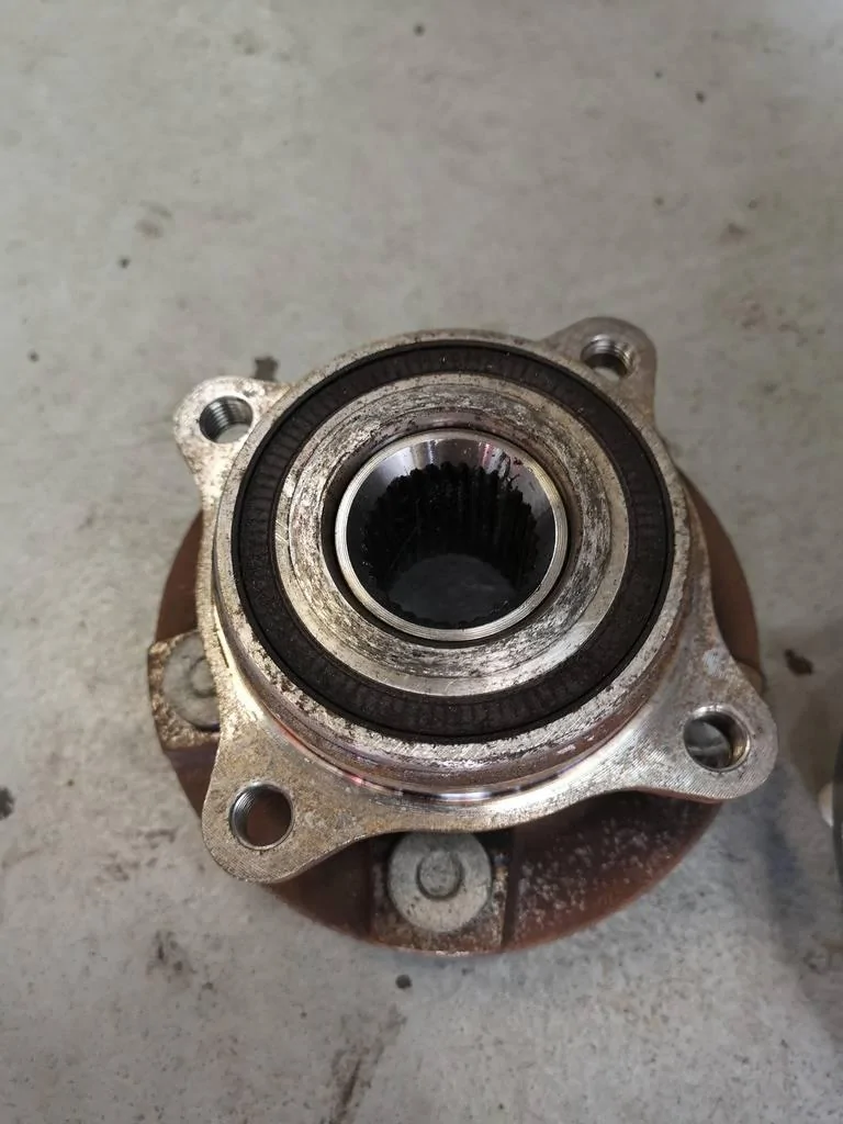

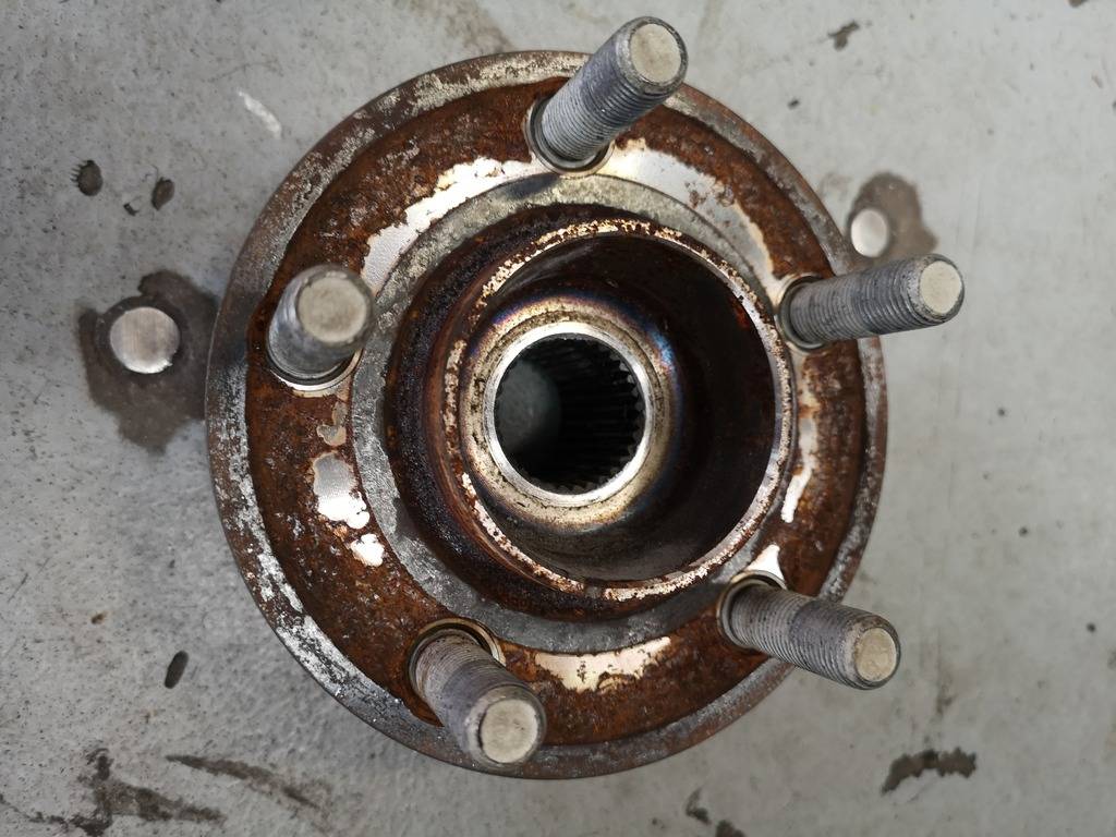

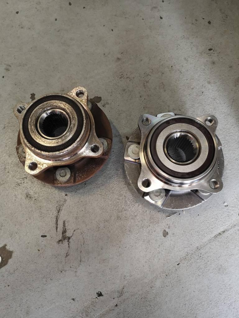

So today I replaced my wheel bearings again.
Only 6m old with about 10k miles. Only fitted through this summer season and they look like they've been under the freaking ocean. OEM Motorcraft.
Replaced with Timken. Clicking popping has gone, but for how long. When I put the GT350 half shafts in, it was silent for a few weeks and about 1k miles.
Old vs new

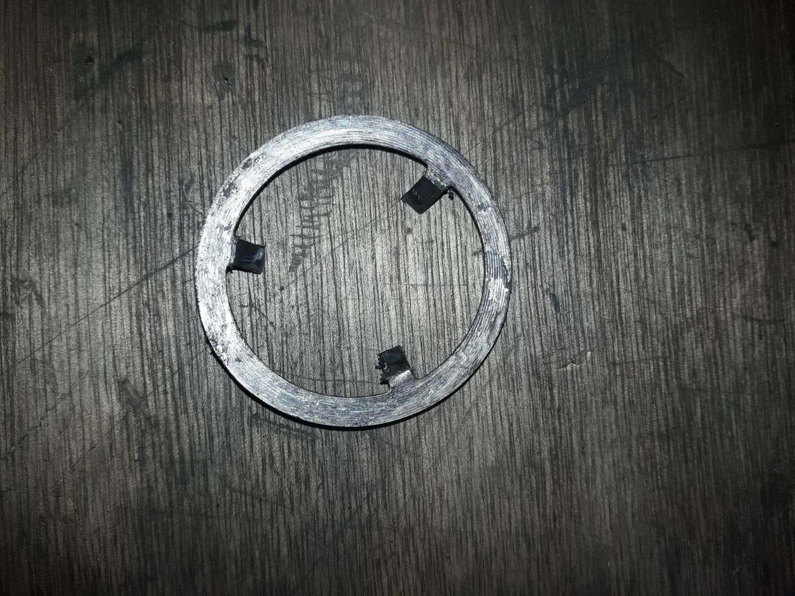

I eventually found a great shop, who on describing the problem said he once had something similar with a Camaro. He immediately went to these, ordered new ones and voila, problem solved.
Importantly, he said that the new items from Ford were significantly thicker and look to have been redesigned.
So, finally done with this issue!!

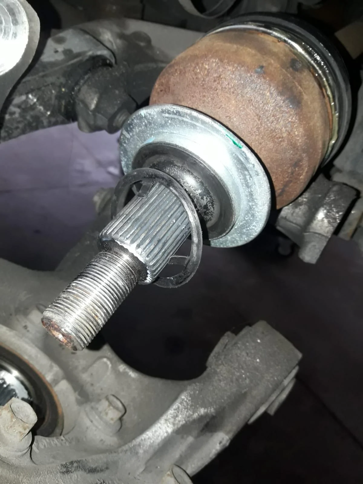

I dont know the technical name, but they are a sort of spring washer that sits between the back face of the wheel hub/bearing and the end of the D/S.
If the D/S is removed, they are immediately noticeable.
My original D/S on the car had them, and my OEM replacement GT350 shafts too.
The shop said the replacements he ordered were significantly thicker. Noise gone immediately.
