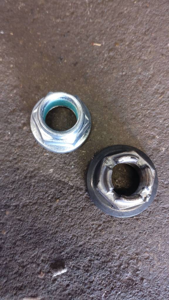

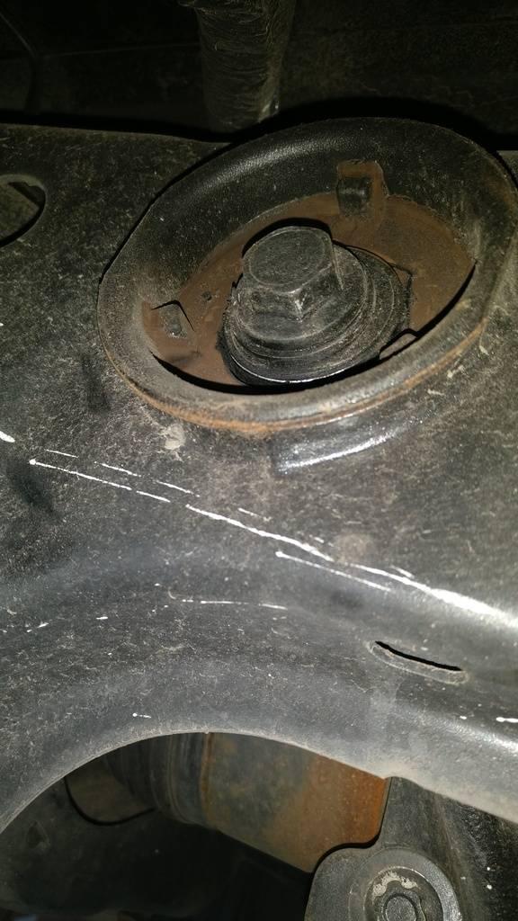

I finally went and ordered a new set of bolts from my local Ford dealer.
Part number:
They look quite different to the parts that came off:
Top (new), bottom (old)
The new ones dont have the retained washer of the old ones.
Now torqued up to the BMR specs with Loctite. Problem is gone! (205Nm + 45 degrees)
Now to see if it comes back.
Anyone know why the design has changed so radically on the bolts?
