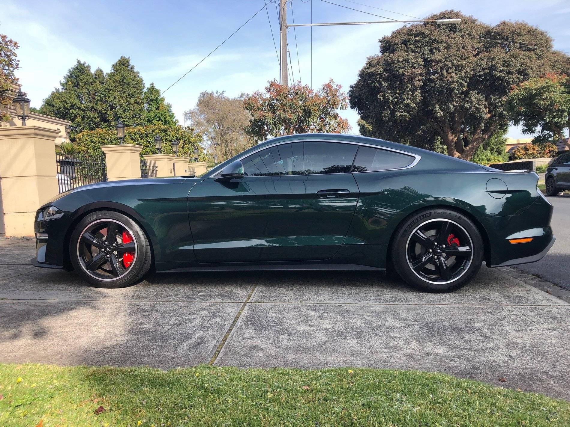

Steeda Magneride lowering springs with 1" drop. I don't think it looks lowered, I think it looks the way it should have come from the factory -
Bulutt

im 1 inch around, and you will learn to go slowly into certain areas, angled in others, definitely not the same as a full height car. but nothing drastic either.

I'm a little over an inch lower in the front and my front splitter clears the normal size parking stops.....just barely :)

Have steeda 1" magneride lowering springs all around on my car. Absolutely love the look and the feeling.
In the majority of the area I drive in, i don't have many issues and with the stock front fascia, I would think that you would have minimal to no clearance issues compared to stock
However, if you're thinking about modifying the front end (i.e adding a chin splitter, gt350/gt500 style front, etc), you will most likely have to adjust some of your angles of attack/plan your commute a bit. I do have to enter/exit my driveway at more of an angle now to avoid scraping and there are some entryways that I simply can not enter or exit at all without finding an alternate. I've already had to replace the chin spoiler from getting it caught and cracked in a dip that I didn't hit at the right angle leaving a small plaza that I frequented before with no issues.
