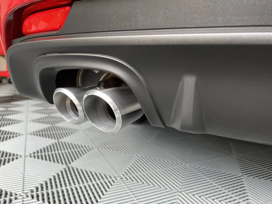

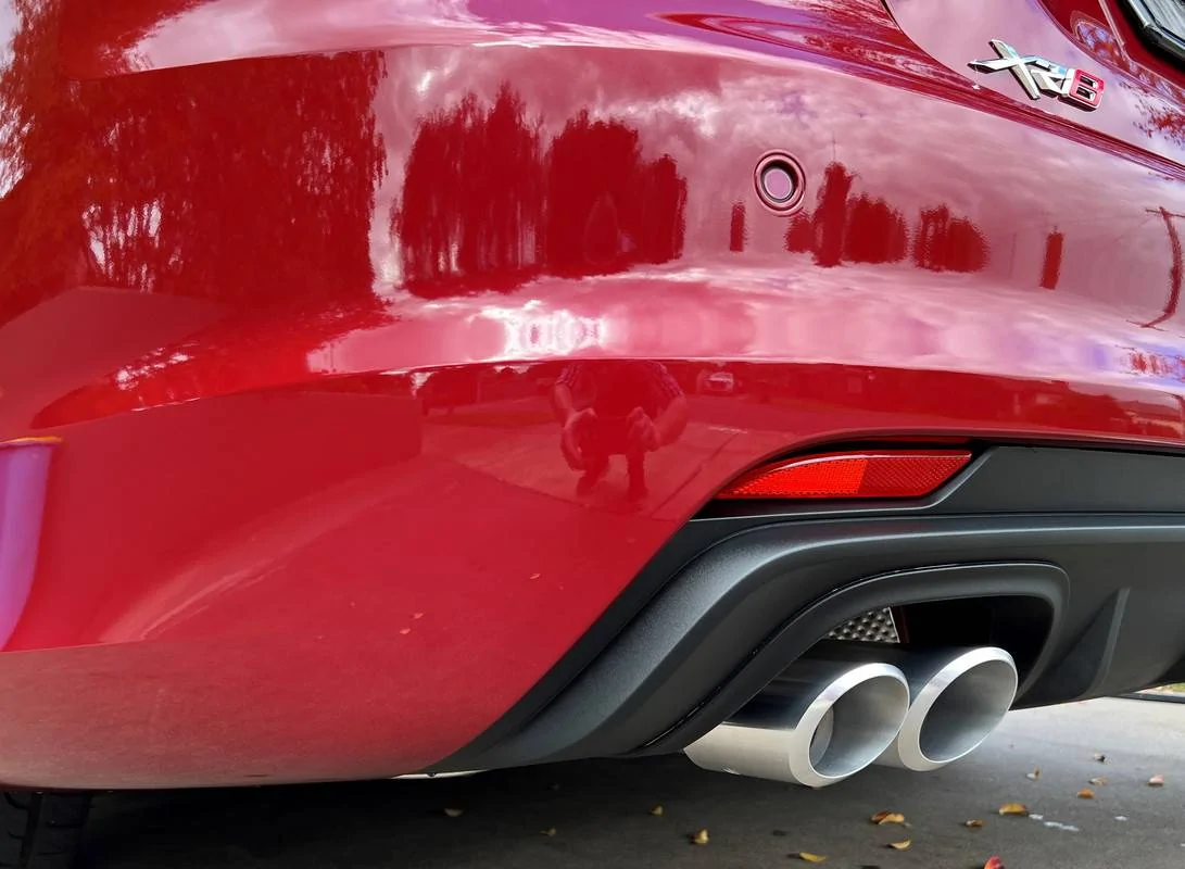

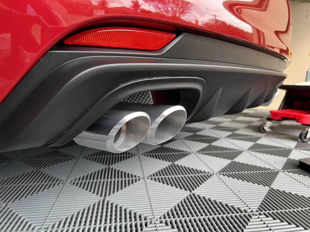

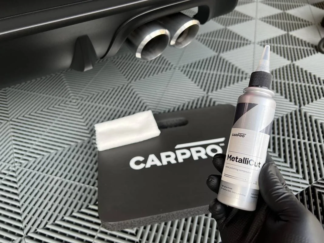

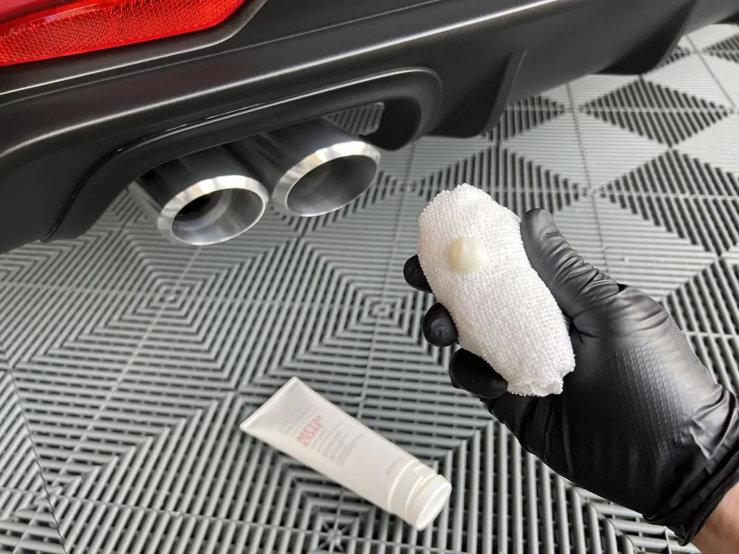

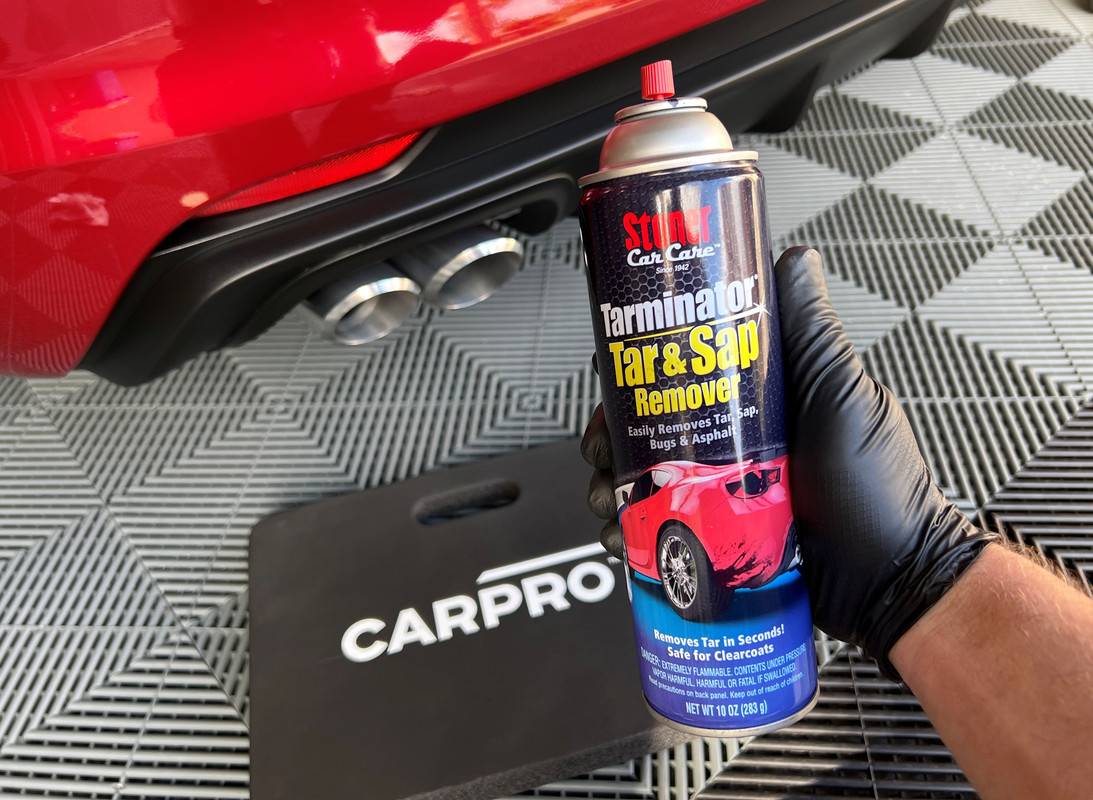

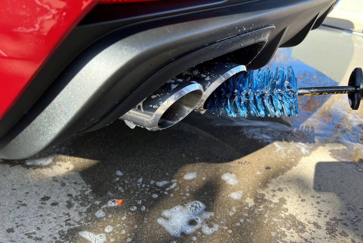

I stumbled upon this somewhere, but Stoner's Tarminator is excellent for removing baked on carbon from exhaust tips. Clean with a wheel cleaner of choice, dry, then using a b-grade towel, spray Tarminator into the towel and work the affected areas. You may need to repeat the process a couple of times. Once finished, I recommend rinsing the tips to remove any lingering Tarminator residue. From here, you can polish with any metal polish to bring them back to a glossy finish.
Stoner Tarminator - 10oz (Aerosol) | Car Supplies Warehouse – Car Supplies Warehouse

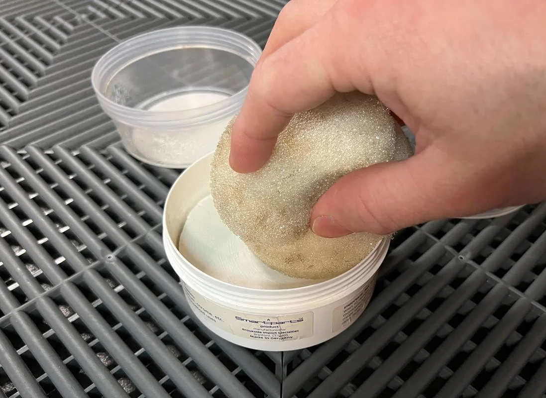

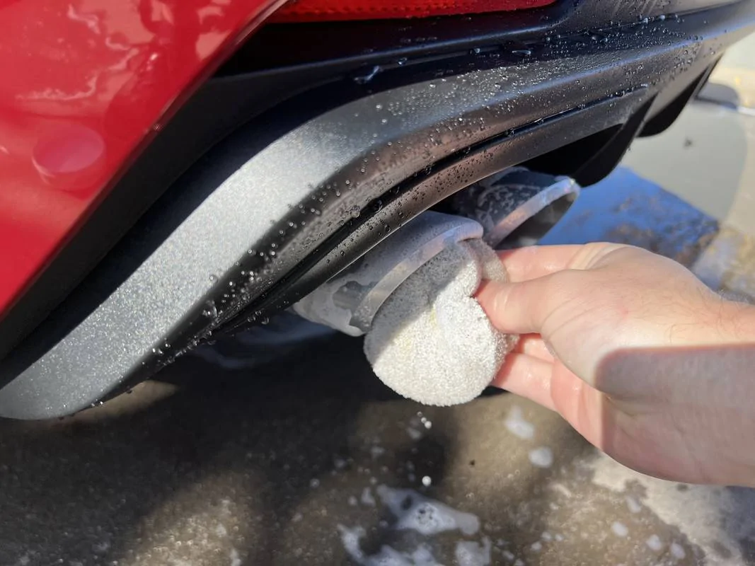

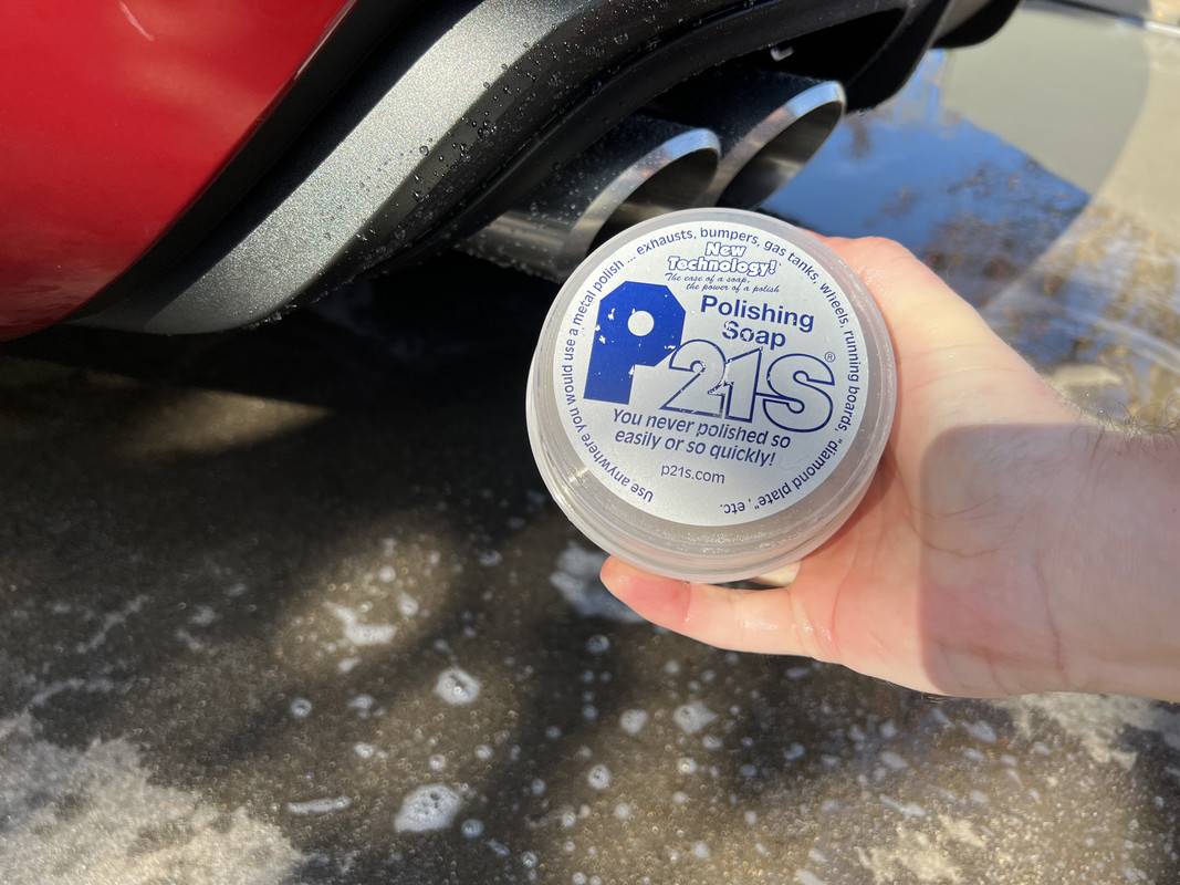

If the tips aren't too bad, have a look at P21S Polishing Soap. This product is a combined soap and abrasive that polishes as it cleans. This can help bring back exhaust tips, or maintain them after a deep clean outlined above. You use this while washing the car and the tips wet.
Amazon.com: P21S 15300P Polishing Soap : Automotive

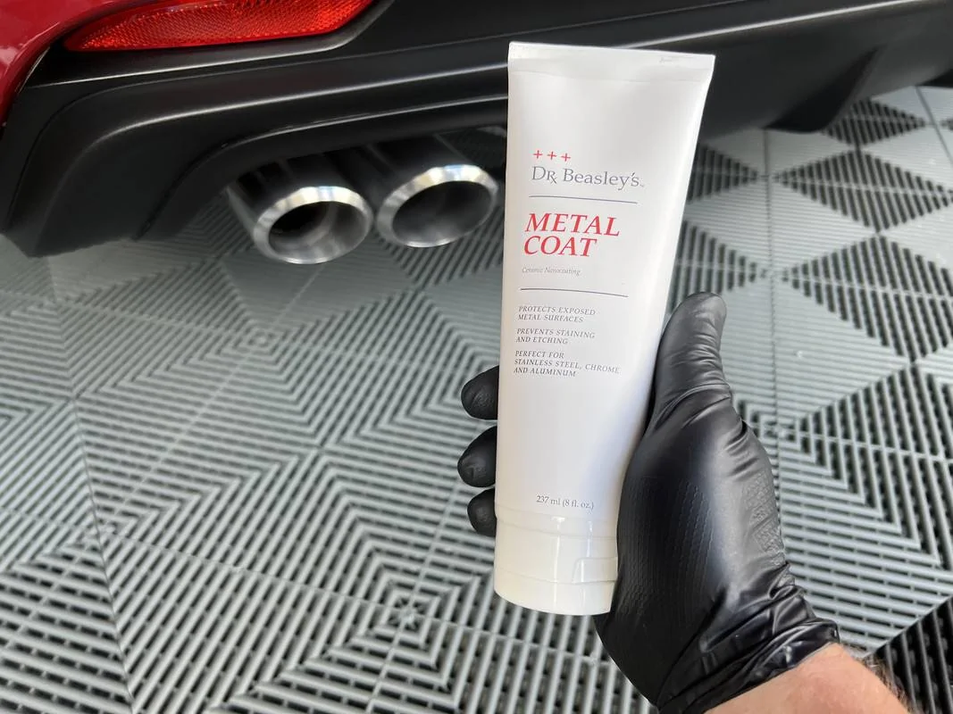

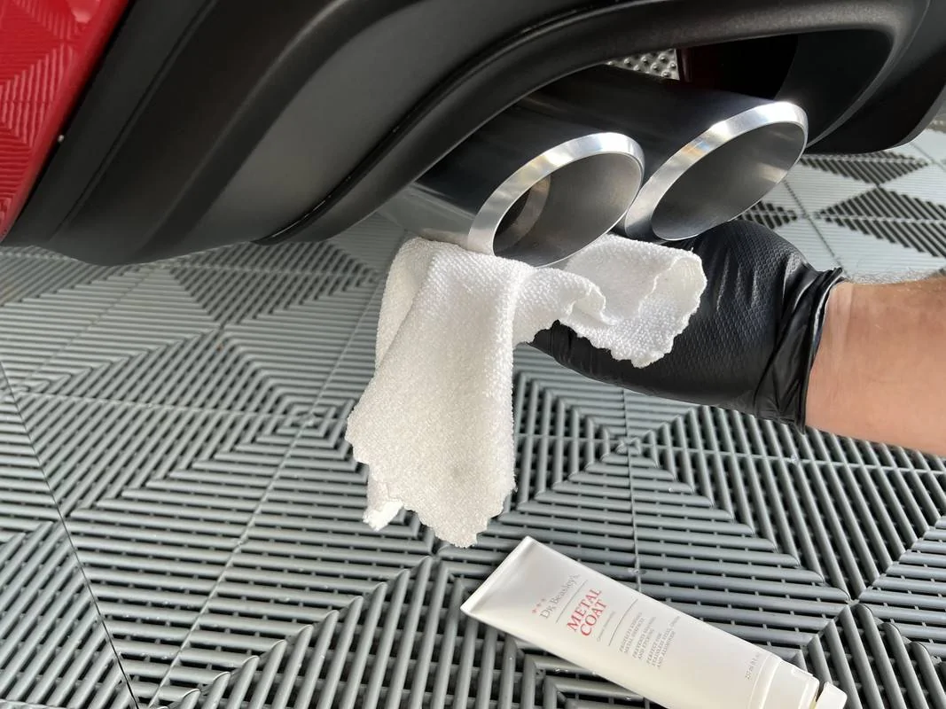

After they are clean, I apply Dr. Beasly's Metal Coat, which is designed for higher heat applications.
Dr. Beasley's Metal Coat | Ceramic Metal Coating | Obsessed Garage

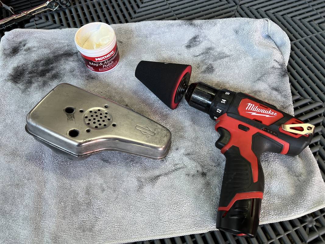

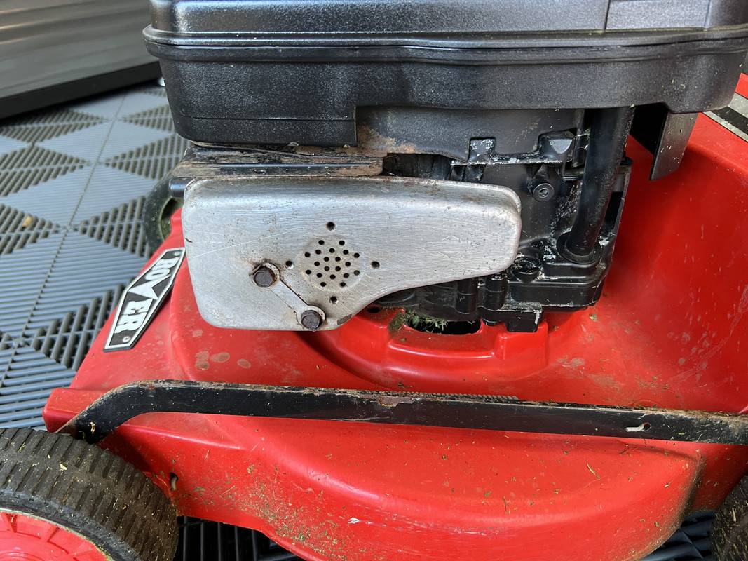

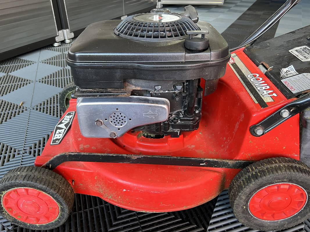

Yeah, the Mother's Mag & Aluminum Polish is the real deal, the Carpro Metal Polish I pictured above is garbage. I even use it on.................... non-automative exhausts..................... :giggle:
