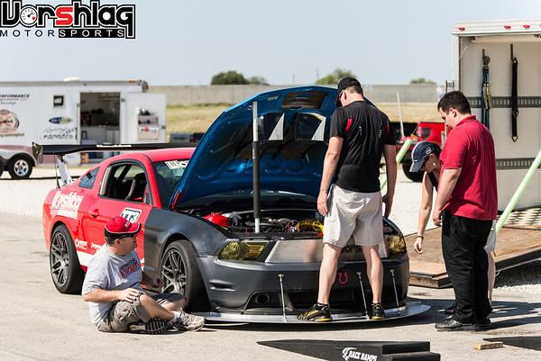

You have to remove the bumper and connect the rods to the inner structure, similar to a tow hook. Of course you have to cut a hol in your bumper but its bottom facing so no big deal really.
As far as the APR front splitter goes, after you go through that mounting and cutting process I would not stand on it like how the Vorschlag boys are doing it ^^^

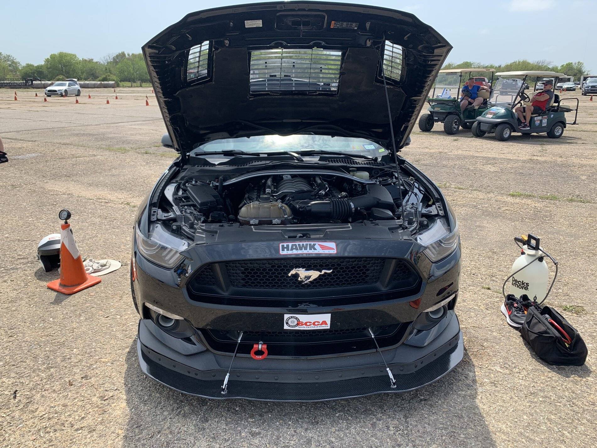

I’ve done it. Requires welding and making brackets. Splitter rods connected to the metal bumper too.
Its far easier to just take the front clip and belly pan off and just use a lot of fasteners to the stock belly pan, but the stock belly oan is tilted up towards the front of the car and a splitter mounted that way is probably doing the reverse of what you want. To get a good angle your splitter will probably be 1-2” below the stock belly pan splitter at the edge so you’ll also have to fill that gap. Then you’ll be scraping on every little thing if you don’t have it setup to easily remove.
Looks great. What did you use to fill the gap?

$9 of home depot garage door trim with aluminum angle brackets for support.
Funny as I was thinking about plastic lawn edging. Thanks for the info
