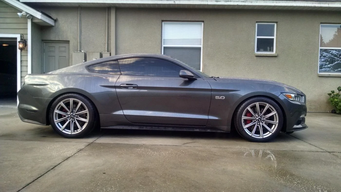

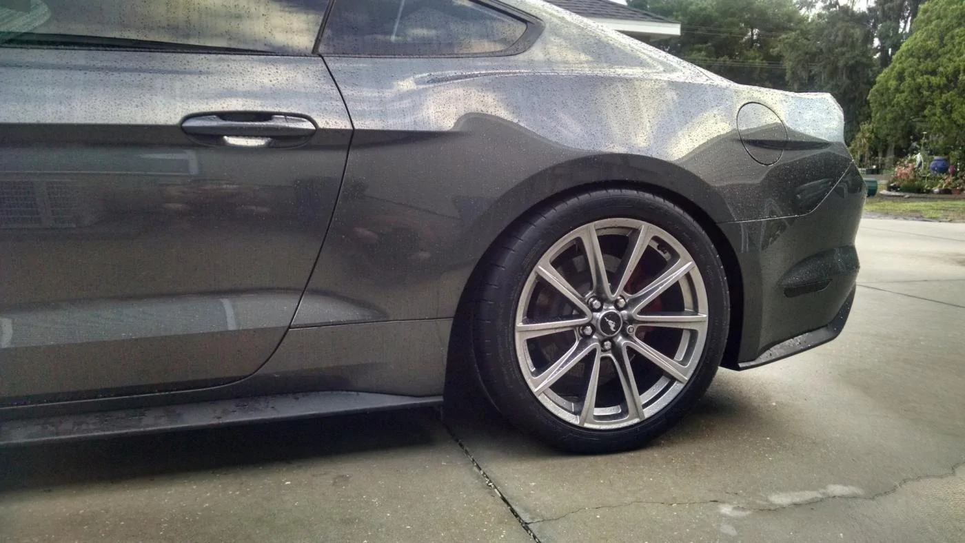

i don't particularly have much wheel gap now so i'm not sure how much it would add.
Maybe going with the Super sports is what i'll have to do then.

255/35 is a bit short 1/2" more wheel gap, 1/2" lower to the ground, and 1" too short overall diameter).
I'd look at a different tire which does come in the correct 255/40 size (like the Conti ExtremeContact Sport), if you're set on keeping those wheels.
Honestly tho, the 8.5" wheels are holding you back. With 10" wide wheels you could run the 285/35 MP4S.
