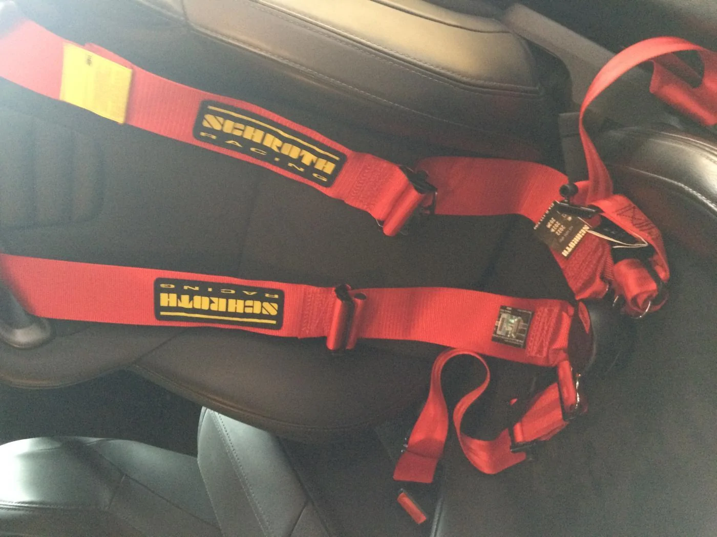

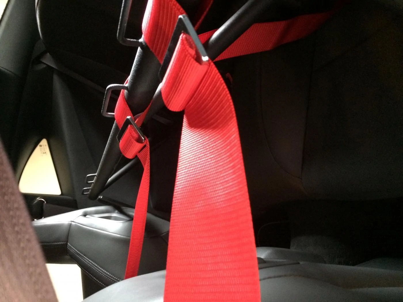

If you go 4 points I think the Brey Krause Harness bar and Schroth PROFI II - FE ASM
SCH-20070 4 point belts are your best bet. They are both FIA AND DOT approved and have anti submarine tech worked into them. Not as good as a cage, race seat and 6 pt system with Hans. But for HPDE to better hold you into your seat this is a reasonably priced option.
If you want the clip in clips you have to order them that way. The clips has a place for them to be safety wired so clip will not open. this allows easier in and out and the clip right onto the Brey Krause harness bar
Link BK Harness bar:http://www.bkauto.com/R_1180_Mustang_Harness_Mount_Bar_p/r-1180.htm
Link - Schroth: https://www.subesports.com/schroth/profi-ii-fe-asm/sch-20070
The Profi II-FE ASM is designed to be used as a four point system for street legal usage incorporating the required red push-button release design. For this reason it is perfect for use in Driver Education cars or any other application where stock seats are retained. A seat that was not originally desiged for use with a racing restraint should never be modified to accept an sub strap. The Profi II ASM incorporates Schroth's legendary ASM (Anti-SubMarining) technology that is the only thing like it on the market. ASM is an extra fold of material sewn into the inboard shoulder belt that elongates at a different rate than the outboard belt. This allows your upper torso to twist slightly. On the rebound phase, your torso is planted firmly back in the seat rather than allowed to slide under the lap belt. Features 3" polyester webbing at the shoulders and 2" polyester webbing at the lap belts, lightweight adjusters, and a push-button operated RFR rotary buckle. The 2" lap belt's notable feature is that it rides within the crest of the human pelvis where a 3" belt would rest on the edges. This allows you to get the belt up to an inch and a half tighter. That means the lap belt will be working earlier in the accident event because it gets loaded faster. It's also more comfortable and easier to adjust becuase there's less friction through the adjuster. The lap belt cofiguration is a pull-down adjustment with a sewn in bolt/in end. Dual or sigle substraps can be added to make it into a six or five point configuration. Shoulders come in 70" length. SFI 16.1, DOT, and FIA approved. Available in red, blue, black, and silver.

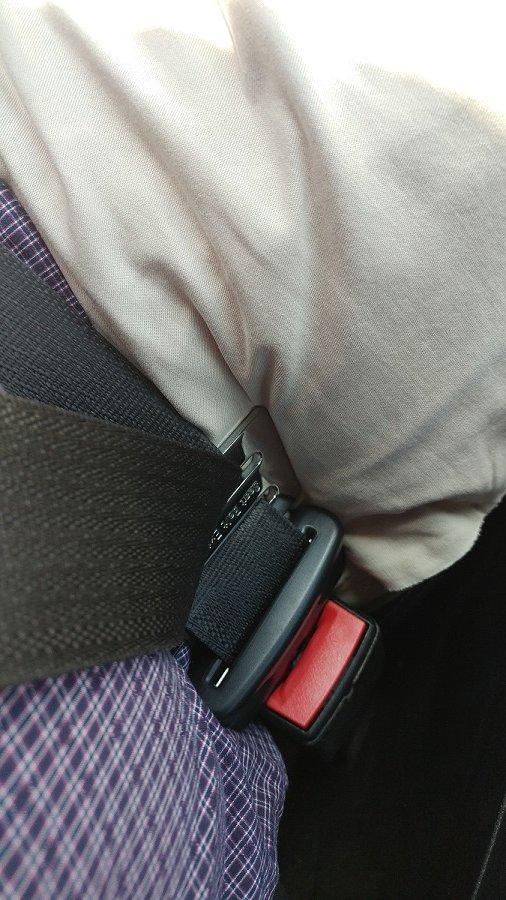

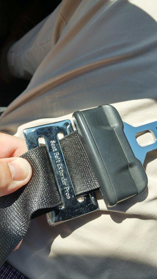

Use the seat belt locking clip I posted on the previous page instead of the fast pull. Achieves the same result as the CG Lock and costs $8.
[MENTION=29474]spiller[/MENTION] I'll take a picture today of how it looks installed, both unlatched and in the buckle (for this one you'll have to excuse my pudge lol).
See pics

[MENTION=10281]BmacIL[/MENTION] thanks for the pics. I can certainly now tell how it works and I'm eager to try it out. I have a feeling I have a couple of these lying around from the various child car seats we have for our daughter!
