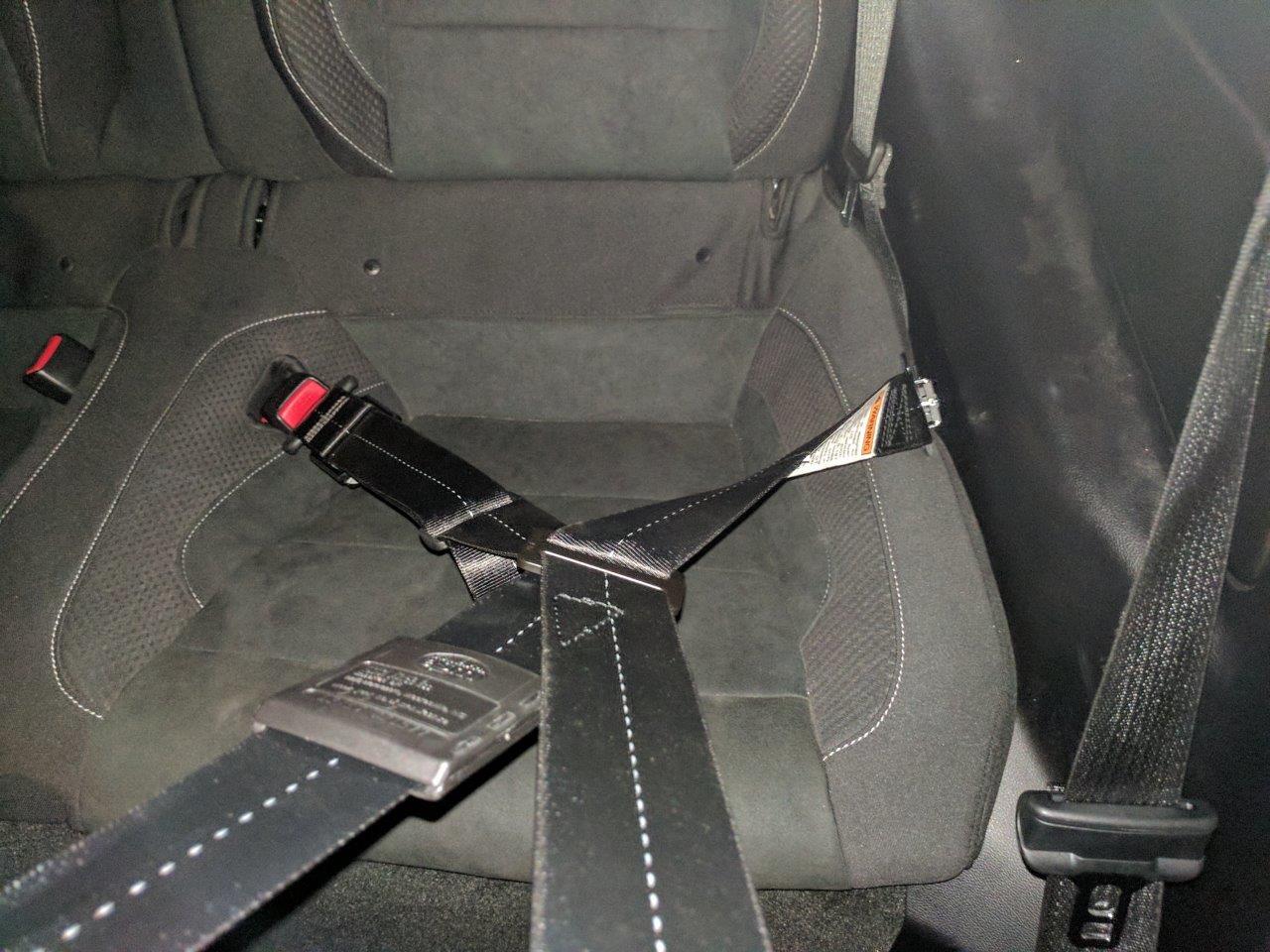

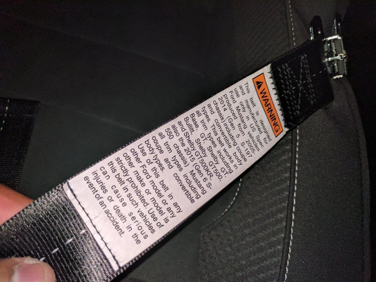

The Schroth 4 point per the call I just had is certified on the S550 mustang so they are good to go with Nasa.
I will confirm when i get the belt

Pro belt, The regular QF you cant use a Hans device. The tech said they are labeled to include mustangs through 2017.
Scrotch racing 4 point is FIA B-xxx.T/98 but then you need a bar per NASA
Per the rules below just being DOT isnt enough. Nasa also said this in a email
Did you specify the Quick Fit /QF Pro? I know the belts are FMVSS 209 in the S197's, but I don't have paperwork showing they have been certified on the S550. The belt itself shows the FMVSS 209 on the ASM cover, I just don't have anything other than that to prove it's just not a S197 belt in an S550, if that makes any sense.
I believe that is all that is needed to be legal in NASA for these belts, the FMVSS 209 cert.
https://nasa-assets.s3.amazonaws.com/document/document/282/2017.8.pdf

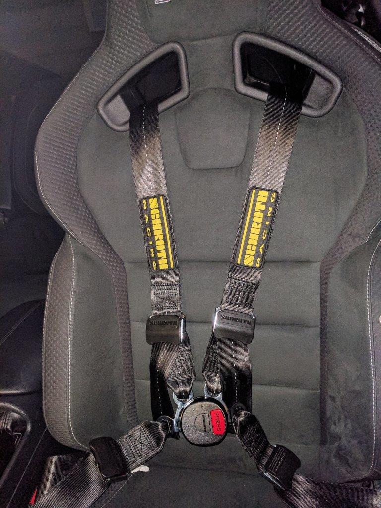

Looks great. I will have a set before my next track day.
Wonder if I should get one for passenger side (for instructor), too.

Has anybody used these for NASA HPDE events with success..?
Were they tech approved.? Pro only.?
I looking at the 4 point for my next trackday upgrade. Probably going to make a trip out to Schroth near Charlotte, NC for review and fitting in the not too distant future.
