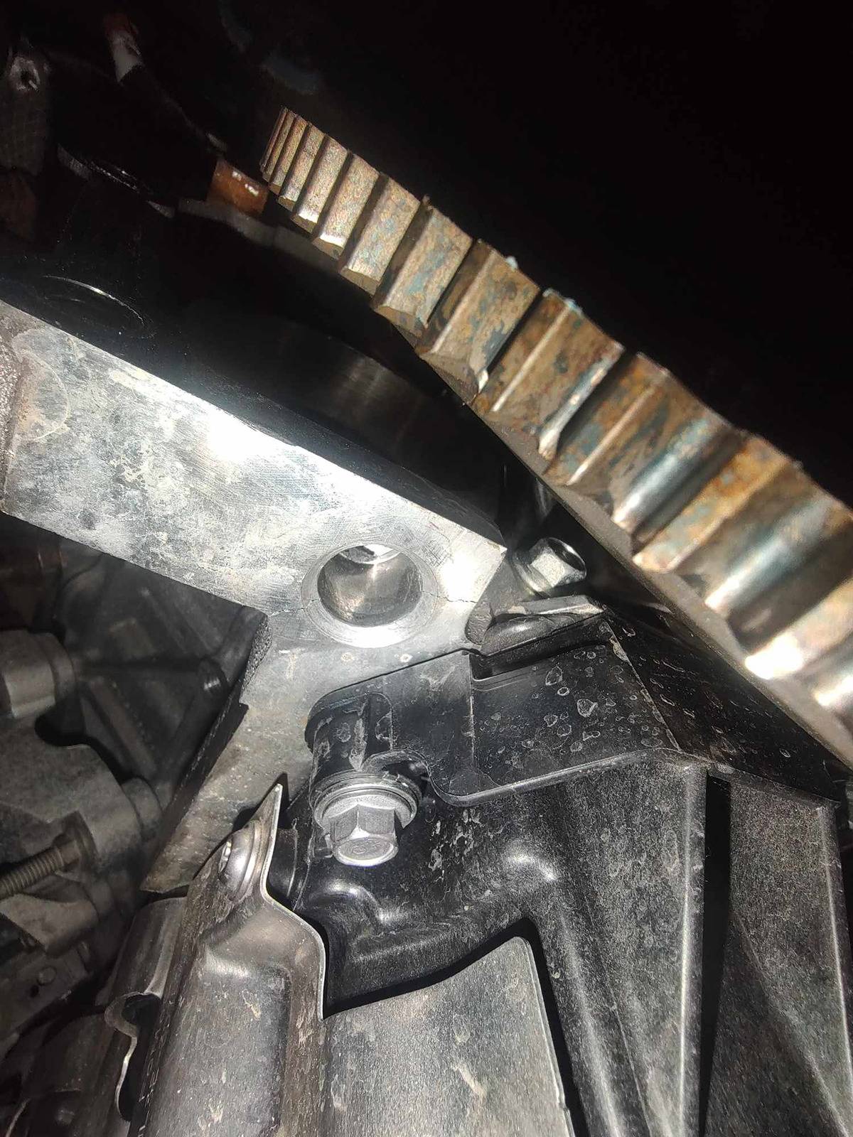

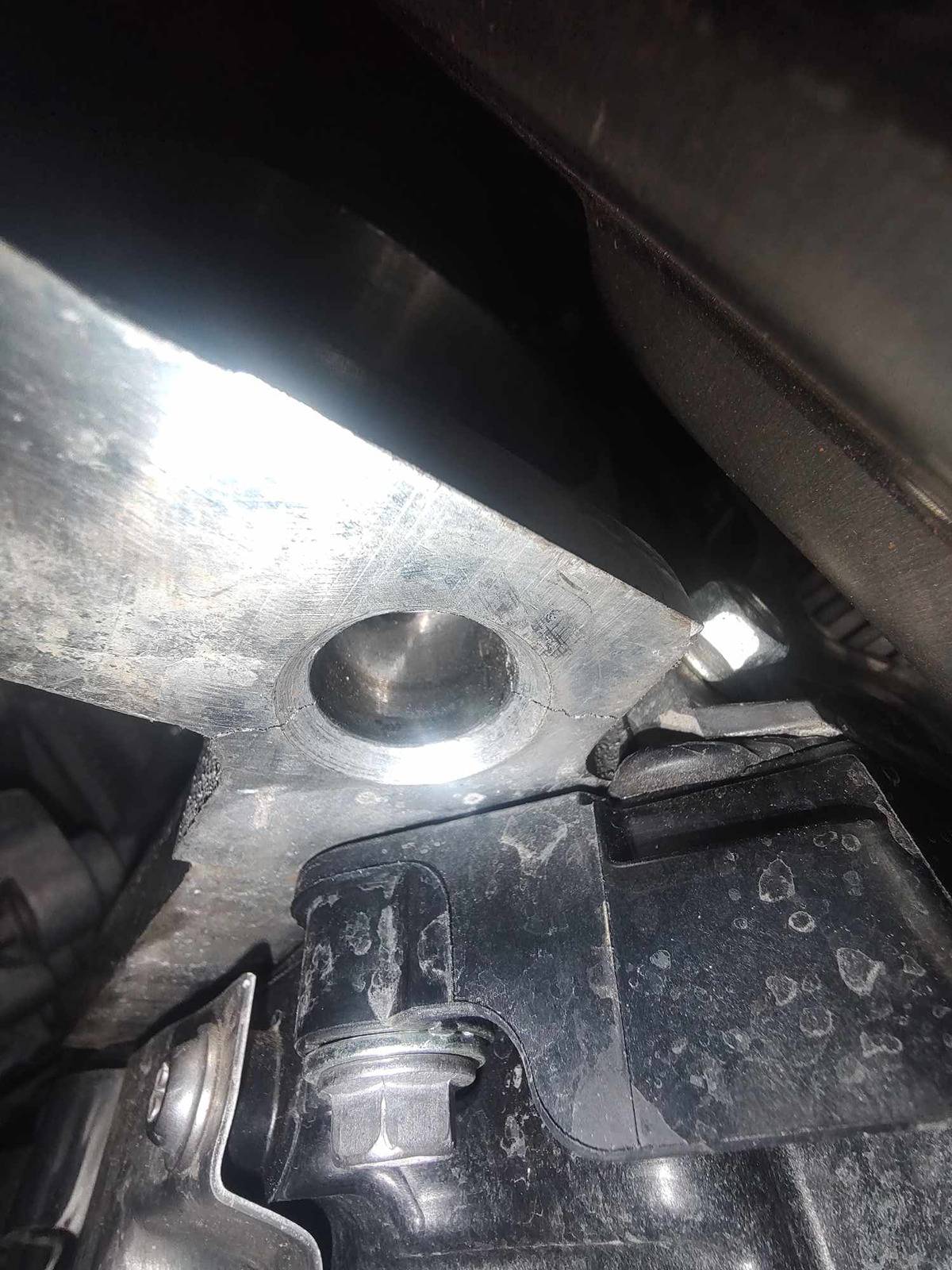

Circle D converter is not going on. Shop messaged me. Bellhousing is cracked on housing lug. Car is not driven hard or dogged on at all. Anyone else experienced or heard of this? If Ford doesn't fix under warranty best place order new 1 from?

Thanks. Just forwarded to shop thats working on my car
One other thing to note. Those cracks are in the engine block, not the transmission bellhousing. The only fix is to replace the engine, or maybe someone could weld the cracks shut.
What shop said. Replace shortblock is only fix

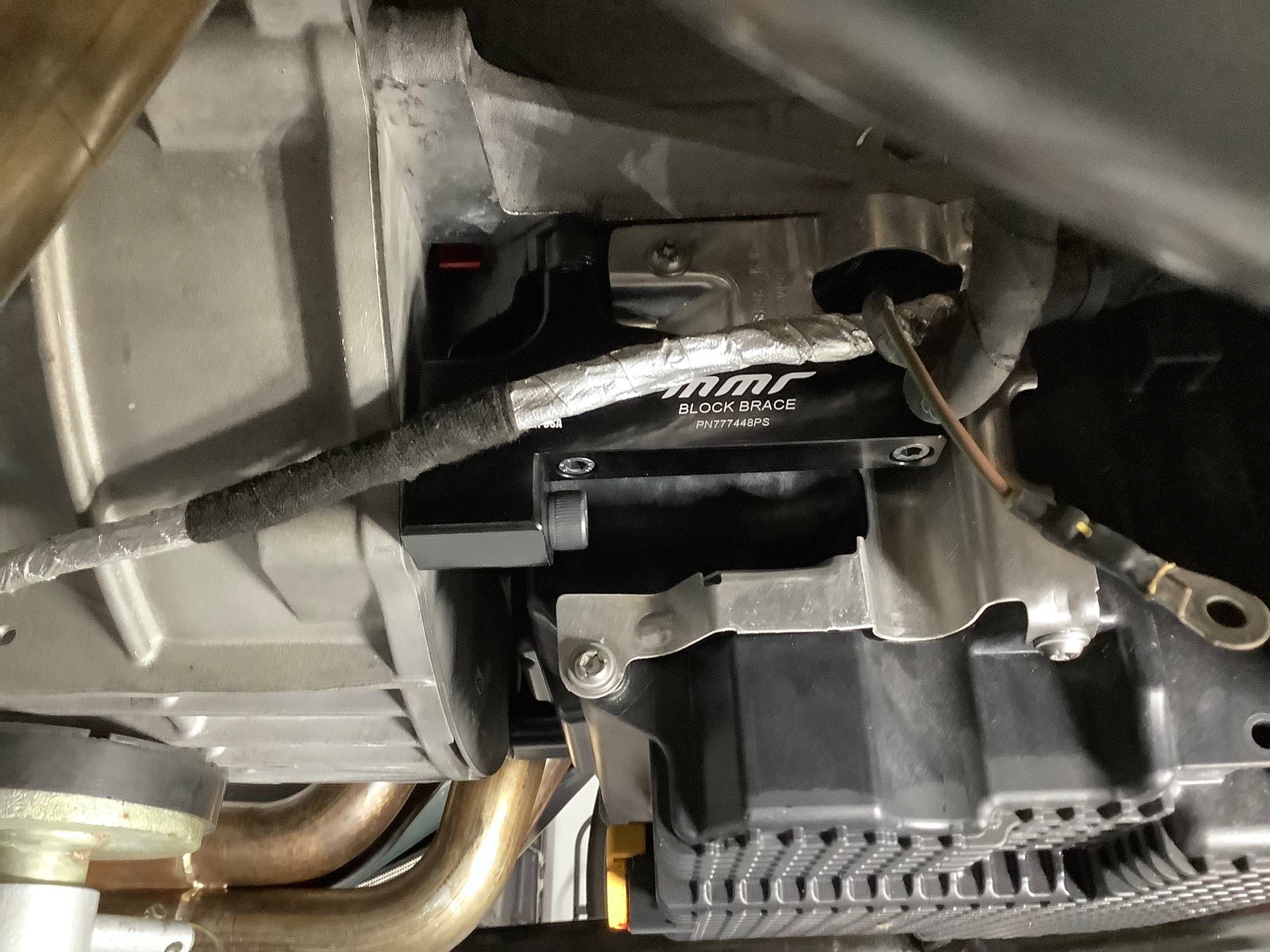

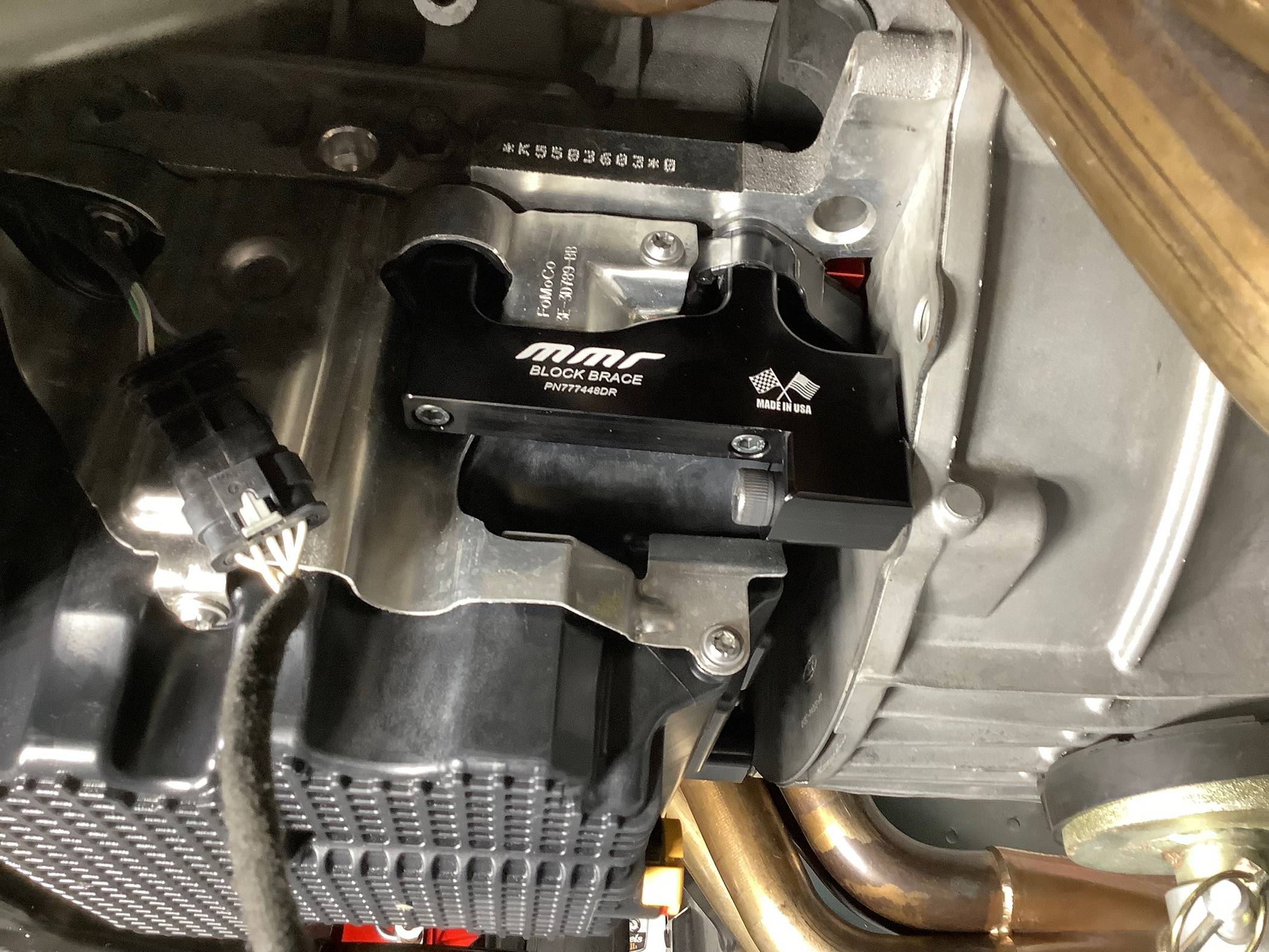

Find a local shop or metal fabricator that does TIG welding and have them weld the cracks shut before you put the MMR block brace on

That oil pan will also need to come down before welding, as there will be lots of heat generated when stitching up the crack.
I wish I knew what was causing these GT blocks to crack, especially on a 2022. It seems like it’s caused by the same issue as the GT350, harmonics and vibration. I also wonder if this problem is more prevalent in auto tranny cars than manuals when it comes to the GT?
I got lucky and was able to install the MMR braces (14 months ago) before a crack developed on my 2019.
