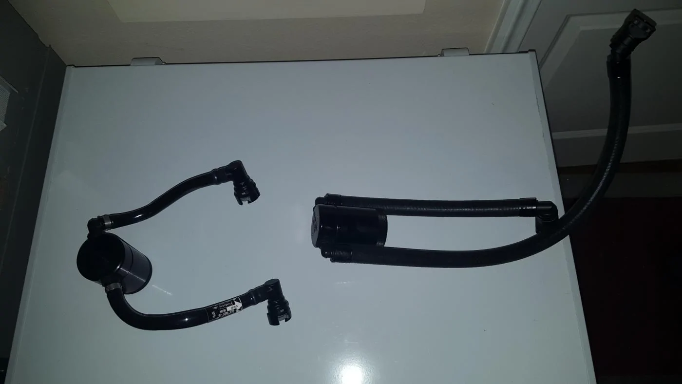

I would argue the new JLTs, what they call version 3, are as good as the Bobs, and I like the fact that the bottom of the cans simply unscrew so I can bring the cans to dump in my waste oil drain pan and not have to use a valve to drain them while on the car into some container, then transfer again to my storage pan. With the coupon code above and free shipping, significantly cheaper than Bobs.

Overriding factors for me is how the catch cans function and which is more efficient in catching oil. Bob's to me is best. Both sides have a true catch can which have material and internal baffling to catch atomized oil or vapor. UPR driver's side does not (check valve only) and FP have no baffling whatsoever plus no drains. To each his own but for me the choice was clear.

The JTL 3.0 units do look nice. I noticed however on their site the Driver Side is on back order. I sent an email to inquire about when they will be available again.
I don't think they're baffled tho.
