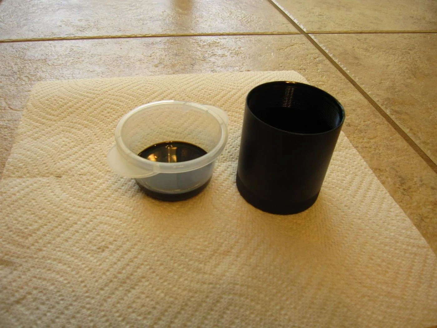

It works on my ecoboost, get about 2 tablespoons of oil every 2000 miles.

I'll never run an engine without one. Even if all it did was stop my Ecoboost from smoking at idle, its worth it.

well time for my .02. personally i drive mine very lightly, sometimes not even enough to really get warmed up to the point water vapors are removed. I have a catch can on mine & it collects the water that would have gone right back to the oil pan. Ask me how i know this? well I had a 12 mustang & it didnt have CC & on my first oil change my oil was milky grey. Hmm havent had that issue since & the water dumped out of the CC is always milky grey.
you do the math.
im all in for a CC

Its not bad to be skeptical, the GM engineer has a point that a lot of people pushing catch cans happen to be catch can salesmen. But for me, I can see the results of running one, and even if overall it isn't a huge impact it gives me a little peace of mind that the collected stuff isn't going in the engine.
