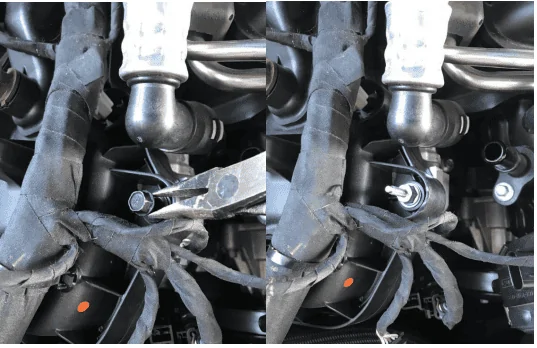

I installed this very early on, the bracket attaches to the cam cover bolt, its a difficult bolt to get off, you need to give it a good pull to get it to release. Be sure to use a torque wrench when tightening it back to spec.
