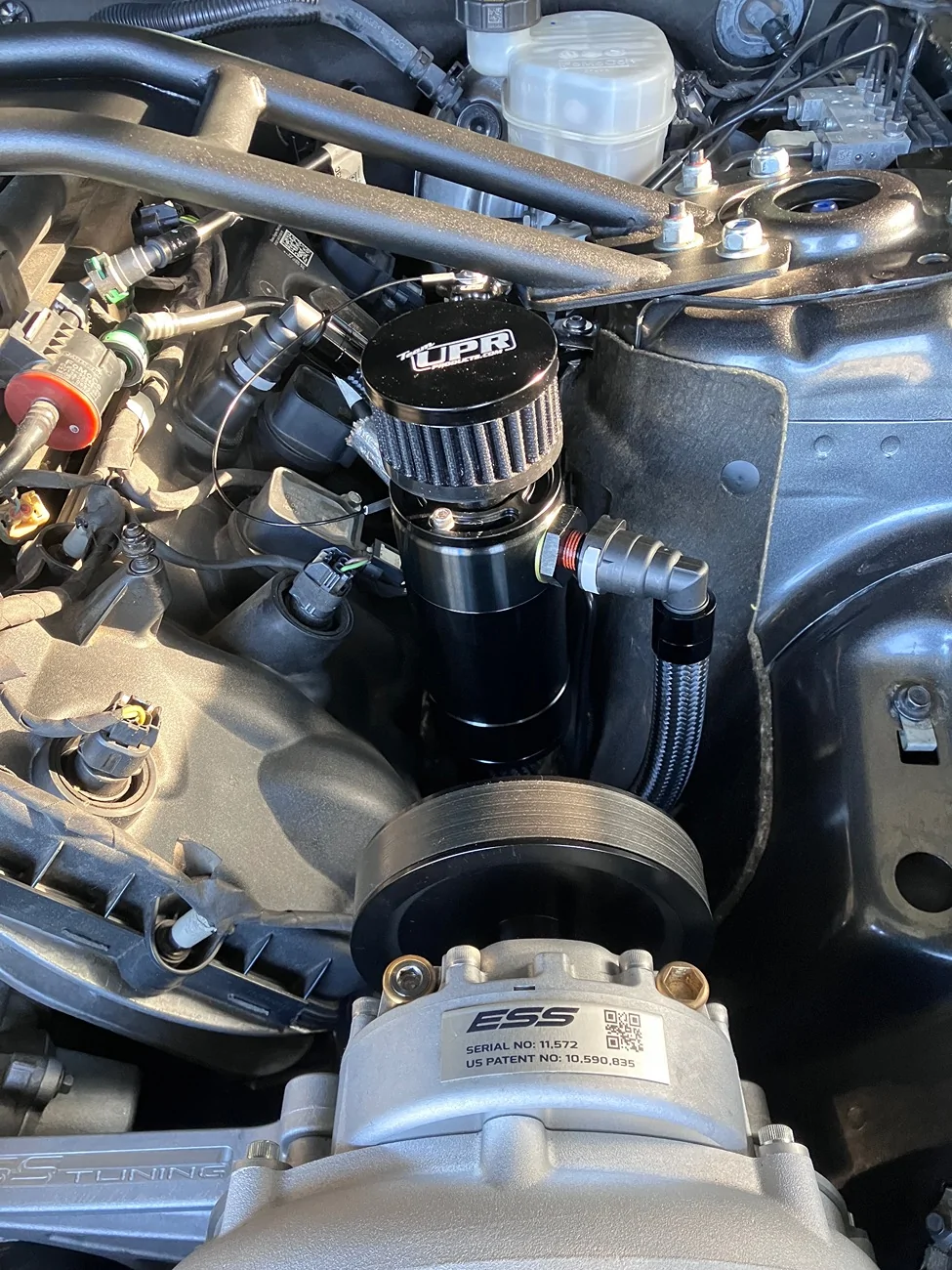

I went for the UPR Dual Valve Catch Can part number: 5030-146-1-css. Everything needed to install on ESS is provided in this kit. It does not vent to atmosphere and therefore no smell.

I lied I also needed a Dayco 80653 Plastic Connector. This is a straight through connector to attached hose from catch can to the intake tube hose to SC.

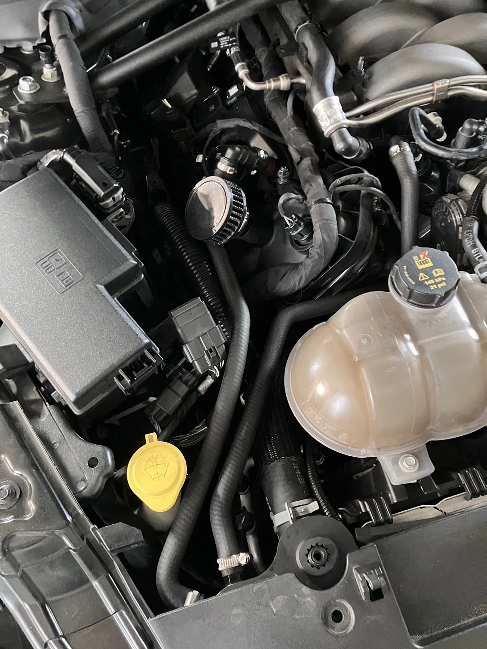

I use the FPP cans on my GT350R. Get about a spoonful in the passenger side after a day at the track. Have yet to see any in the one on driver side. Easy to install, nothing extra needed.

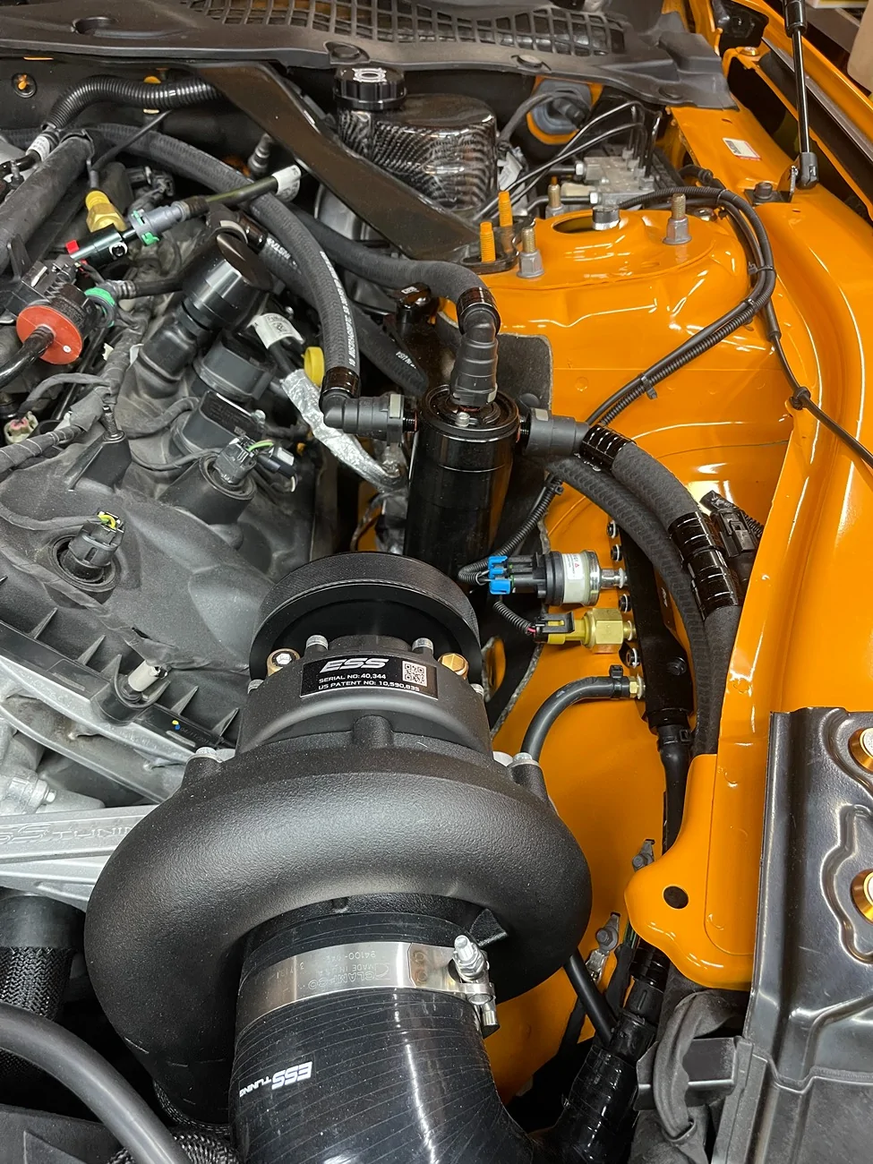

I went with the UPR dual catch can. It's literally a 5 minute install and does both side.
