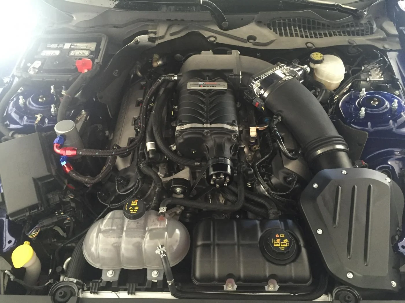

What is the recomendation for catch cans on a tvs equipped gt these days
Any particular one working or designed to work with this
Blower system

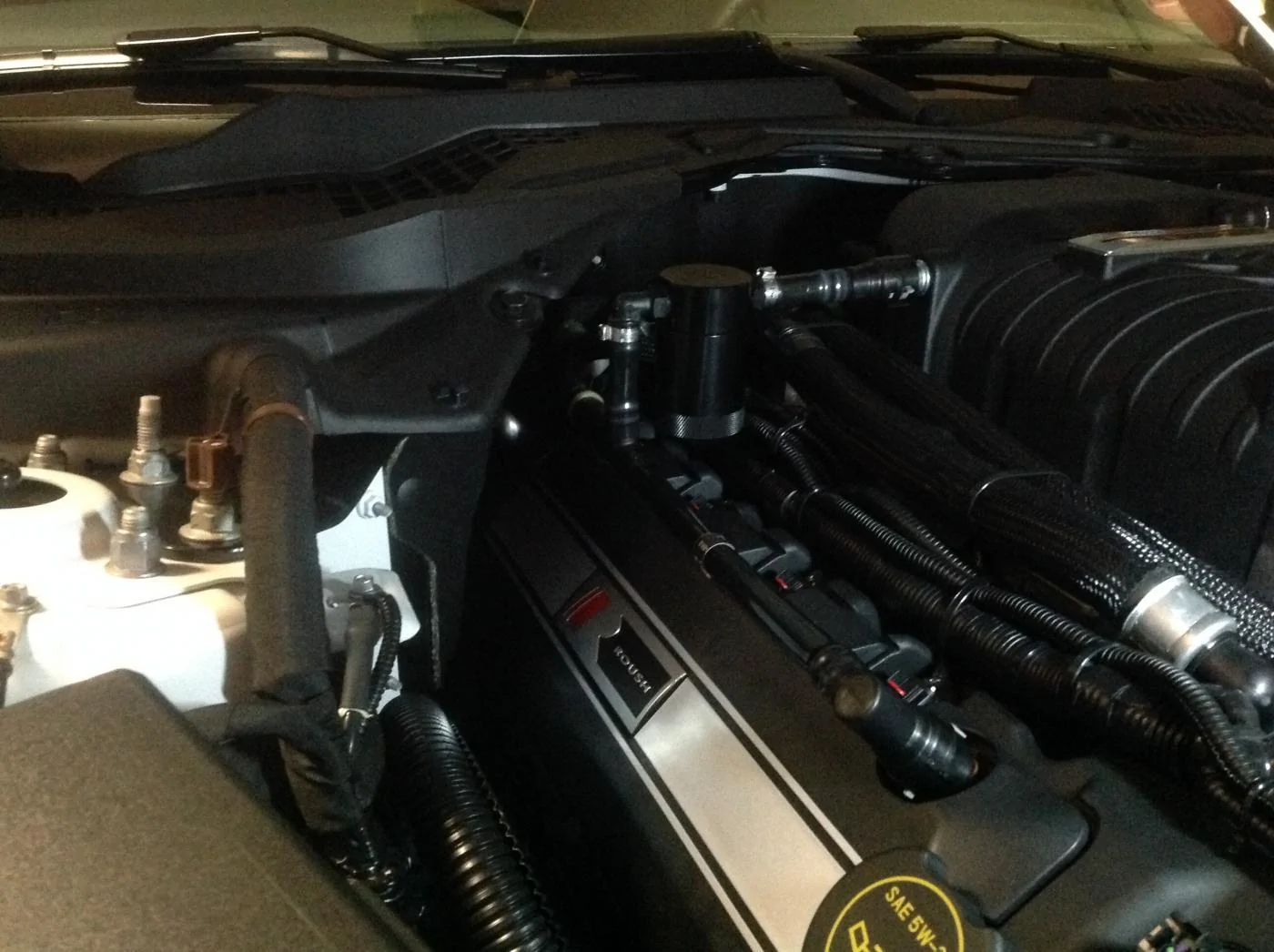

The UPR Single Valve Catch Can with Clean Side Separator will catch and hold more oil than anyone else out there. Many people have seen 4+ ounces being catched which would overflow others.
Our chambered design allows a perfect airflow. The Clean Side will catch any oil splashing back into the intake tube and actually separator the air from the oil. We also include a check valve which will actually seal at WOT / BOOST. With the quick connect fittings and braided line, it will give you an OEM fit and clean look.

Same question. Where is pcv from the rear of the supercharger? Am I missing something?

Our system will block off the line from the back of the blower. It's only there for emissions reasons. Has no vacuum.
Oh ok, thanks. The JLT can I have now seems quite insufficient after seeing the upr and bobs. Will be doing some research for new one. But I do only drive on the weekends so maybe it works cause of the low miles I put on it.

Catch cans will pick up more with more use and RPM but even on weekend only driving, it can still pick up oil The filtration is the key to a proper setup. If you use a thin cheap screen and honeycomb filter as your filter, the clean side will be just as bad as the dirty side of the can. That is the reason our cans have a chambered style system. it is also why we use our 5030 model which is larger and has a larger capacity.
Put it this way.. Here is my 2015 N/A Mustang after driving about 2500miles. No racing.
[ame]
That's 4 solid ounces of oil and fuel mixture. This will overflow any other system.
