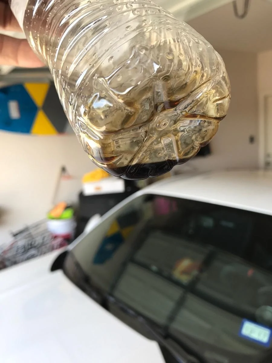

Yeah the UPR is really a great setup and I haven't heard anyone complain about it that has it. It is a little costly but you can't deny the quality and function. I think it's also the only one currently that is 'designed' for the Whipple. After about 5000 miles of daily driven and aggressive road course track runs (about 1 a month) I take out a little less than a 1/4 cans worth of blow by. When it comes down to it, keeping blow by oil out of the intake is a huge thing for us Whipple guys because it prevents intake contamination and octane degrading.

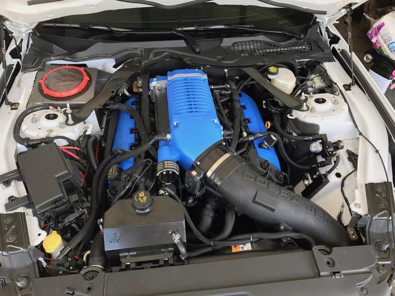

:threadjacked: Can we get more Cobra Jet intake pics?
I need to move the Whipple intake box as it is killing flow out from behind the radiator. New thread?

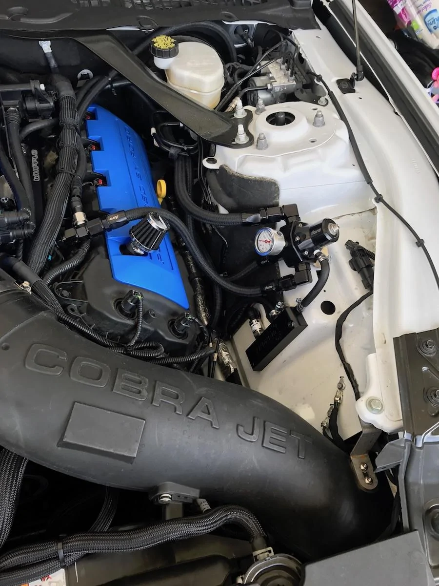

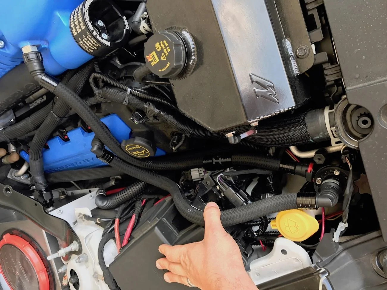

Running UPR Whipple (before 45degree fitting and no powder coat) and tracking.
Did not use the heavy bolt and standoff as I needed room for trans cooler lines relocated for cooler in fender (flow from below turn signal). I made a much lighter bracket out of a strip of Aluminum that uses the existing bolt at one side as other side slots securely into the weld seam gap.
